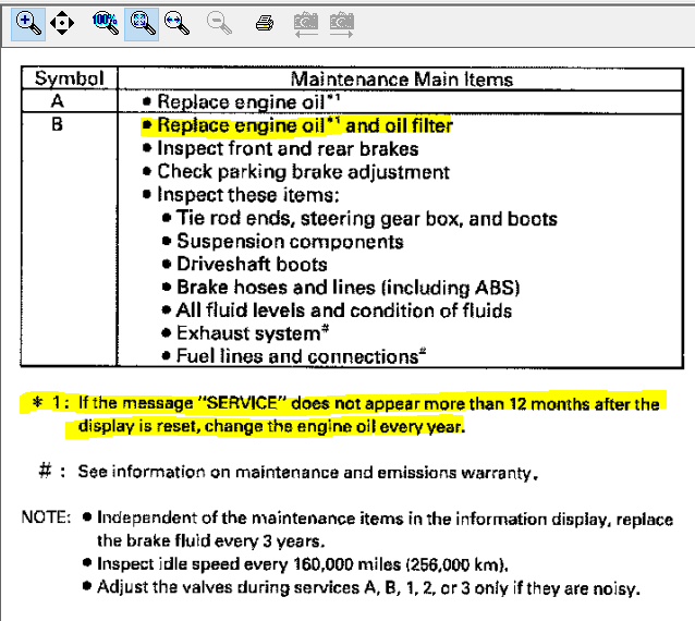

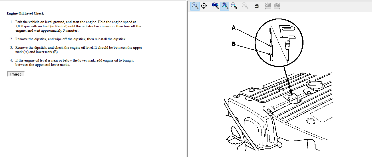

Yes if the color is dark it is good to change engine oil and filter every year even oil life is 70%. oil can be mixed with humidity over time that oil looses its additives. check fig 1.

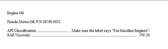

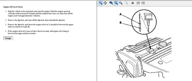

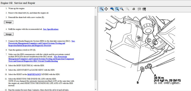

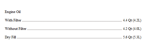

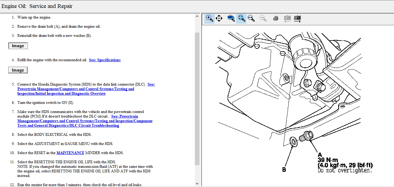

fig 2, 3 is for oil quantity and the oil type, fig 4 for oil level check, fig 5 for procedure oil change.
