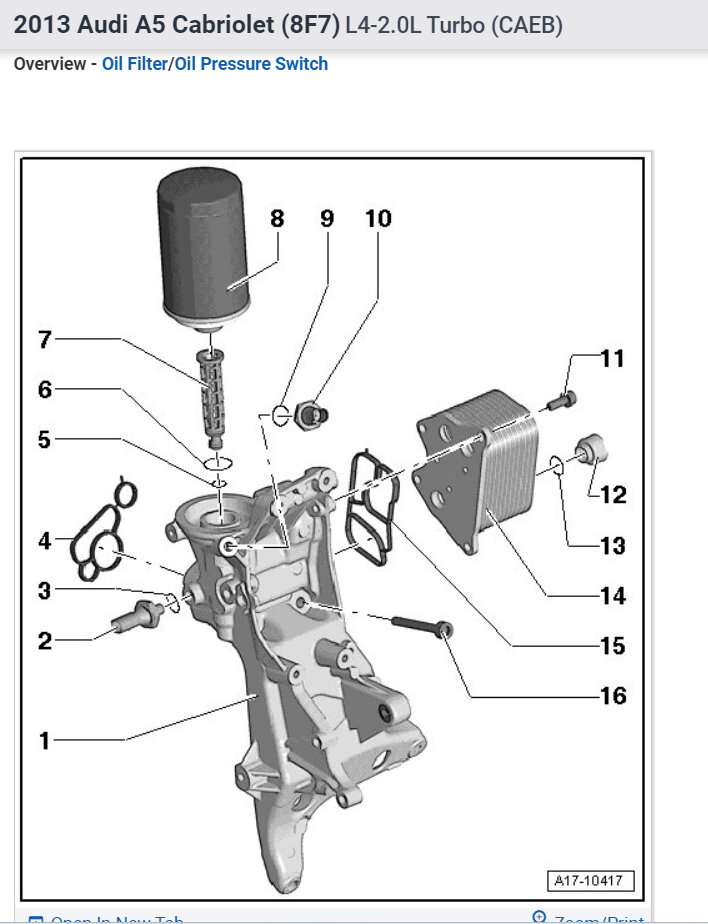

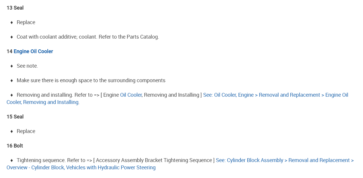

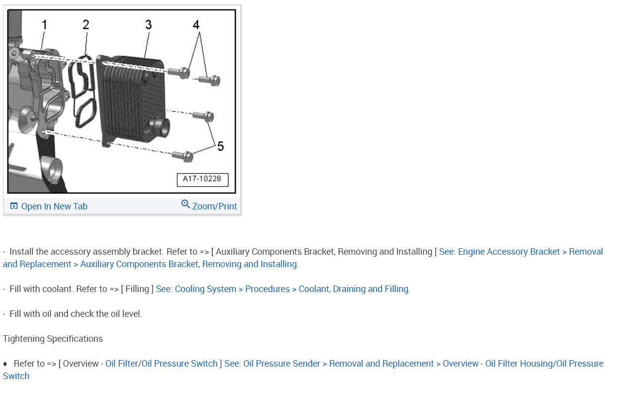

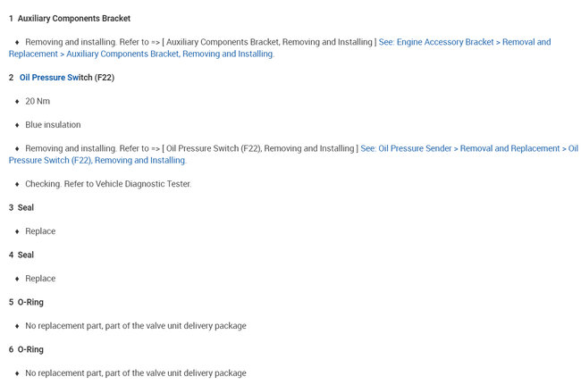

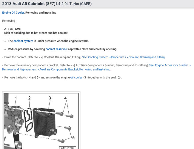

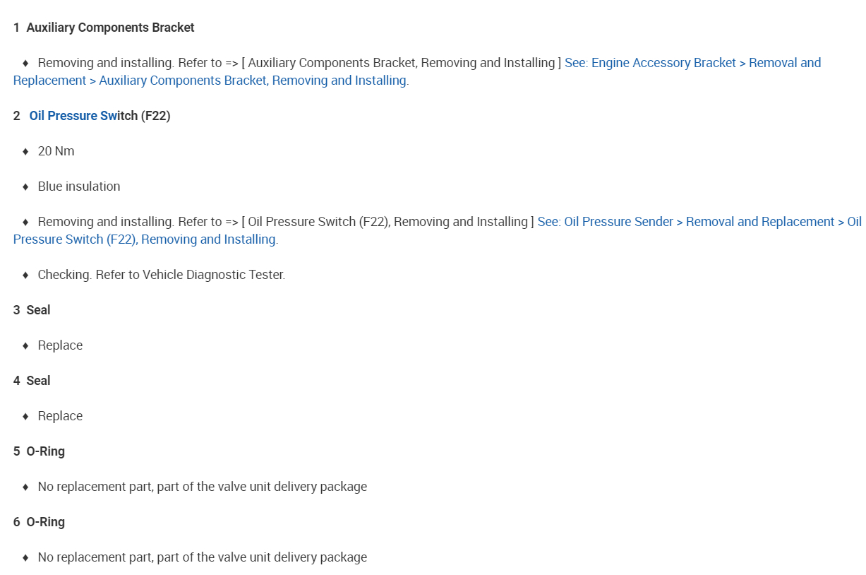

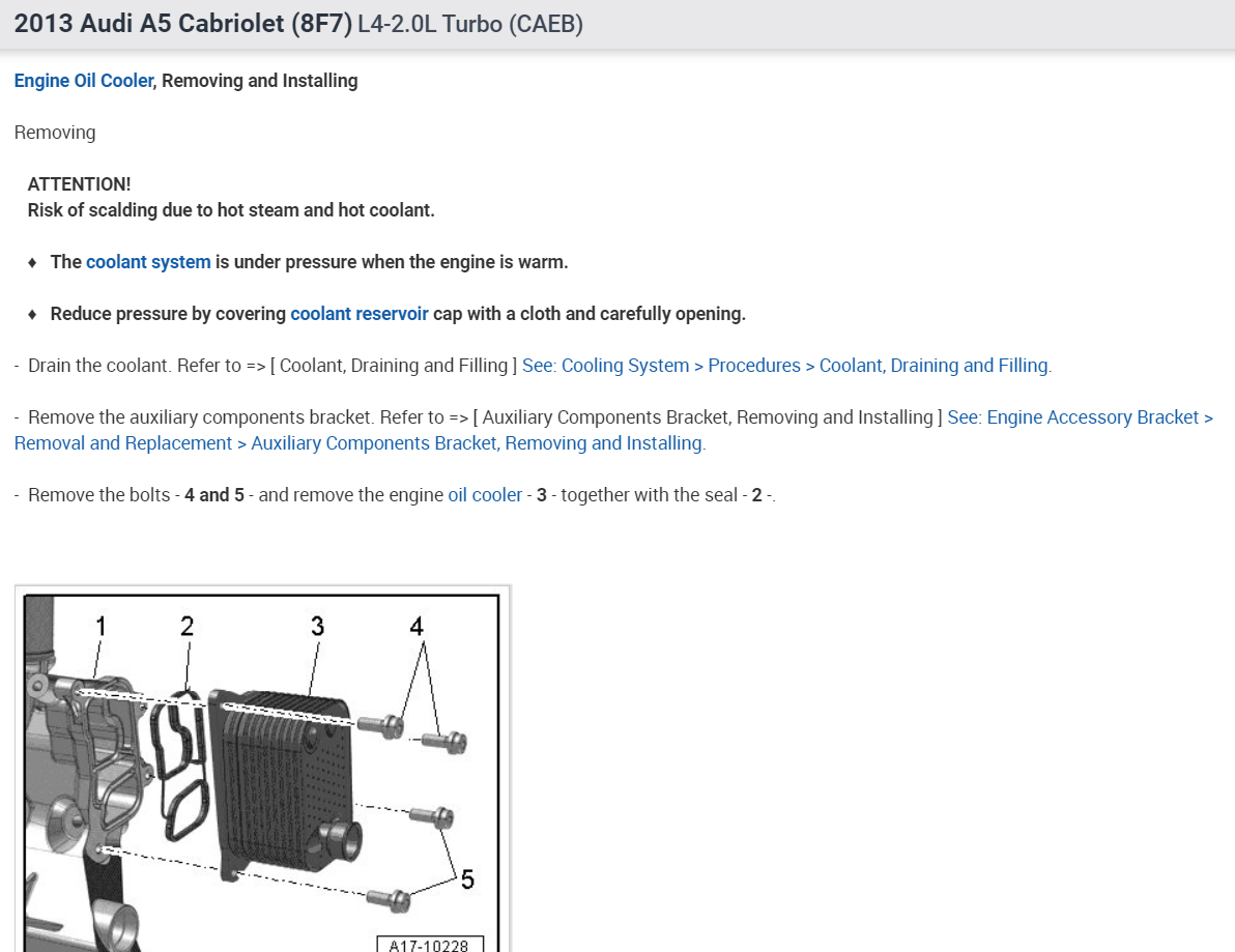

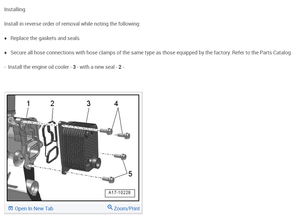

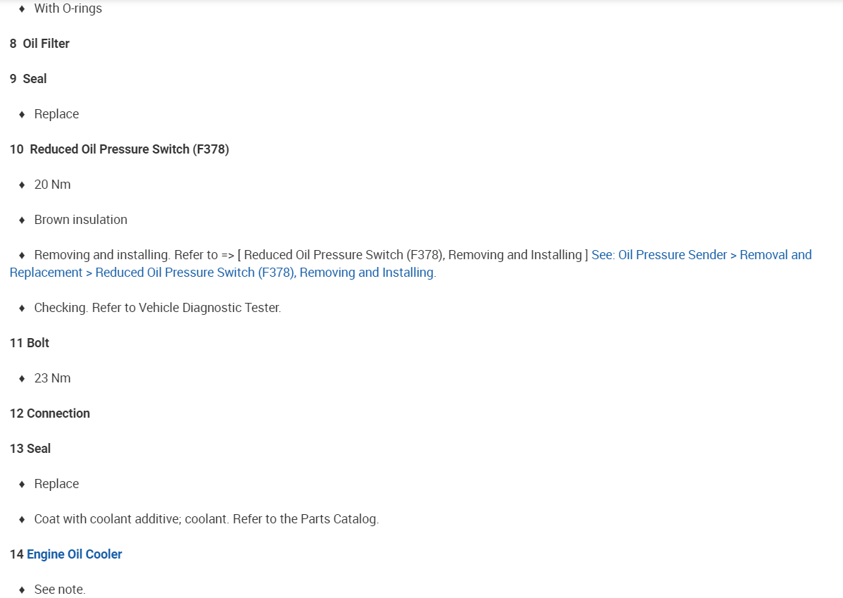

I am not sure what you mean by oil catch can? The oil filter adapter? oil cooler? here is how to change them both out in case this is what you meant. Check out the images (below). Let us know what happens and please upload pictures or videos of the problem so we can see what's going on.
Aug 22, 2023 at 1:19 PM
