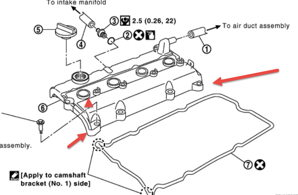

I seem to have a oil leak. Oil appears on top of the engine as well as into the car. There are no misfires over heating or smoke.
Oil does not appear on the ground. There is no debris in the oil after an oil change .
We are burning through a ton.
Not sure whats causing the problem.
Jul 17, 2017 at 5:47 AM
HMAC300
  • 48,601 POSTS

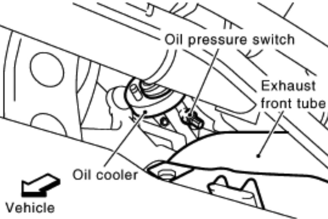

check around seal in picture as well as top as they may be old and leaking. Also, check oil pressure switch it may be on block. we have no picture of it or location .it could be leaking and blowing on top of engine.
