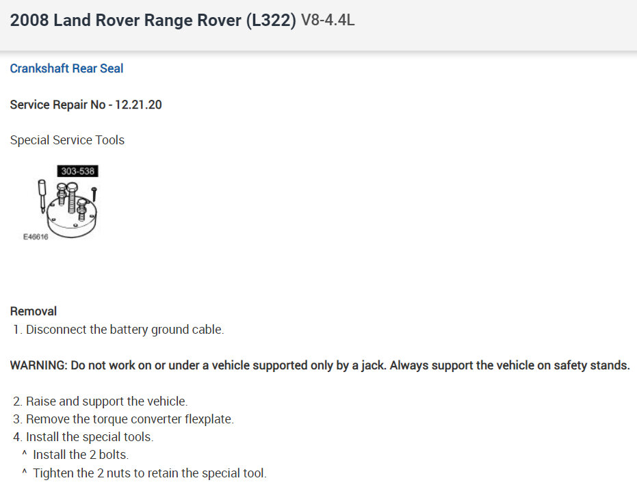

Back rear main engine oil seal leak (V8).

If the rear engine seal leaks it needs to be replaced.

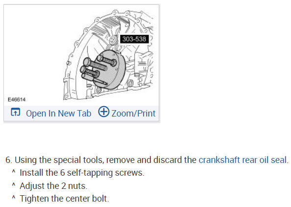

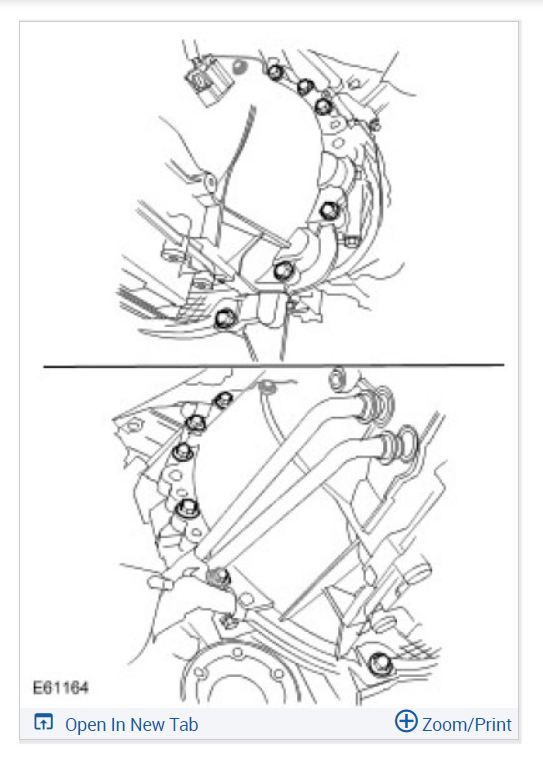

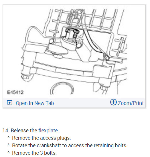

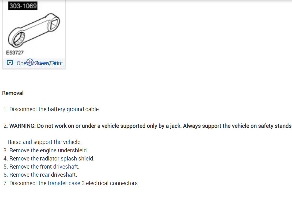

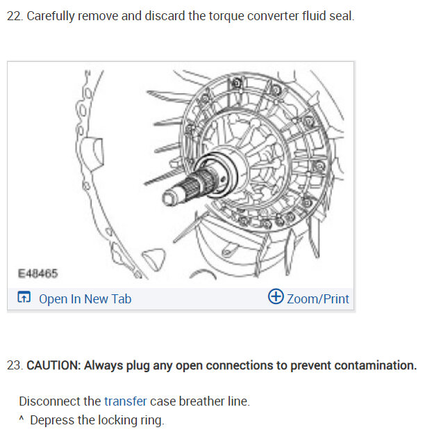

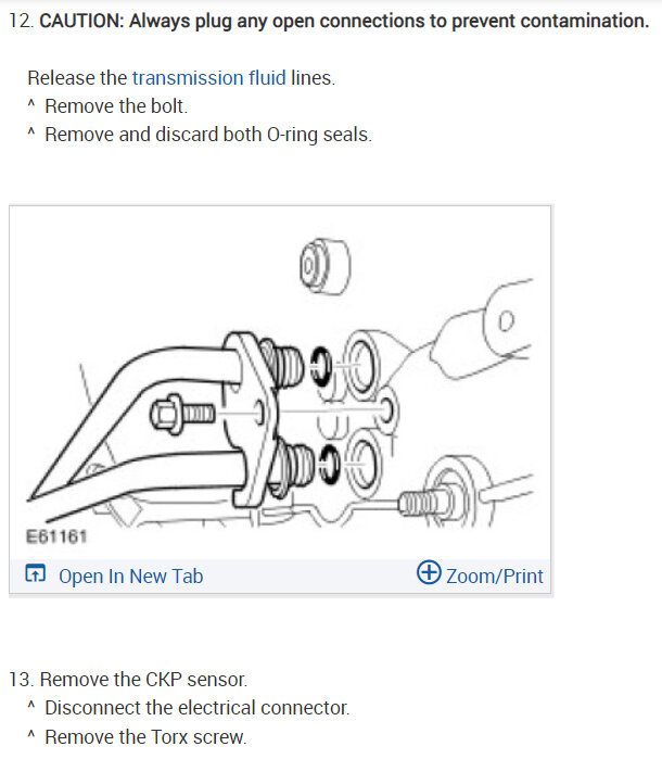

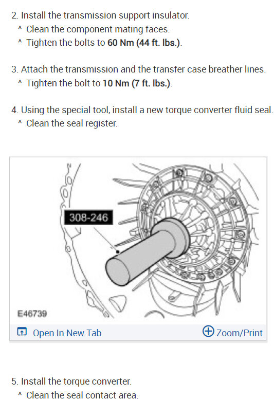

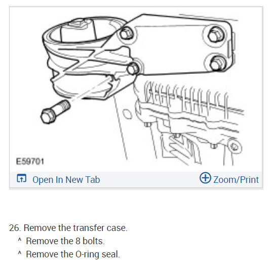

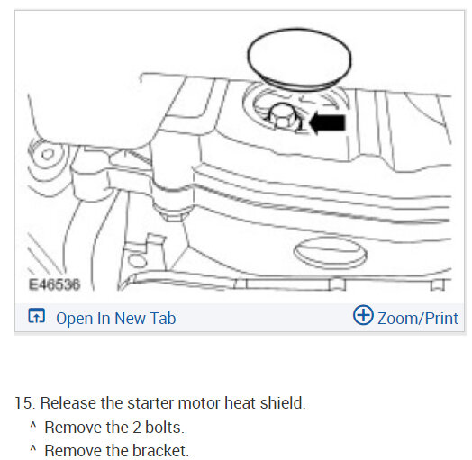

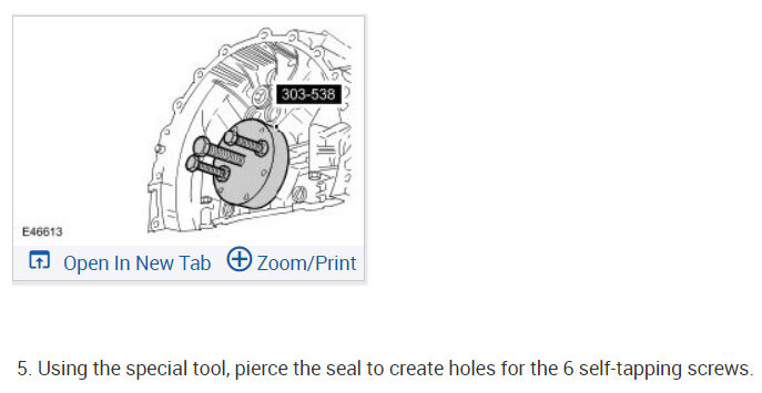

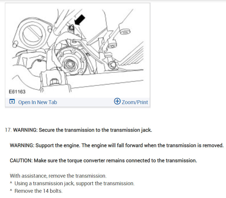

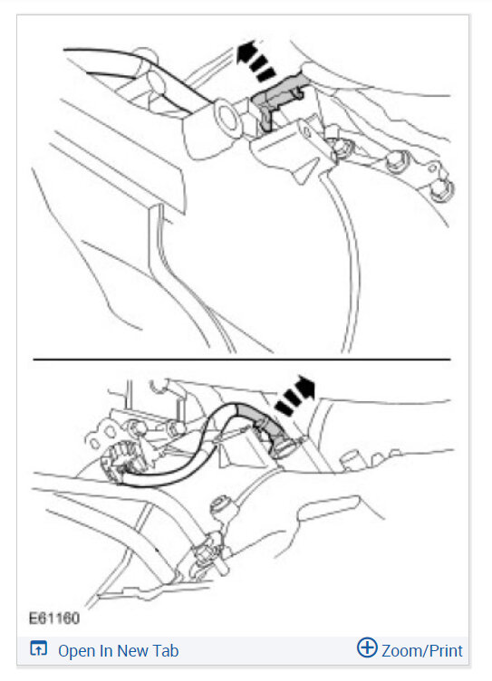

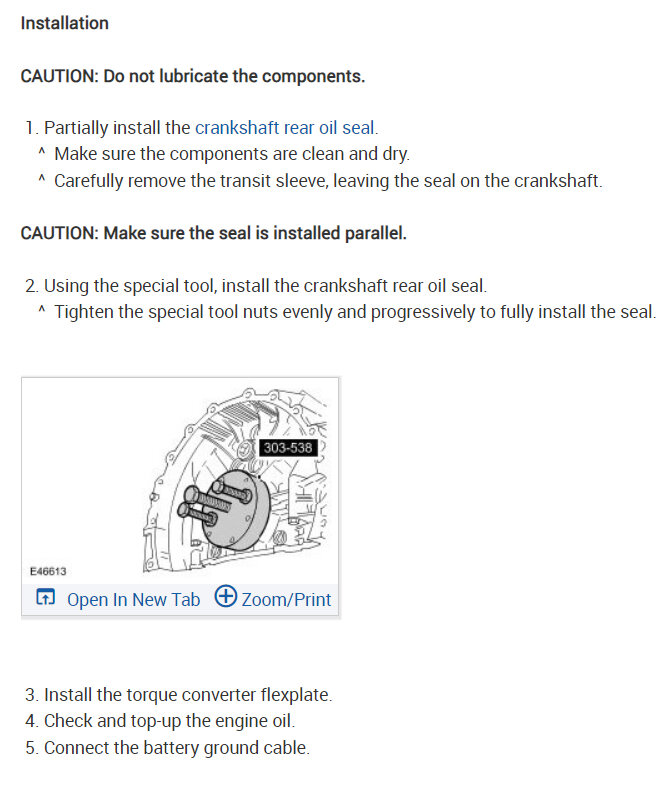

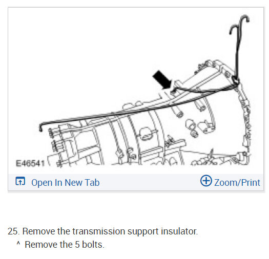

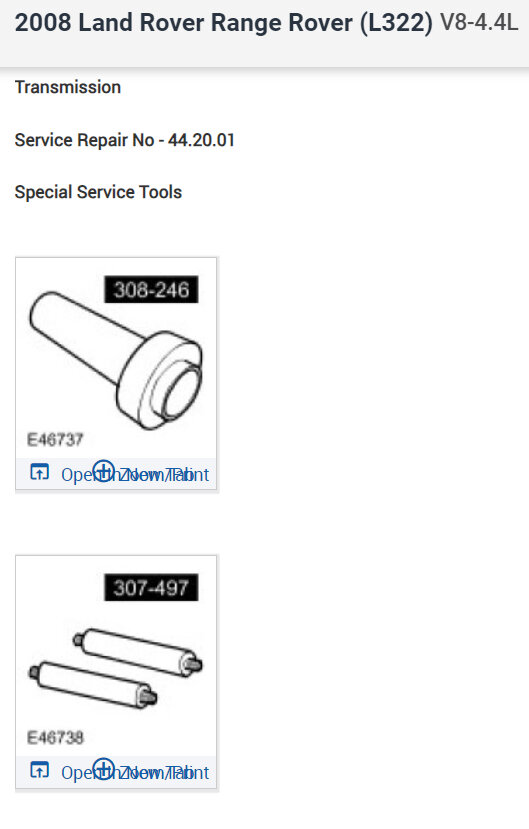

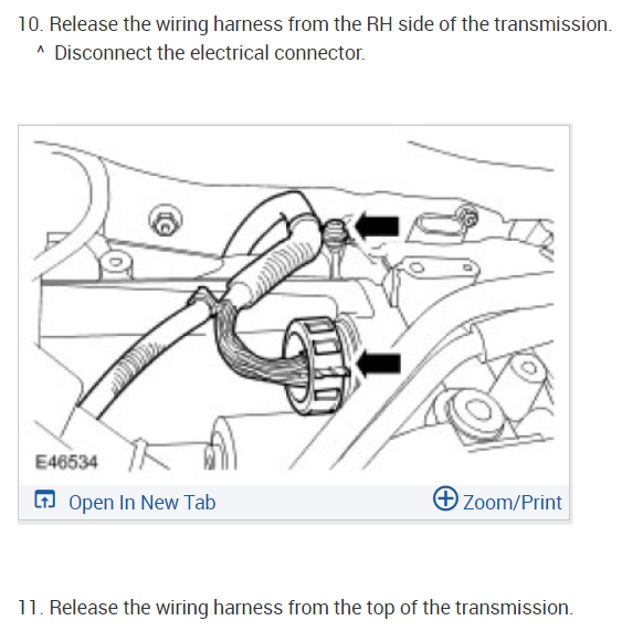

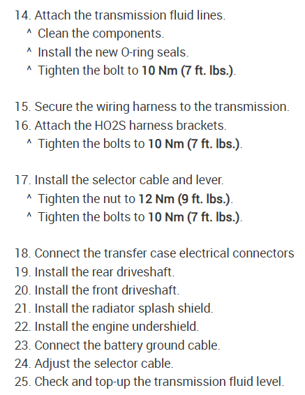

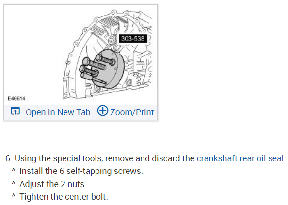

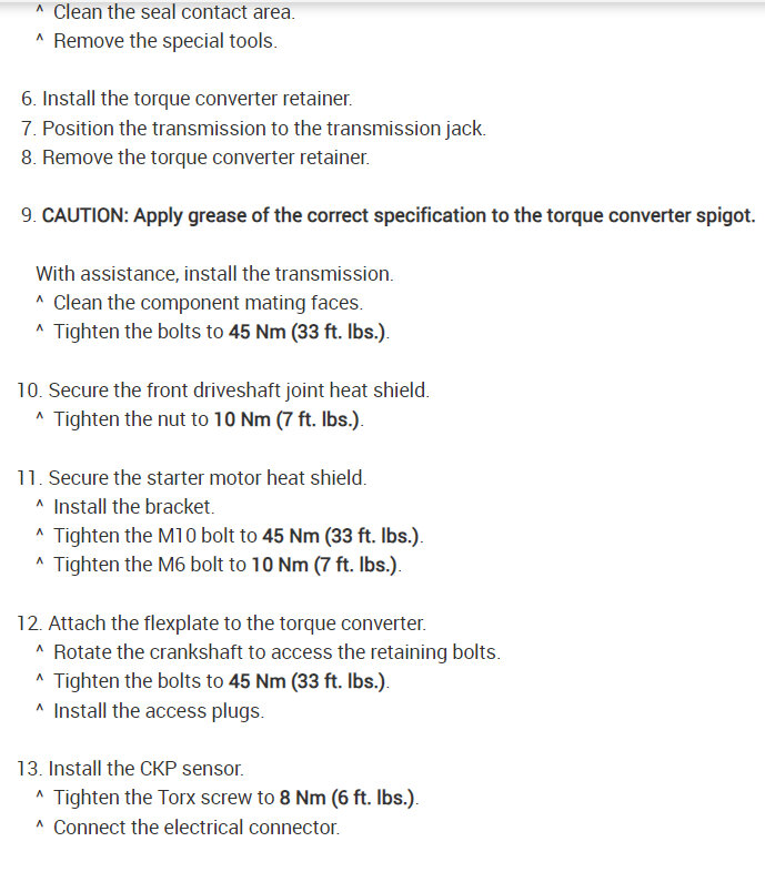

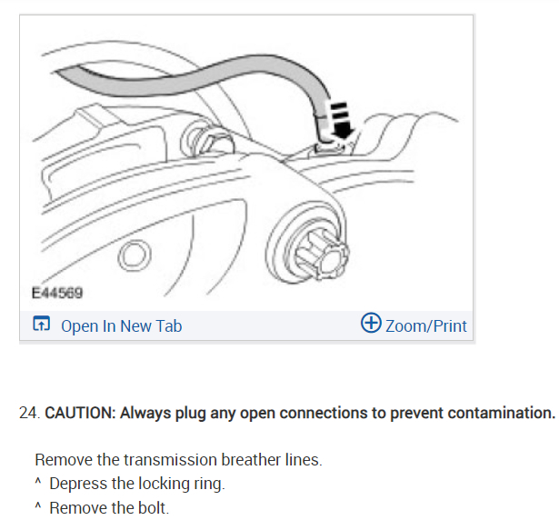

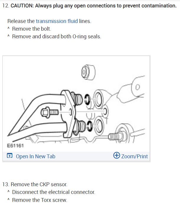

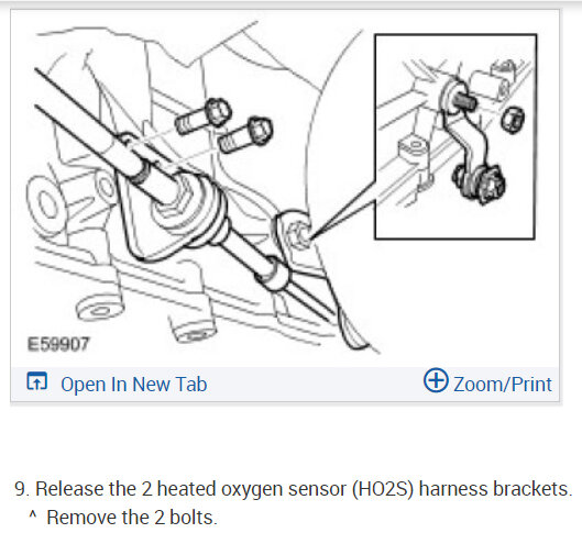

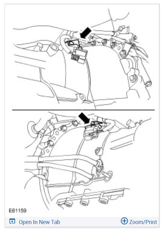

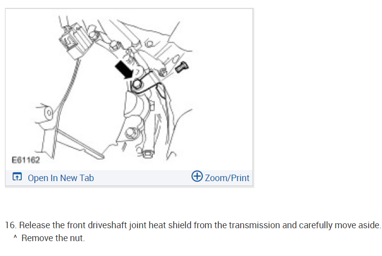

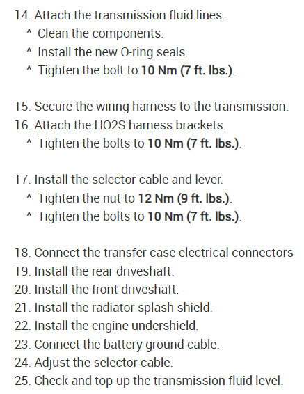

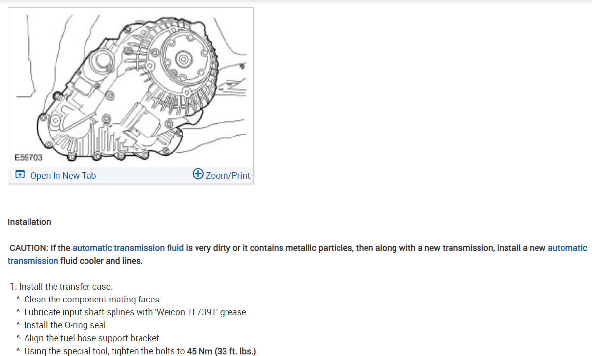

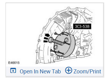

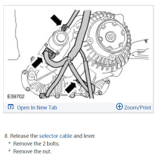

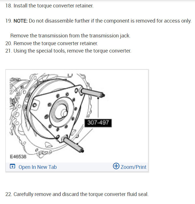

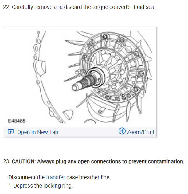

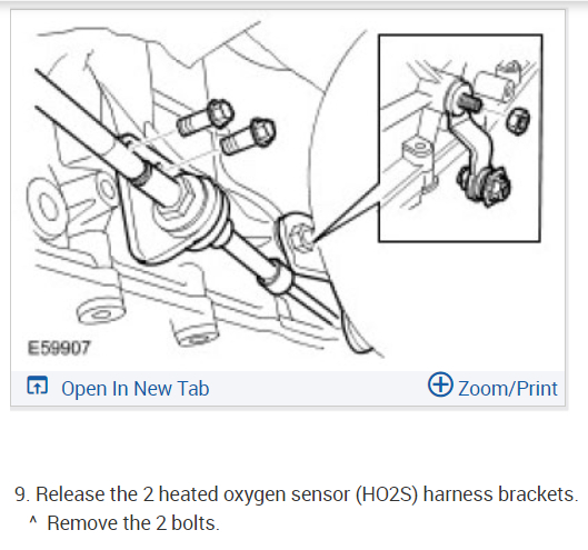

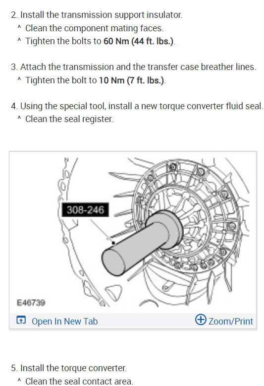

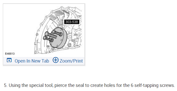

Here is how to do the job so you can see what needs to be done to fix the problem. MECHTRIX is correct that you need to remove the transmission to do the job which I have included as well so you can see what you are paying for. Check out the images (below). Let us know if you need anything else.
