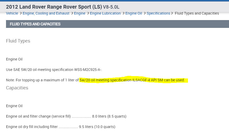

I've been using reg gas, found out not to, now back on track but still hear knocking. Please educate me about lifters.
also, what oil to use and where to get it? The book says only one kind only! Could that be the prob?
