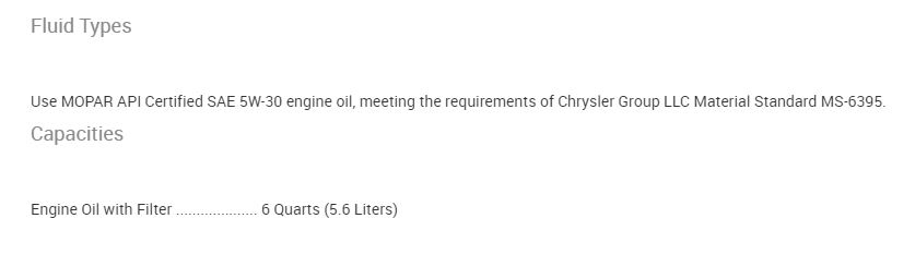

Good evening,
I attached the oil required for your car.
Fluid Types
Use MOPAR API Certified SAE 5W-20 engine oil, meeting the requirements of Chrysler Group LLC Material Standard MS-6395.
Capacities
Engine Oil with Filter .................... 7 Quarts (6.6 Liters)
