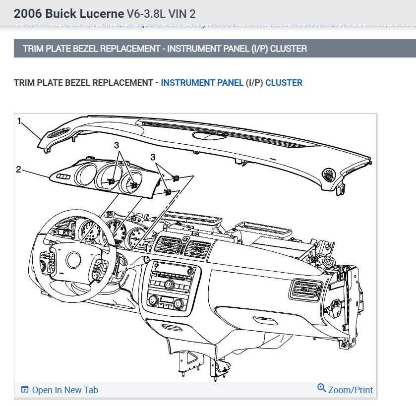

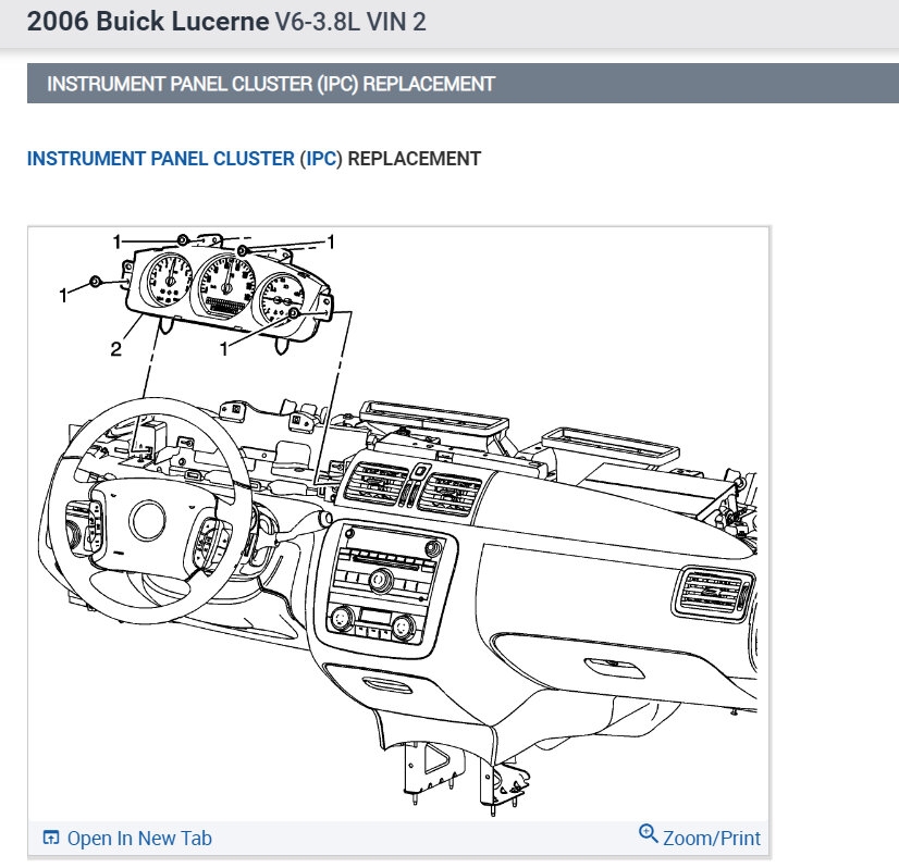

Yep, this happens when the cluster goes out and needs to be replaced. To be sure we should do a CAN scan which will confirm the issue, you can get a CAN scanner (Controller Area Network) from Amazon.
Here is a video to show you how:
https://youtu.be/u-4syLc-ifQ
and
https://www.2carpros.com/articles/can-scan-controller-area-network-easy

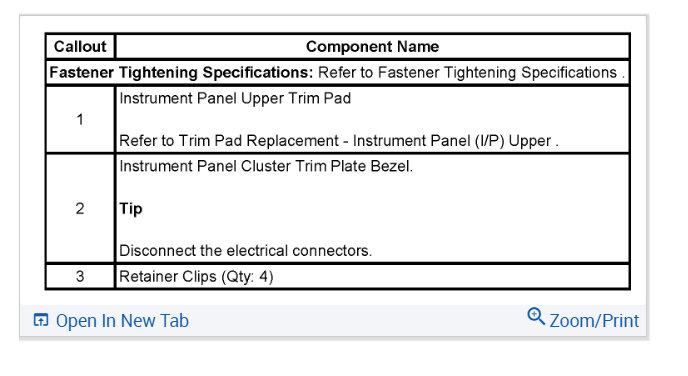

Also here is a video of the job being down on a similar car. The procedures is the same with instructions in the images below for your car.
https://youtu.be/_HEC44xENxw
You can get a rebuilt unit by searching Google or eBay. Check out the images (below). Please let us know what happens.
