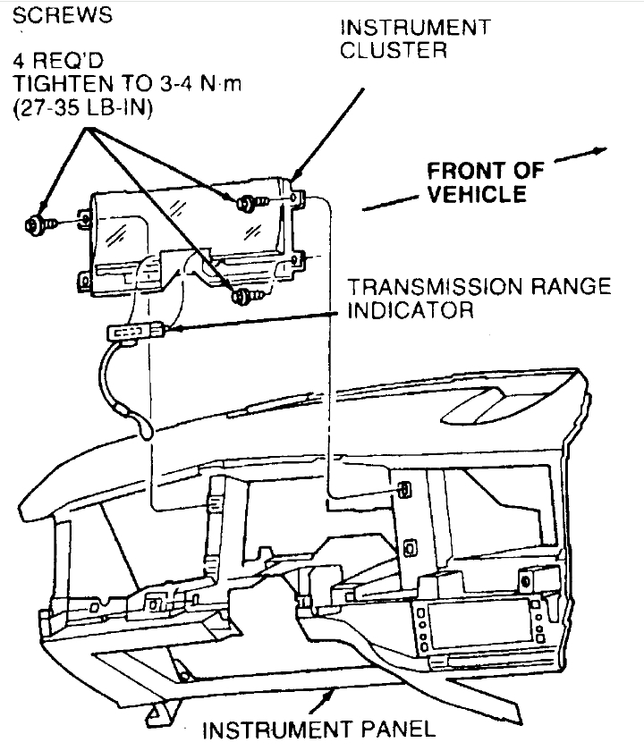

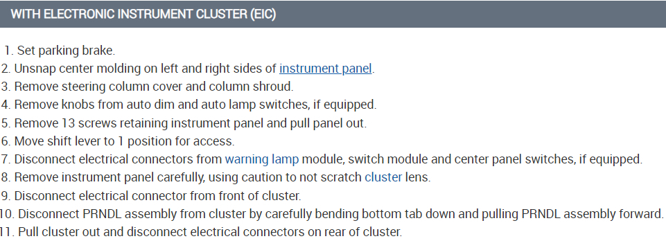

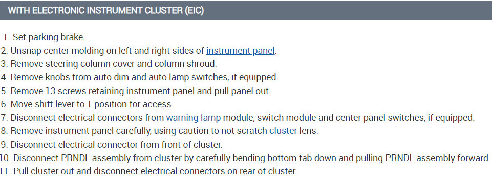

if speedo works and odometer doesn't it's either the speedo or the cluster is bad and needs to be rebuilt. You can get a used or rebuilt unit by searching google or ebay, here is how to change it out. Check out the images (below). Let us know how it goes
