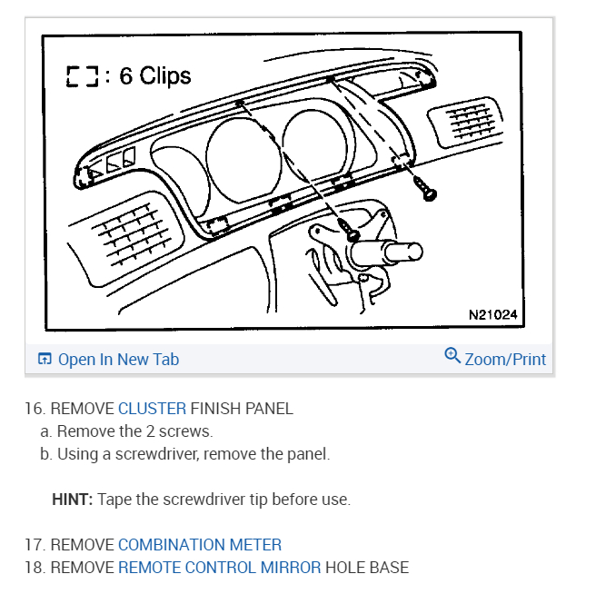

Here is how to change the cluster out which you can get a rebuilt unit for by searching Google or eBay. Check out the images (below). Let us know what happens and please upload pictures or videos of the problem.
