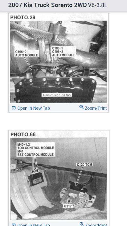

When you say transmission speed sensor did you do both input and output? Can you please shoot a quick video with your phone so we can see what's going on, that would be great. You can upload it here with your response. We should run the codes because when the TCM goes out it cases this issue.
Check out the diagrams (below). Please run this test and get back to us.
