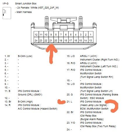

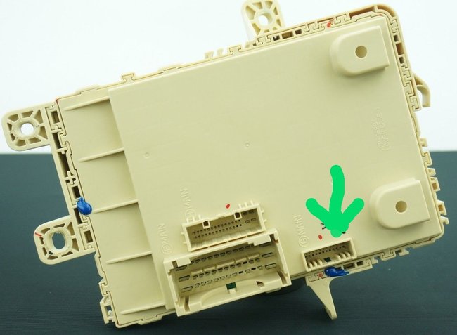

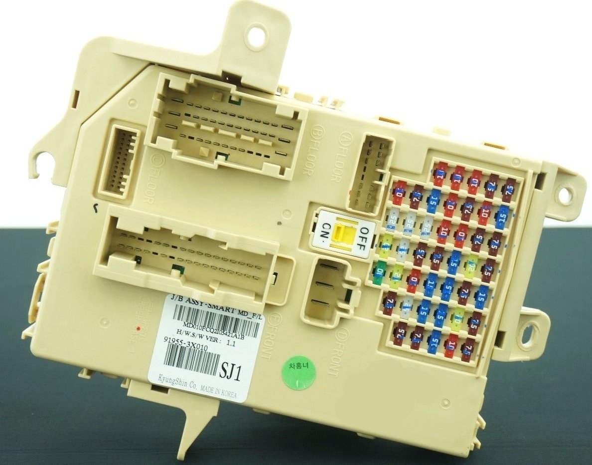

This morning I was greeted with no low beams when I turned my headlights on. If I move the switch back to parking lamps or driving lights or whatever the first click is I have low beams but of course no high beams. I checked all fuses under the hood and several under the dash that might be related. I also swapped the relays around under the hood hoping to make the symptoms move with the relay.
