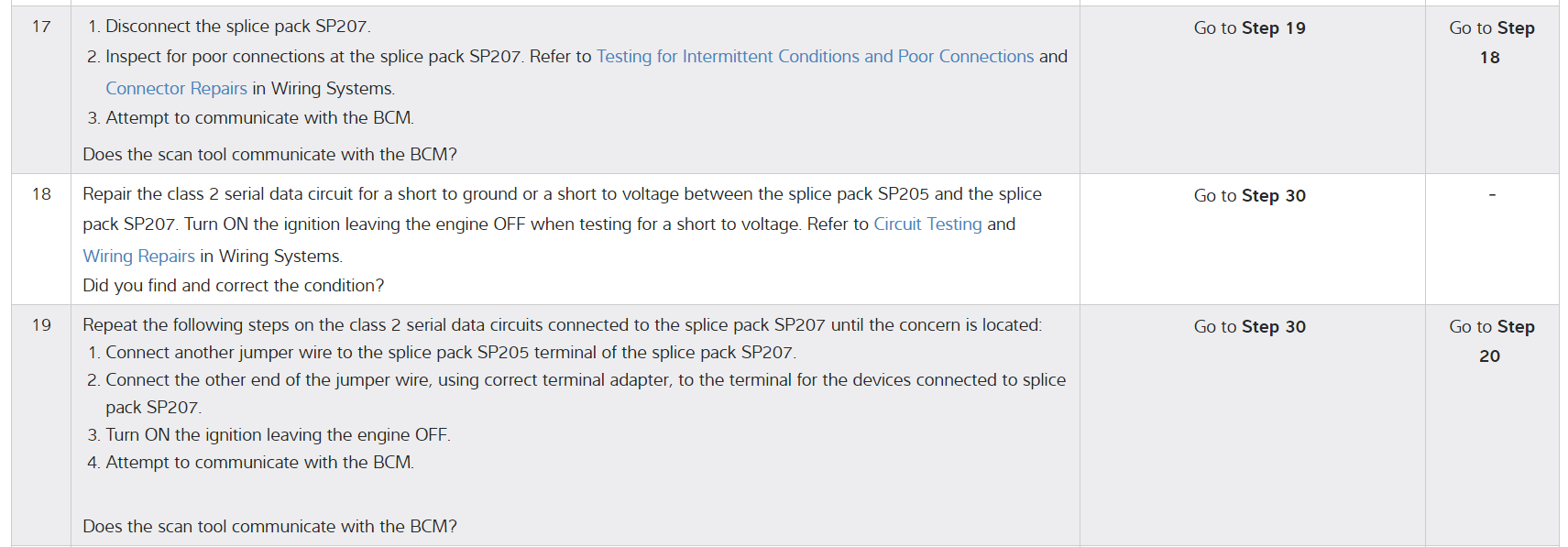

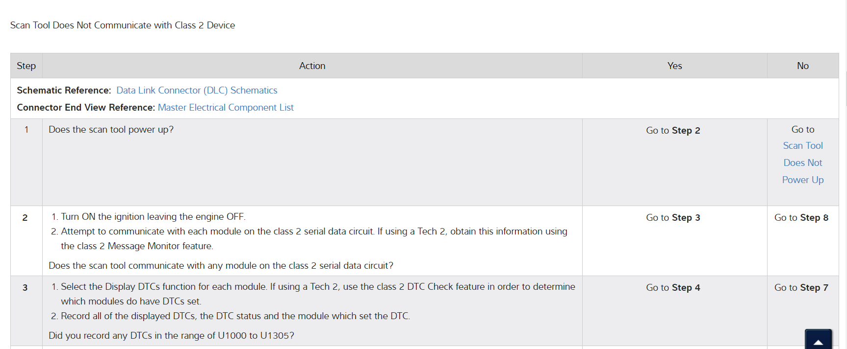

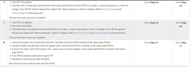

My odb hooks up to odb for inspection it gives it power to start up but it say on the computer that there is a bad connection to port and because of this I can't pass inspection.I have checked the fuse to the cigarette lighter it's a 15 amp fuse and it's still good, but all my cigarette lighter ports are not working.
