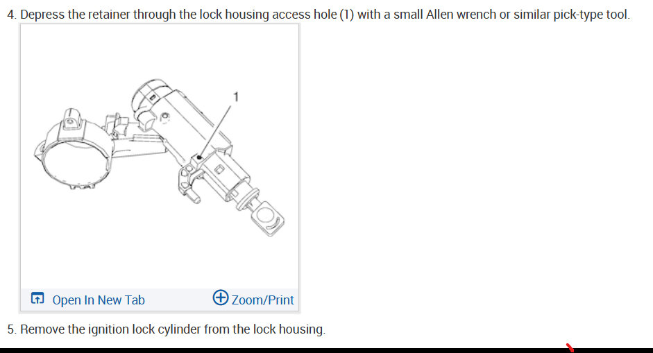

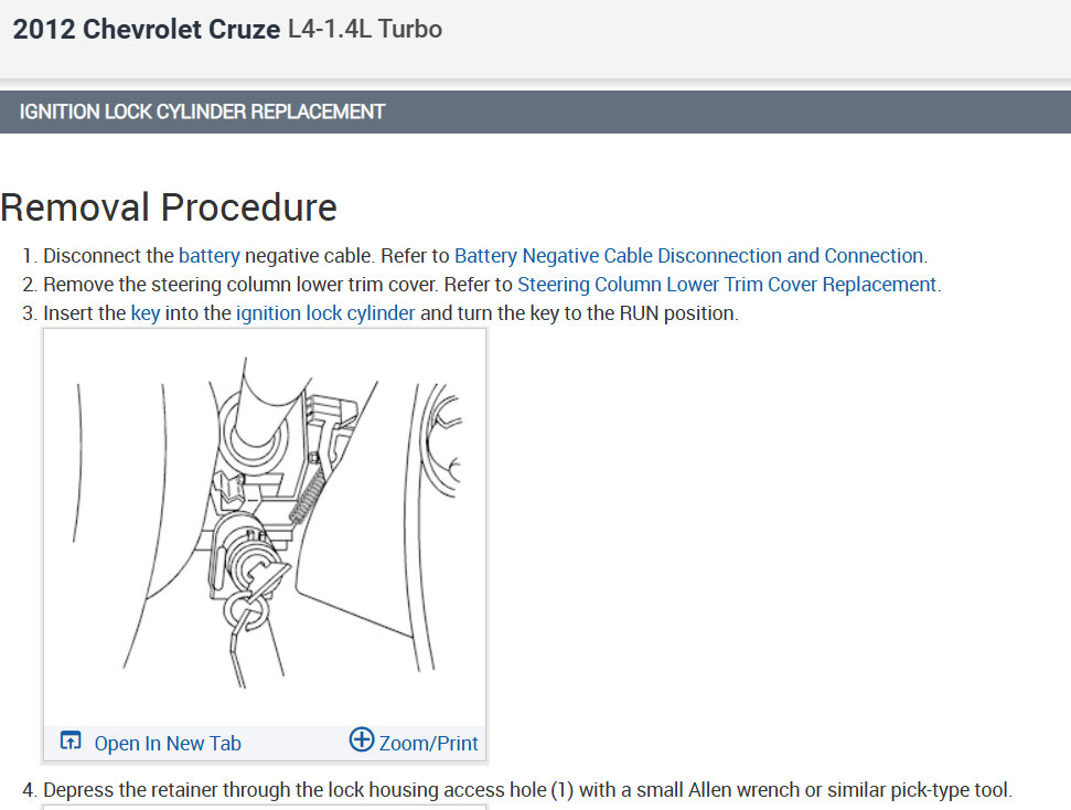

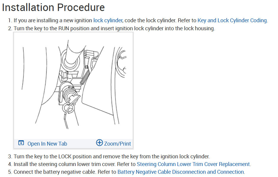

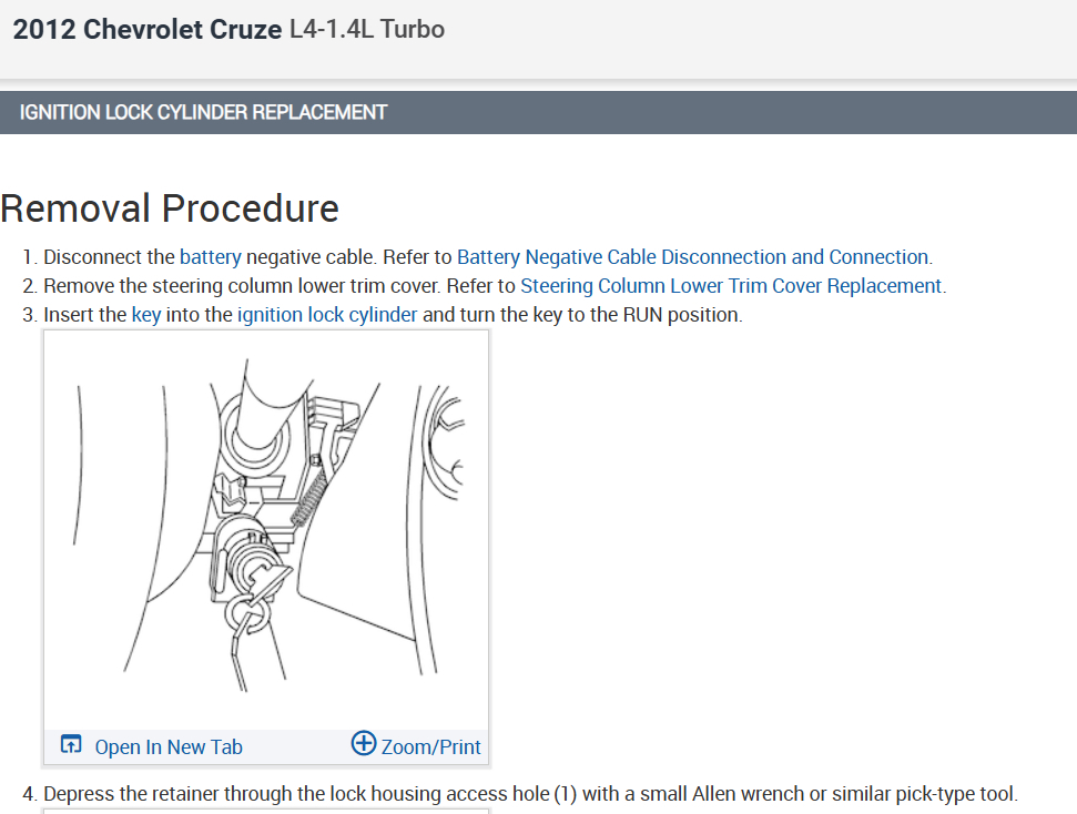

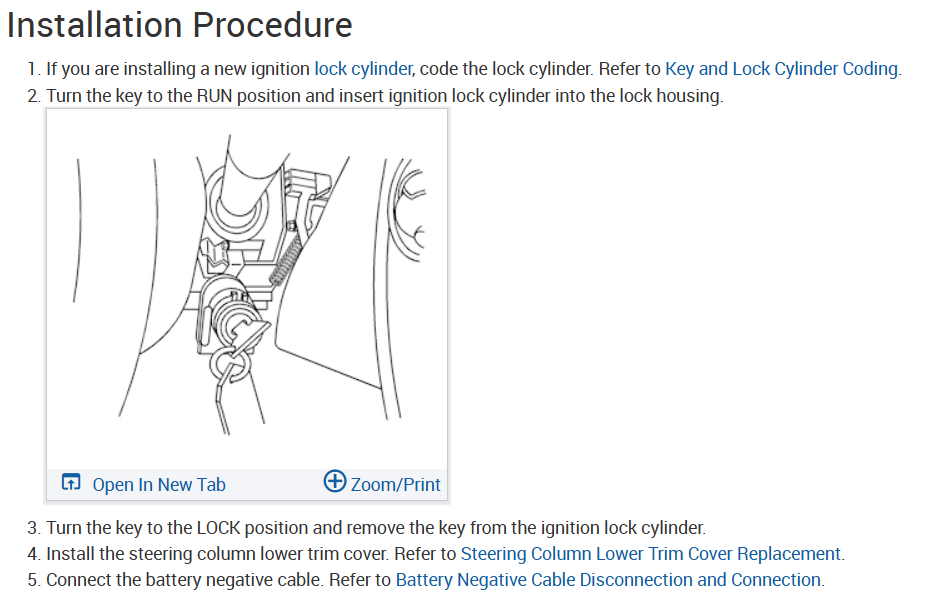

To me it sounds like the key lock tumbler is bad which is common. What happens is they fall apart internally. Here is how to change it out. Check out the images (below). Please upload pictures or videos in your response of any problems so we can see what to help you with.

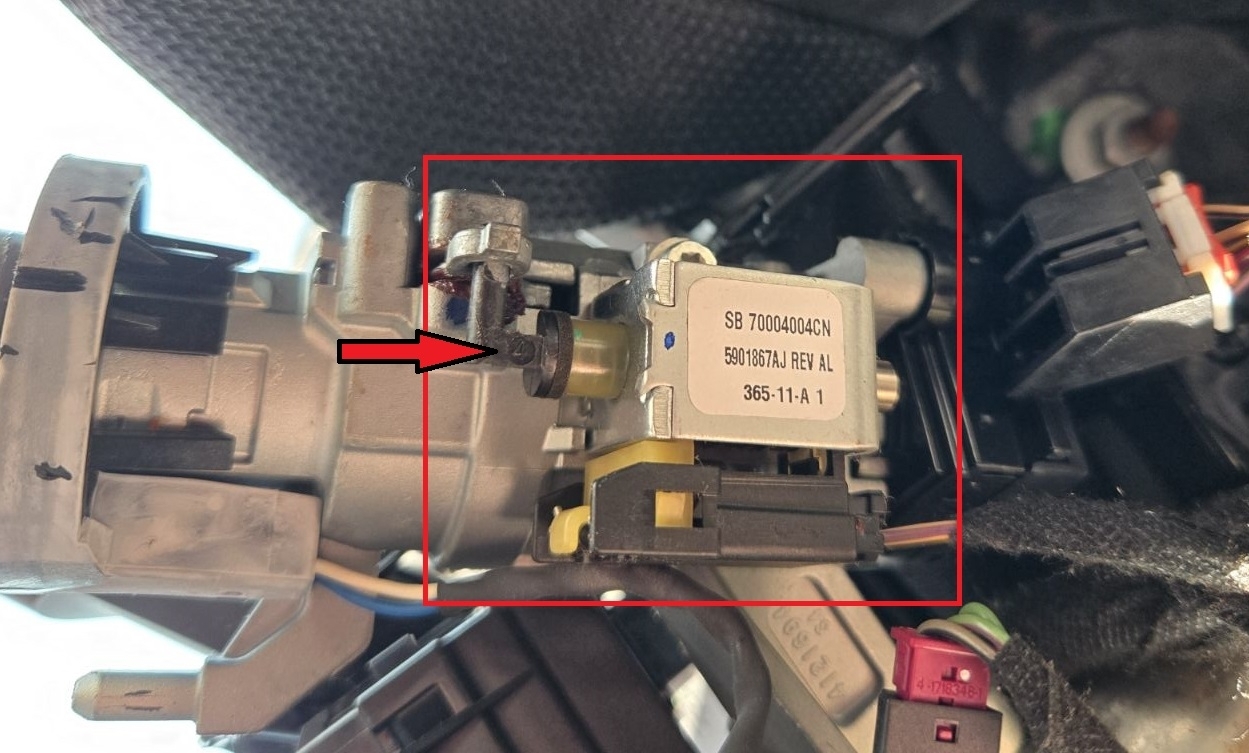

I apologize for the delay in getting back to you. I took the car to the locksmith yesterday. He said the problem was not the ignition lock cylinder, but a solenoid on the ignition housing periodically getting stuck. Please see accompanying photo.) I have ordered a new ignition housing. Hopefully, this will resolve the issue. Thank you for pointing me in the right direction.
Nov 28, 2024 at 3:46 PM
Good find, that is the ignition lock control solenoid in case you needed to know what it was called. Let me know if that fixes it, please. Have a good weekend.
