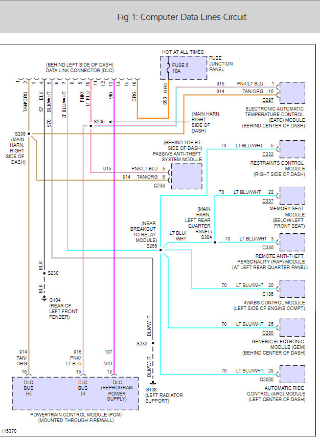

So, I tried my scanner to get a lead on where the issue is hiding and it would not connect to the SUV, it told me there was an error. So thinking it was maybe my scanner we took it to AutoZone and theirs just read an error message as well.

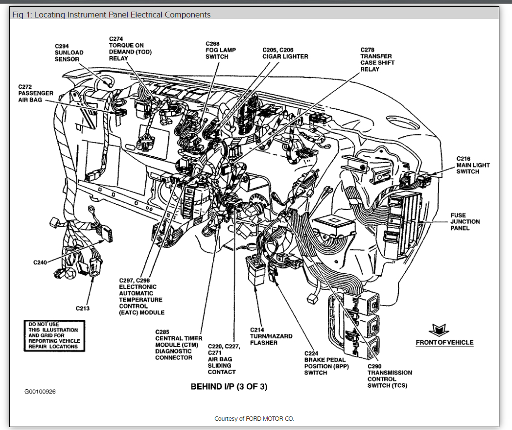

How many wires are suspose to go to the back of the OBDII port?

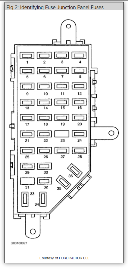

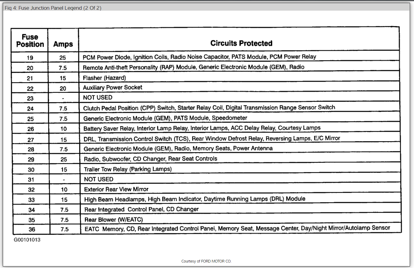

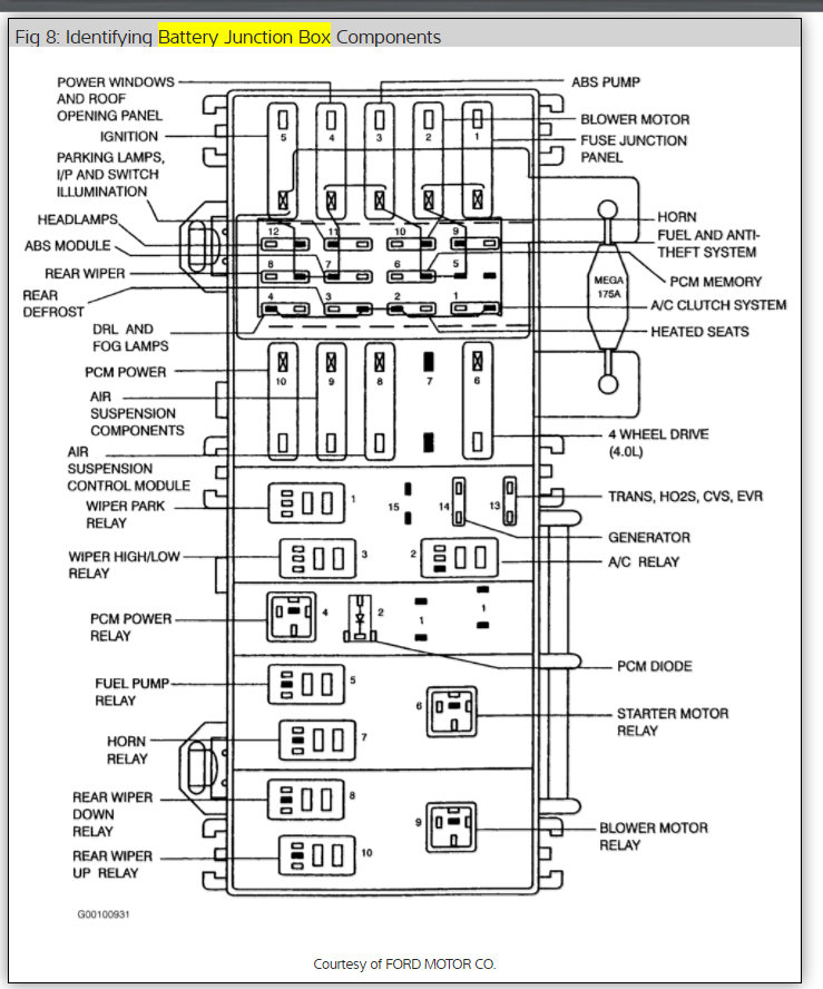

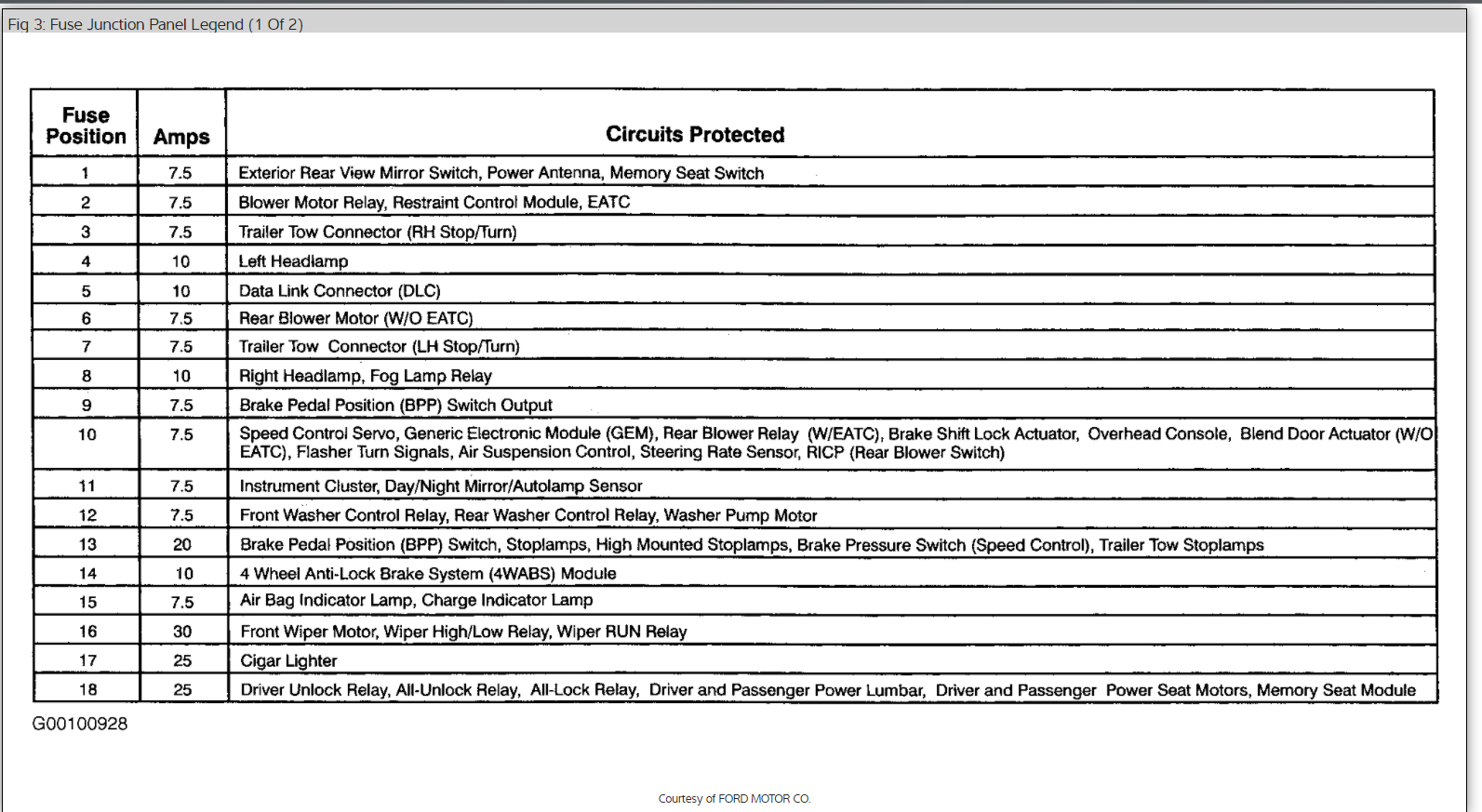

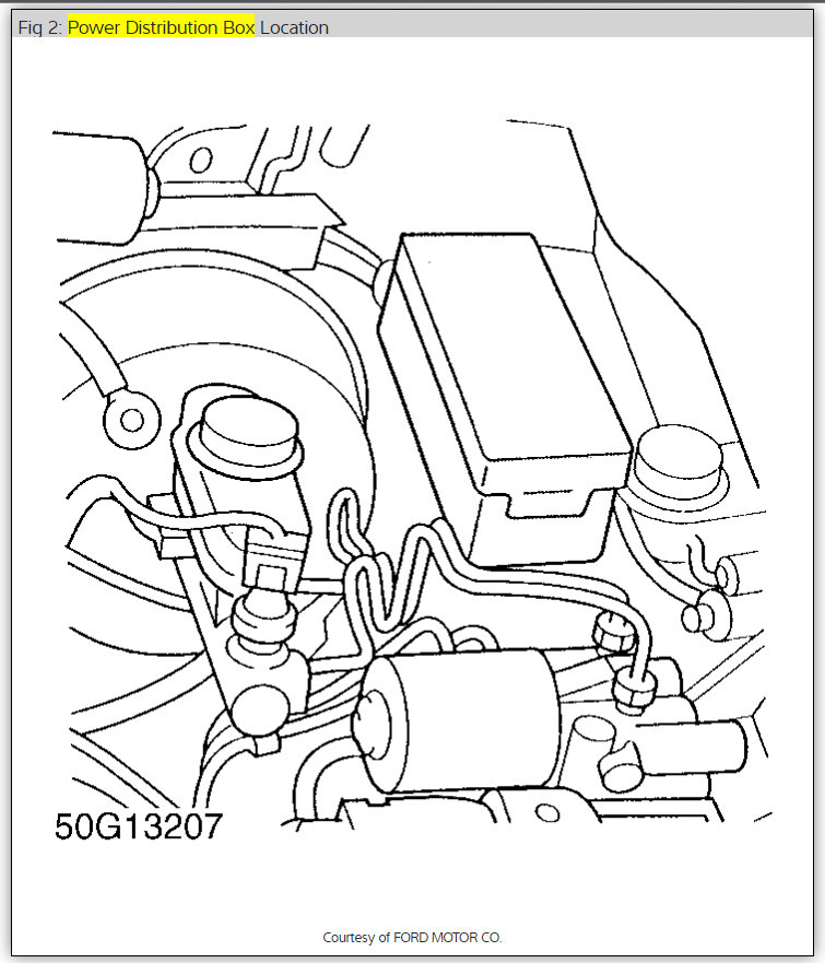

I have checked both fuses associated with the cigarette lighter and the OBDII system they are fine. All the grounds have good connections, battery is good.
