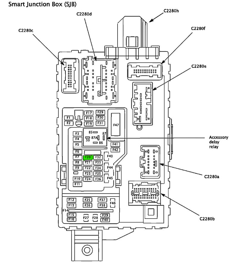

The first thing to check is all the fuses with a test light hooked to battery negative. Then there is a flow chart to follow to diagnose the issue. Checking power and grounds at the data link connector(dlc) where you plug you scan tool in. As well as checking the resistance of the network at certain pins of the dlc to determine if one of the terminating resistor has failed in a module, I will post the flow chart for diagnosing the network below shortly. Do you have a basic multimeter and what kind of scan tool are you using?

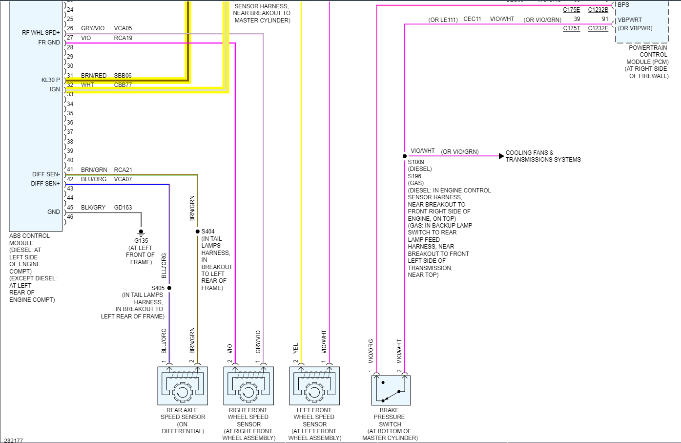

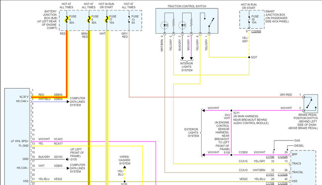

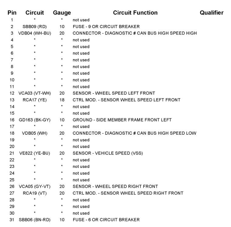

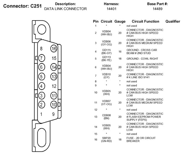

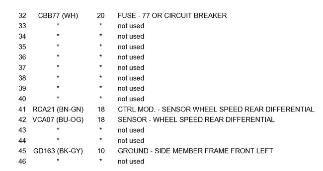

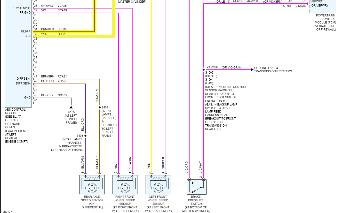

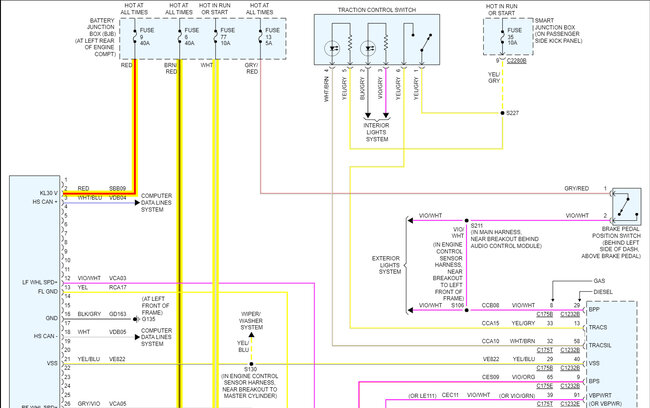

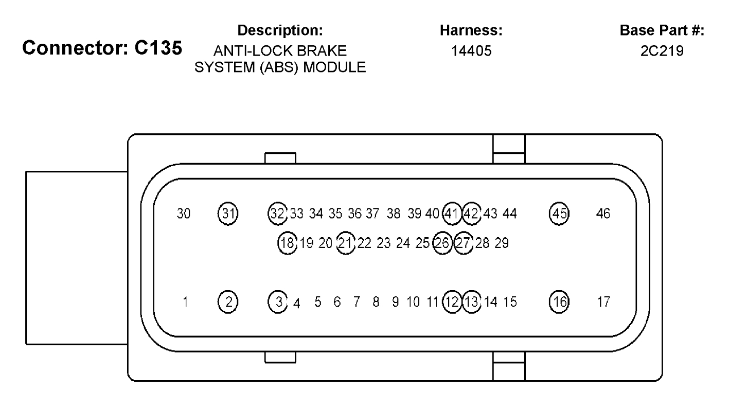

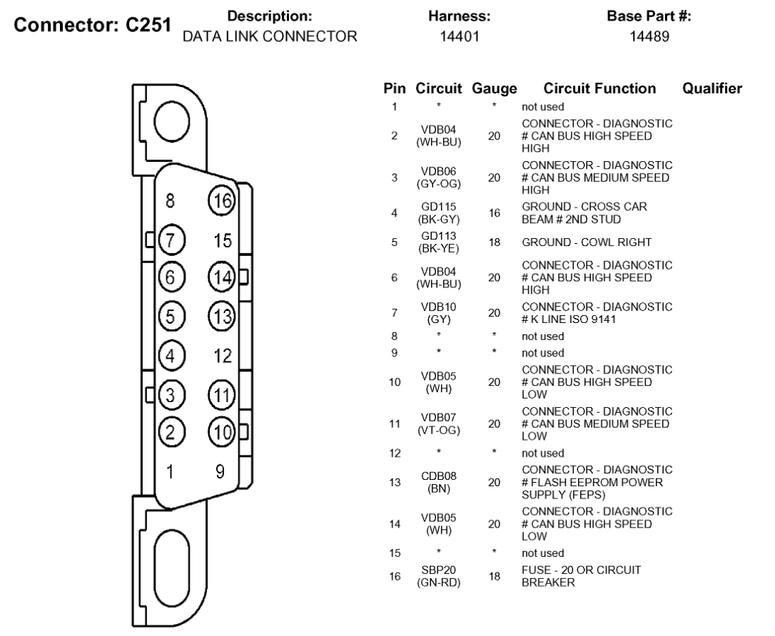

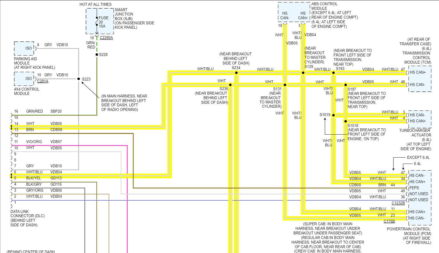

The first diagram below is the Data Link connector for your scan tool. The second is the wiring diagram for the connector, you can see on the left all the pins for the connector. The first thing to check is that Fuse 20 15amp in the smart junction box on the passenger side lower kick panel. And because of the location of this junction box, I would inspect a bunch of the fuses in that box for a corrosion that may have happened due to water intrusion. Those boxes and fuse panels in those locations are always susceptible to moisture due to a number of reasons. I have seen numerous fuse panels in those locations have problems. If you see any white or green crusty type corrosion in the pins for the fuses or any connectors going into that box, the box is most likely full of corrosion inside.

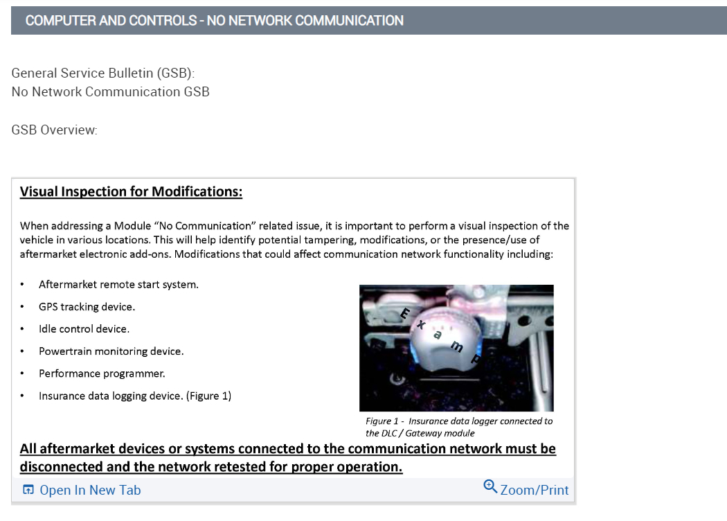

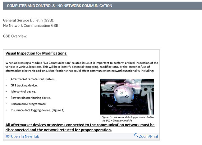

Also do you have any aftermarket devices installed in the truck?

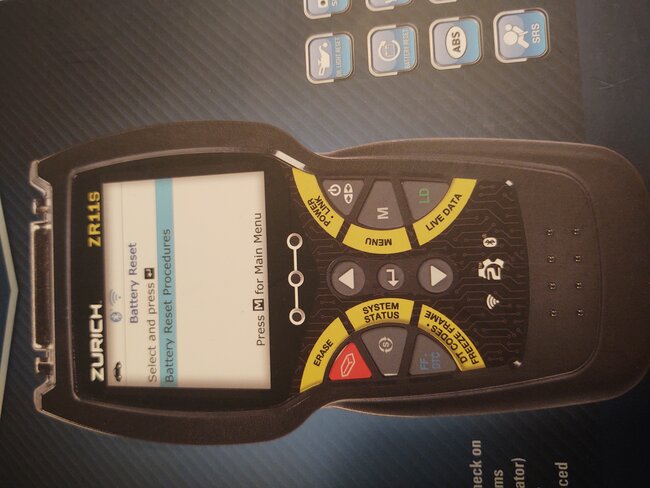

I have the scanner that reads all aspects including ABS, but it will not link to the truck. I have 12 volts across pin 16 and pin 4.

So, you can't communicate with any modules at all. You have 12v across 16 and 5 as well? Does your scan tool have an oscilloscope as well? Being able to view the network in this situation is a huge help, if not you can try with a multimeter across pins 6 and ground and 14 and ground, those are CAN BUS high and low pins, with the key on, they should average about 2.5volts. The network is too fast for the multimeter to keep up but there is a 2.5volt bias voltage that you should be able to read. If you end up reading anything else let us know. For example, if it reads 12v or close to 0v then we know the network is shorted to either power or ground. I'd be curious to see what they are reading. What type of scanner do you have? How did this issue start, was it a sudden issue, or were things starting to act up over time?

This is my code reader; I do not see an oscilloscope option. I ran out of time today, but I will do the pin check tomorrow.

Okay. yes, that scan tool is pretty limited. In a case where I did not have communication with an engine computer (ECM), the first thing I do is attempt communicating with a different module and look for a Check Engine light at just key On. If there's no Check engine light, then the ECM is most likely not being powered up and also there would be no 5-volt Reference to sensors. Those are two quick checks I would do to see if it's actually the computer not powering up. If the computer is powering up, then I would suspect a gateway module issue (which is the instrument cluster in this vehicle) or a possible wiring issue with the can bus circuit. The Instrument Cluster being the gateway translates high speed can messages to other networks such as the medium speed can bus network and is the only module that does this.

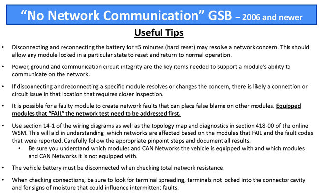

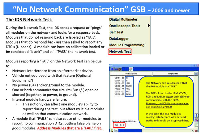

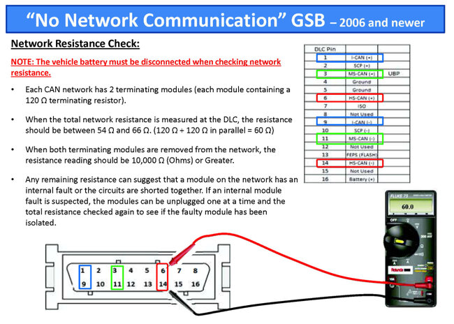

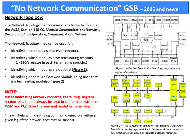

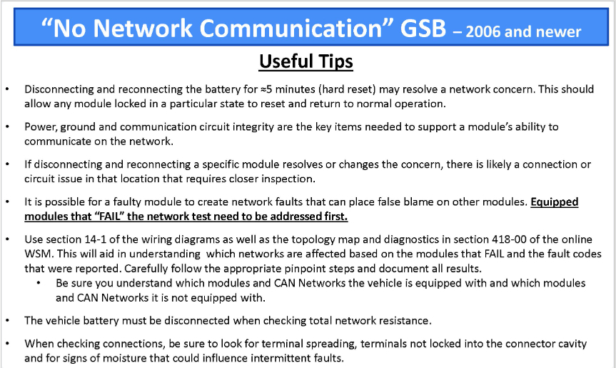

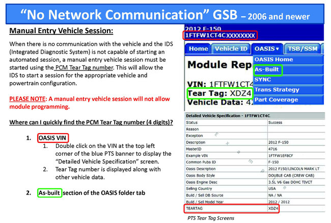

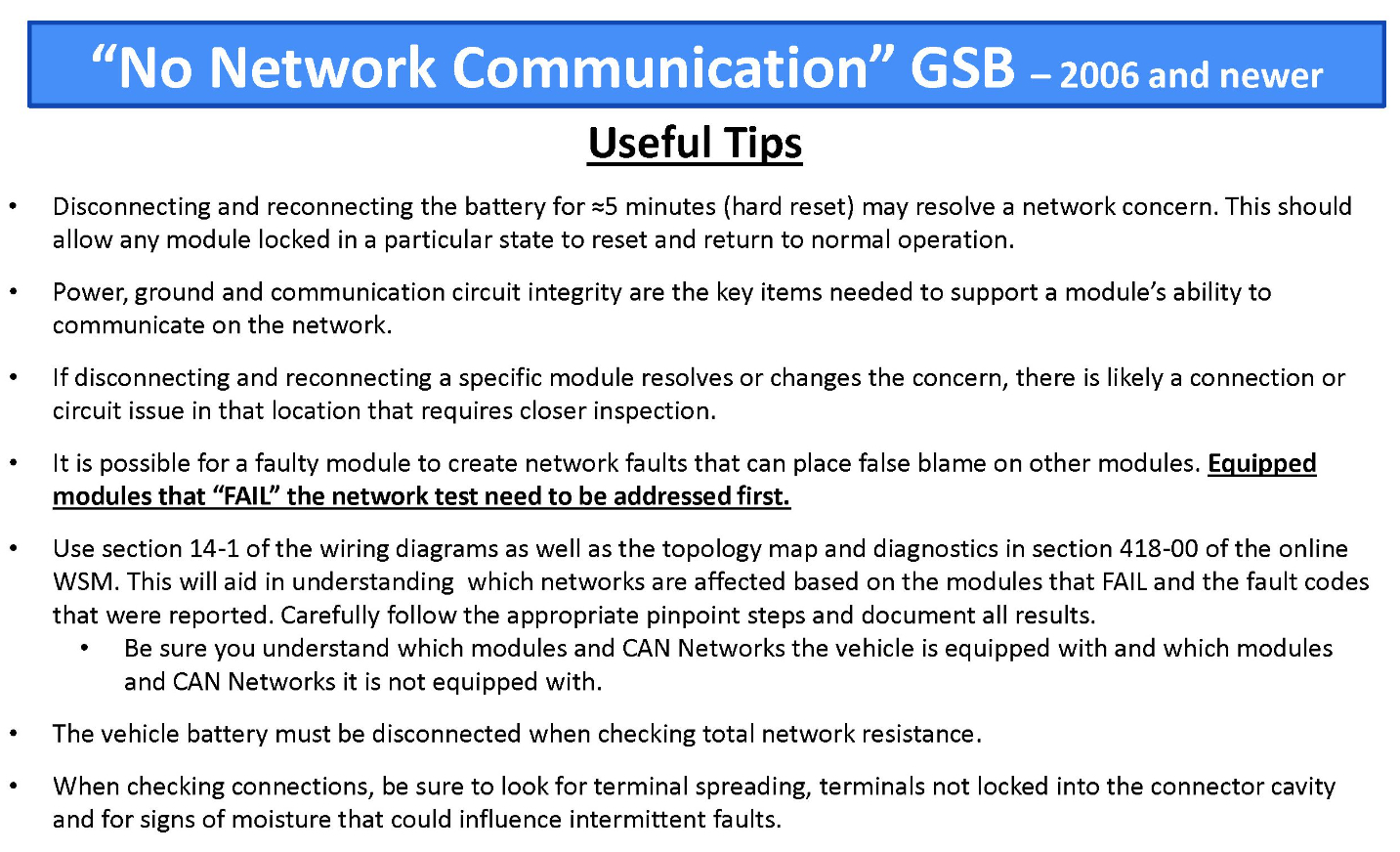

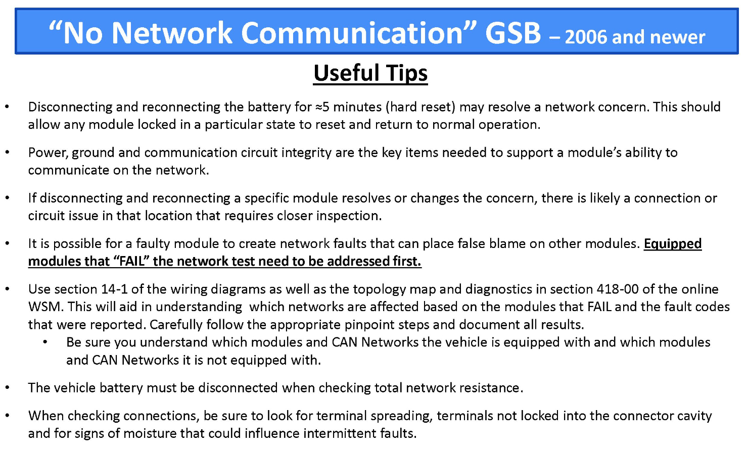

If this yields no positive results, I'm posting below the instructions on a Technical Service Bulletin for No Network Communications checks that can all be done with just a multimeter. But you have to follow the instructions closely because you can't check the network resistance with the battery connected.
Let us know what you find.

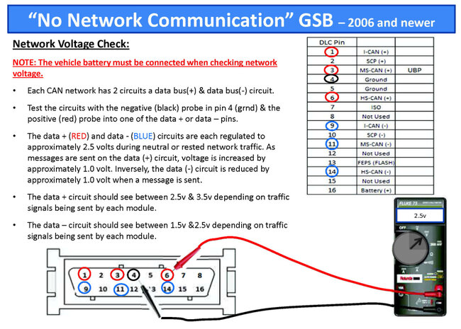

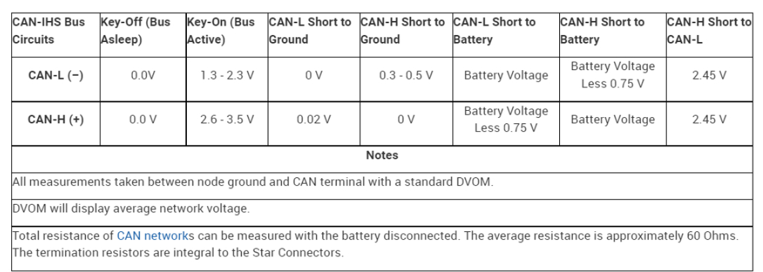

I have about a half volt from 14 to ground and 6 to ground, in ignition on position, I have the check a check engine light, battery light, ABS, brake and a flashing red padlock. I can't find any rub marks on the wiring harness, and everywhere there is a termination that I can find, they seem secure.

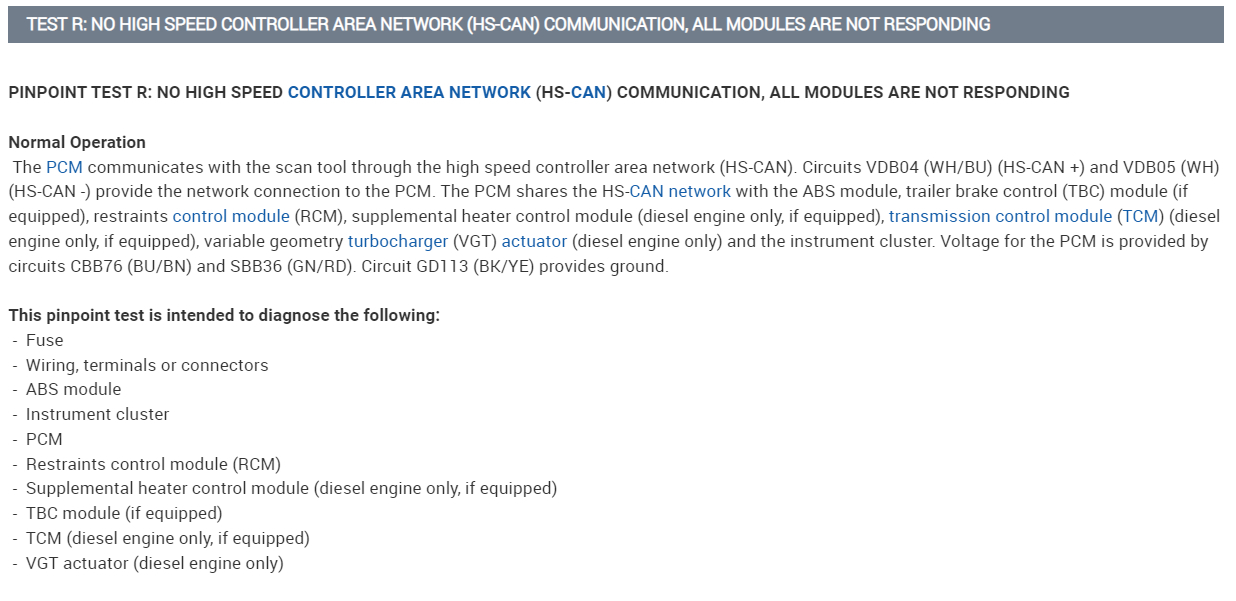

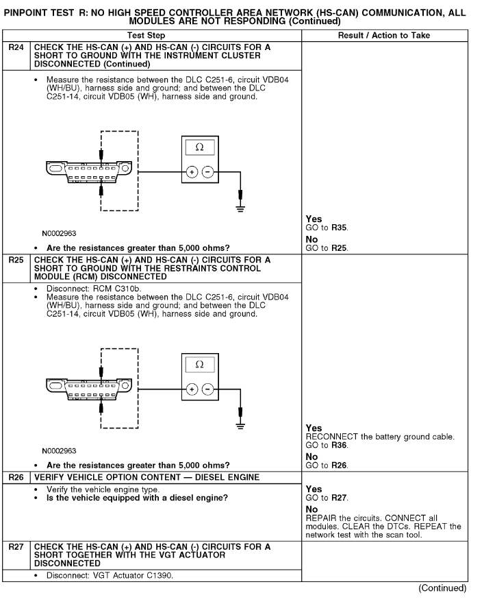

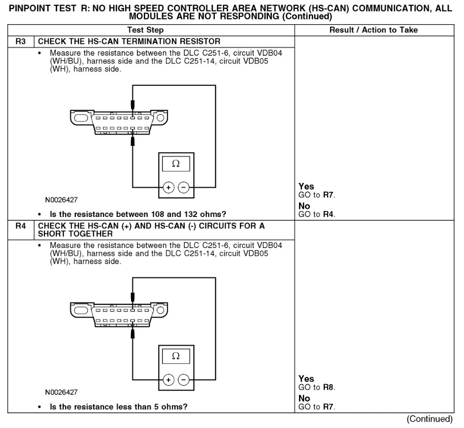

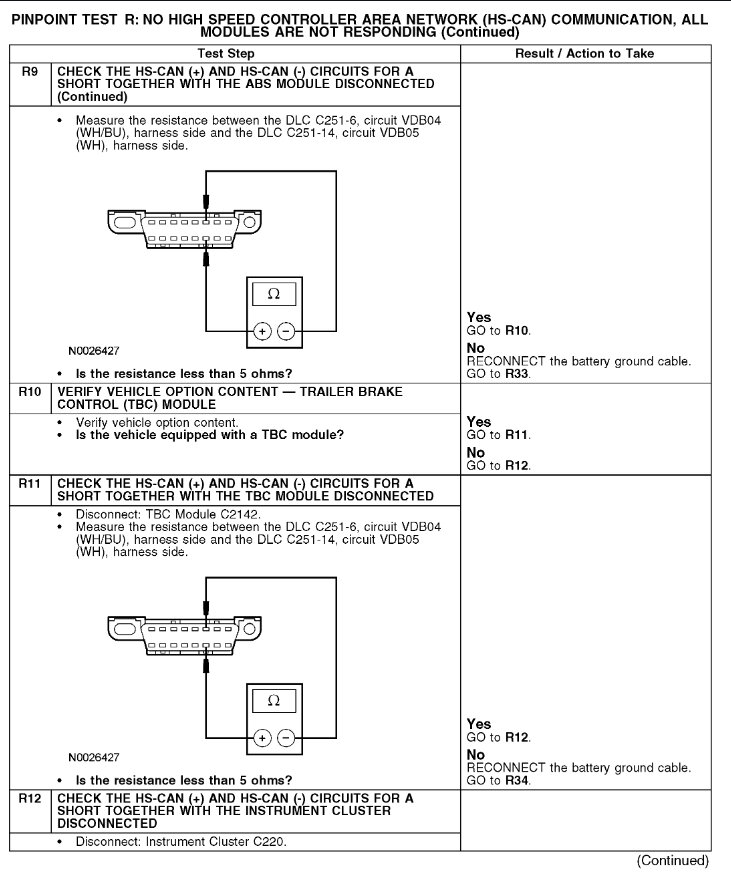

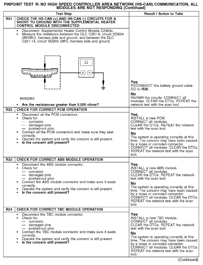

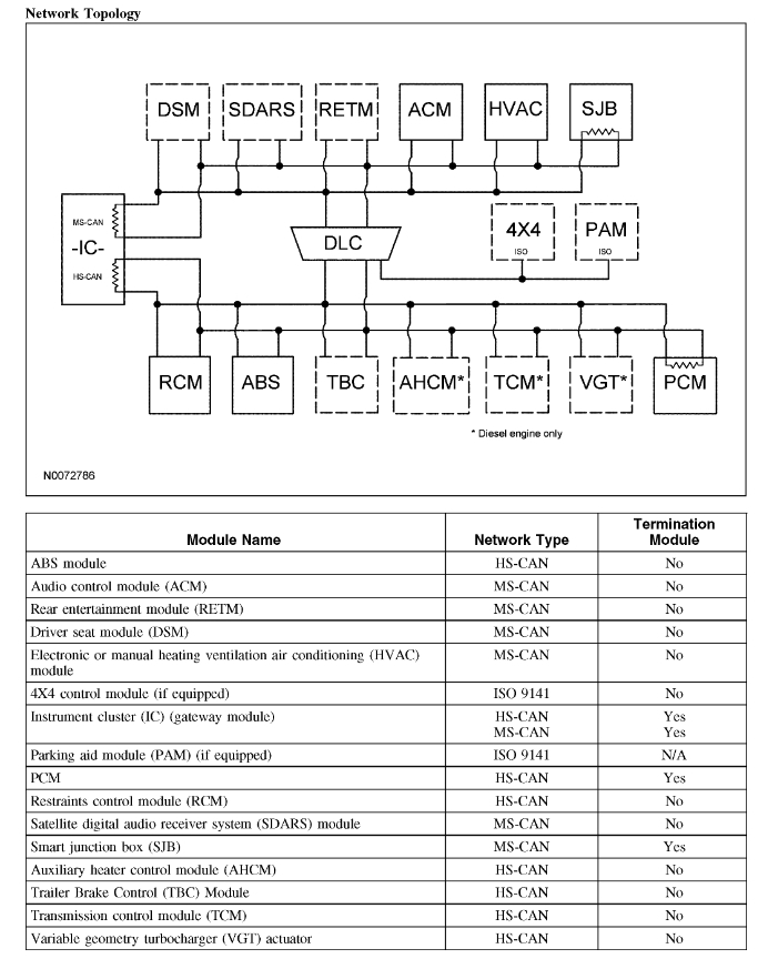

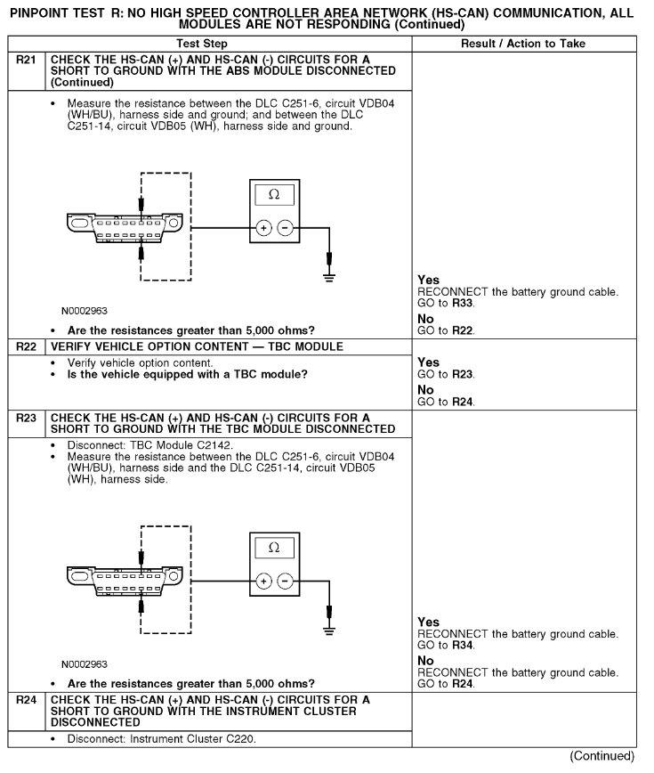

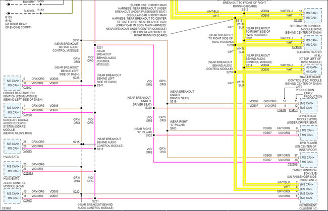

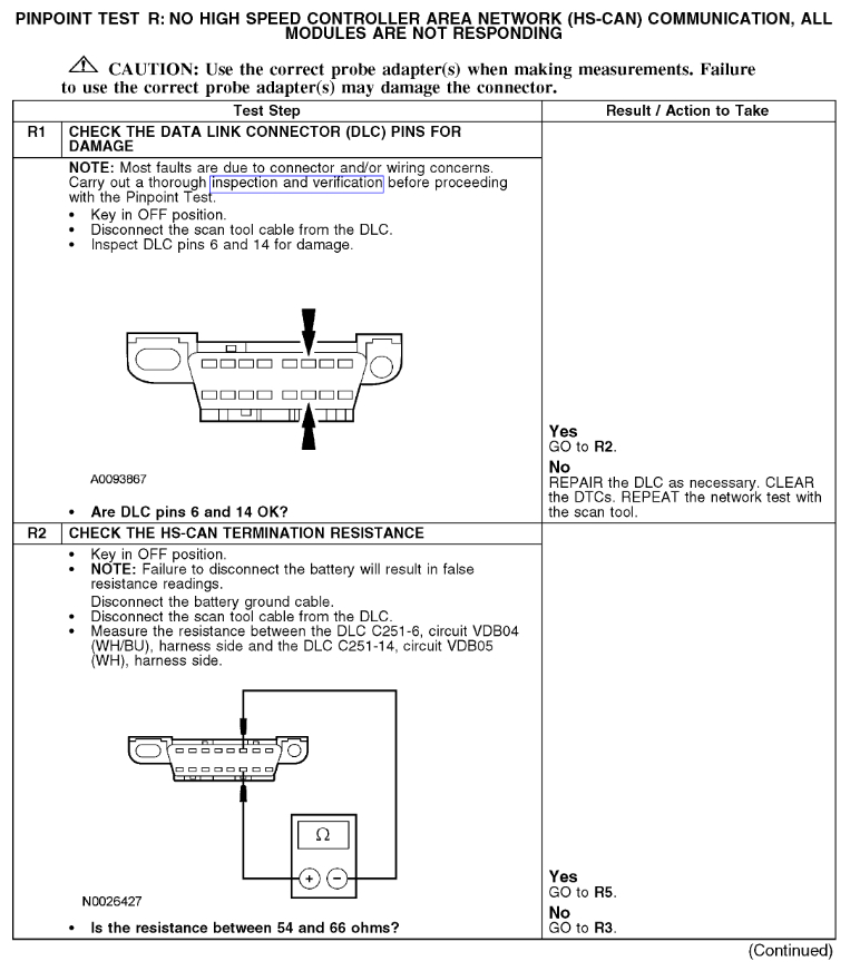

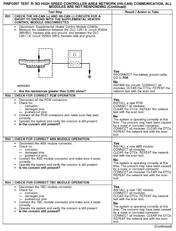

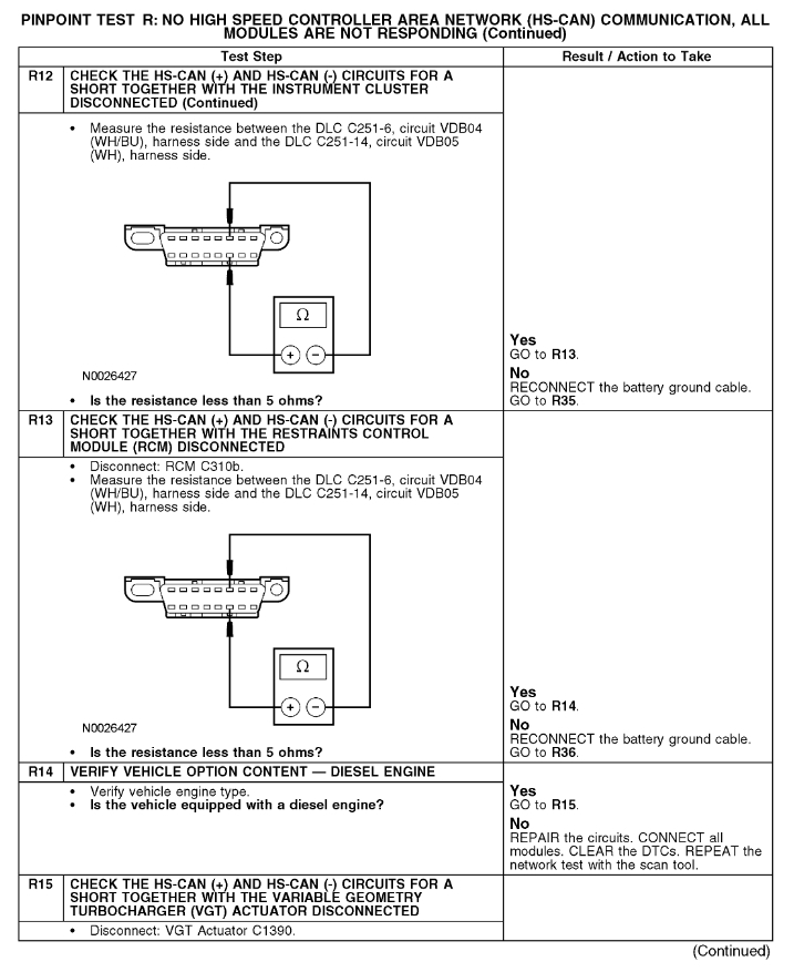

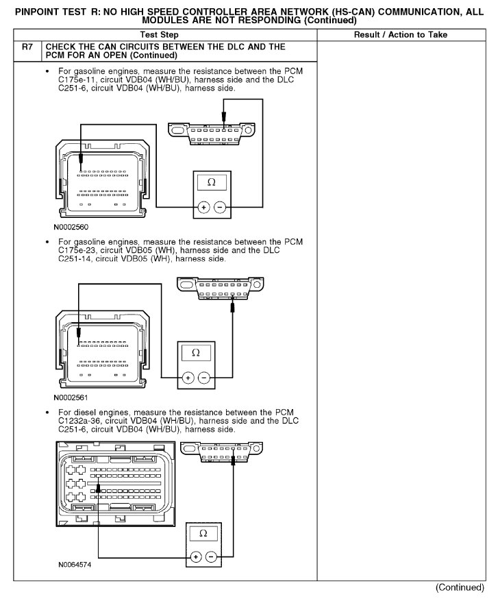

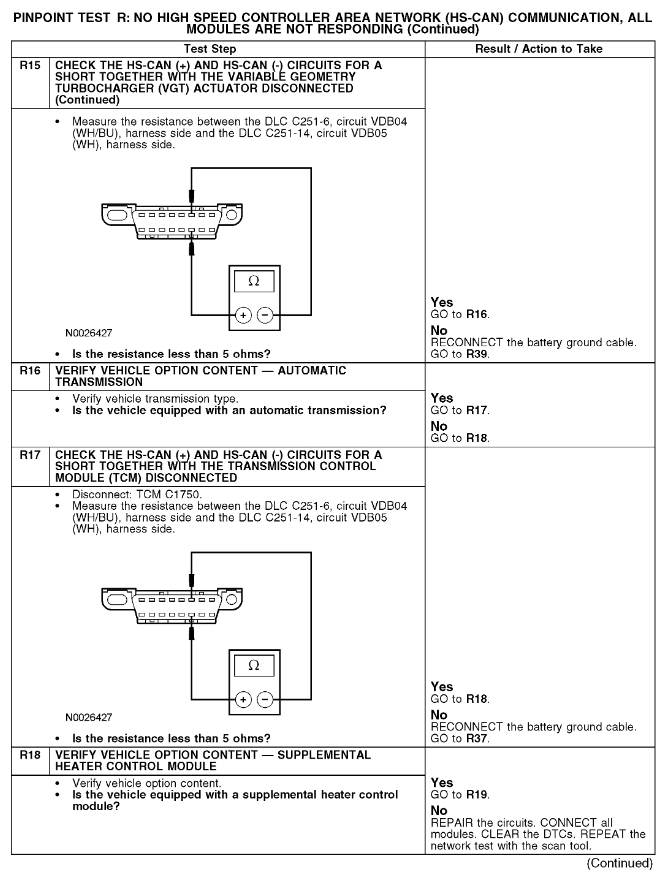

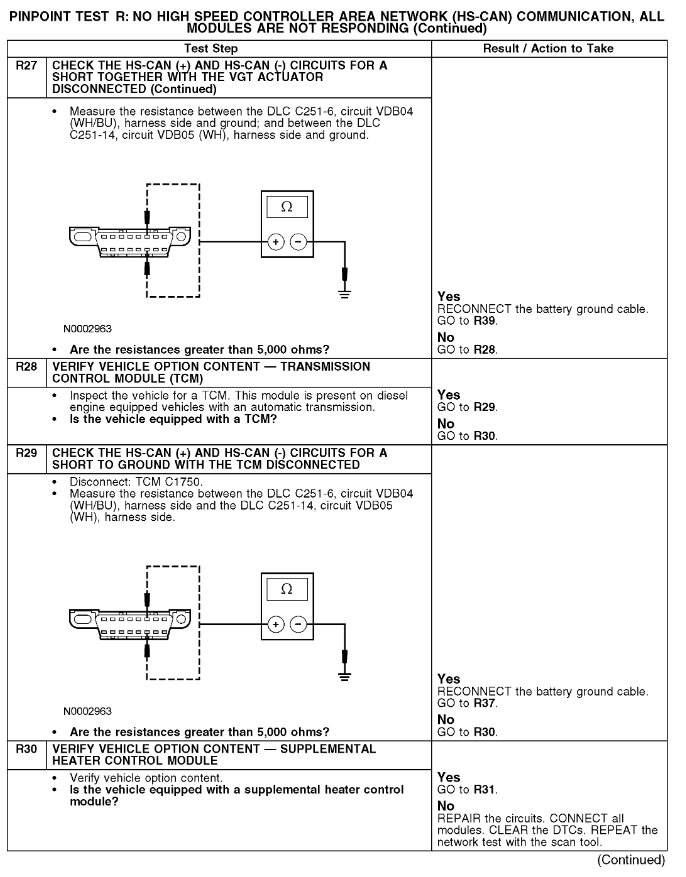

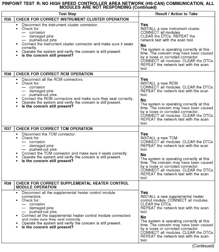

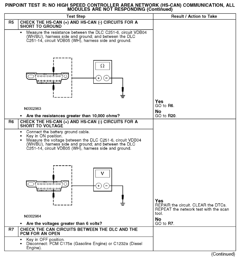

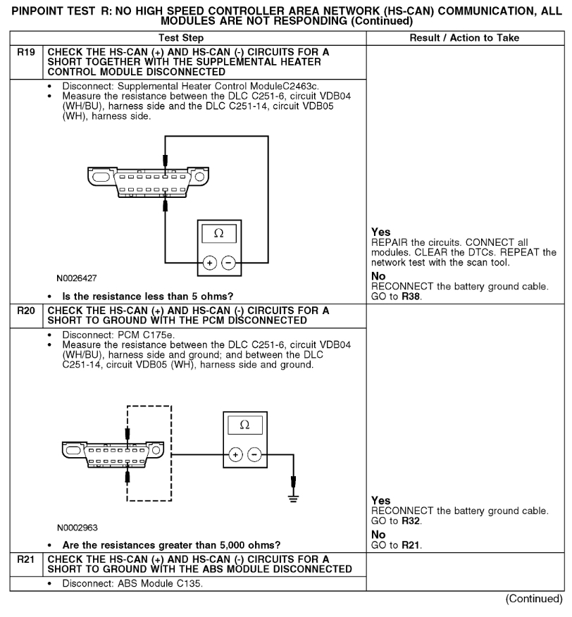

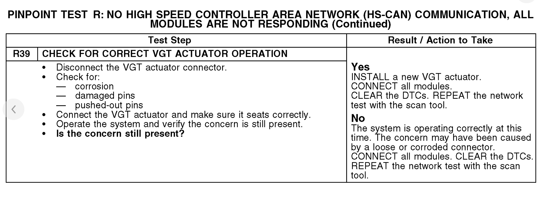

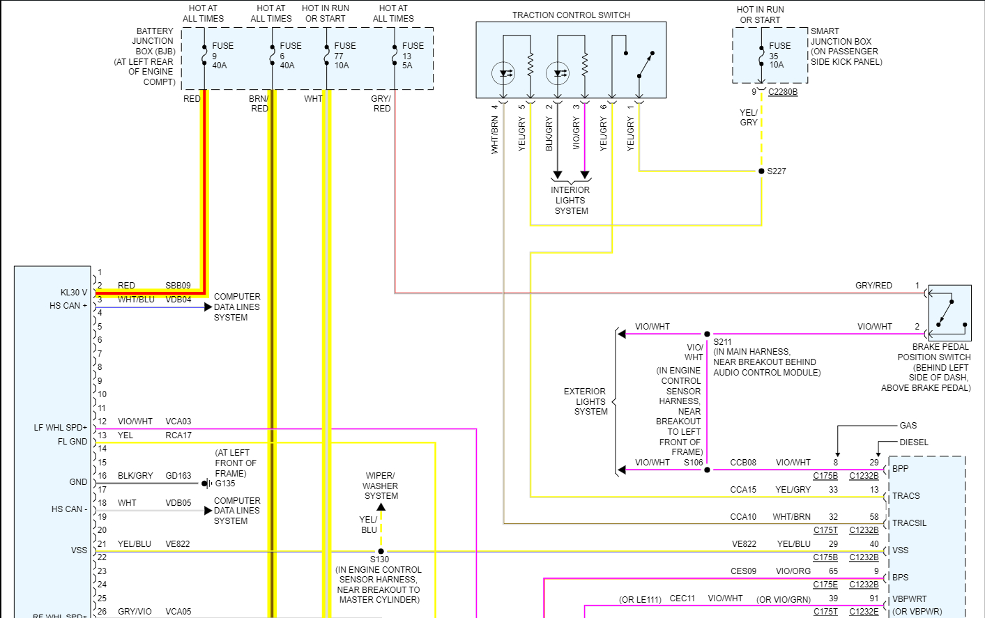

Okay, so, the PCM is powering up, there is another flow chart which is the OEM Ford flow chart which has you start to disconnect modules and check for shorts.

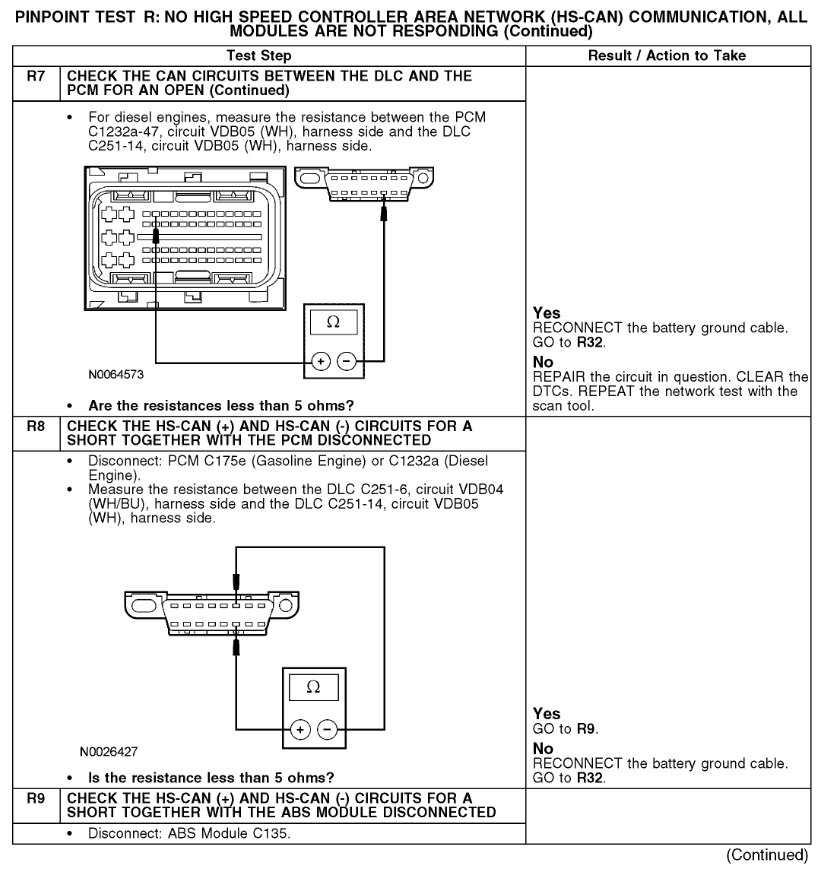

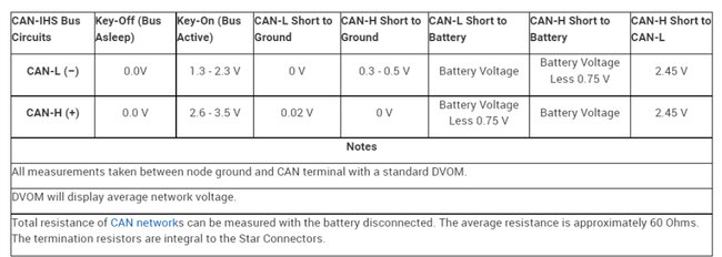

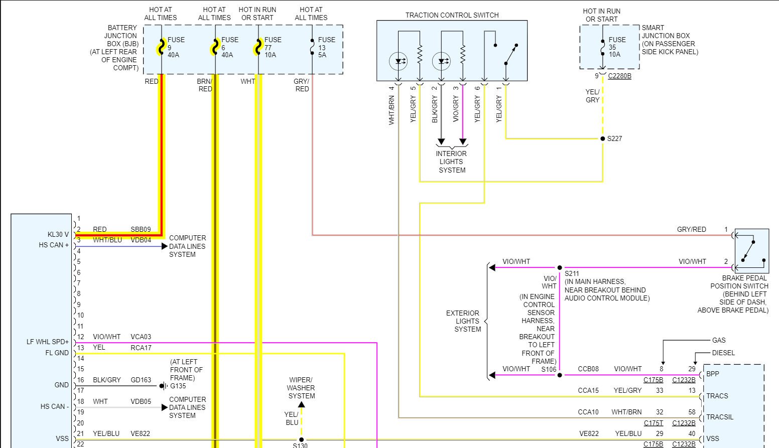

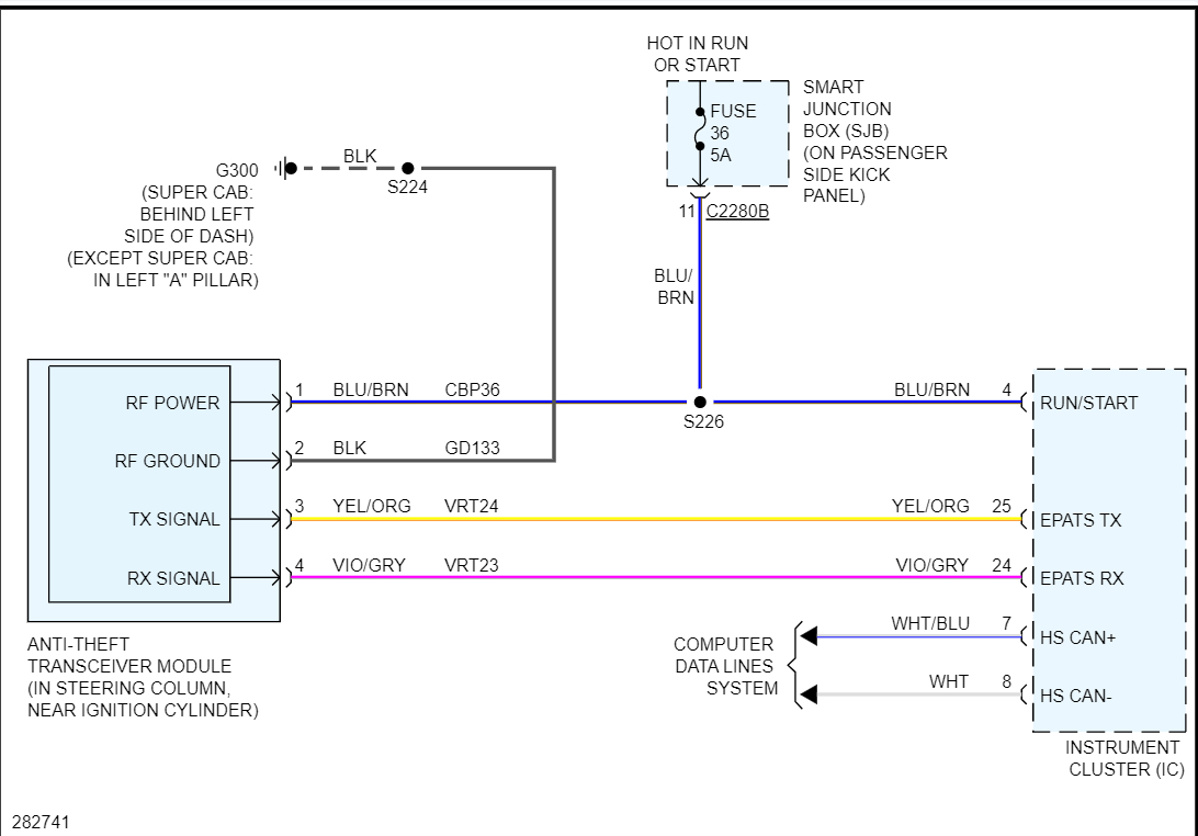

It sounds like the can network is shorted to ground somewhere. Some of these tests you have already performed but don't skip any steps in the procedure. There are a lot of checks to actual modules from the data link connector. Without an oscilloscope this is the route you'll have to take. With a scope we could just unplug modules until the network returned to normal function. The one thing to be careful with is the Restraints Control module (RCM), make sure the battery is disconnected at least 20 minutes before disconnecting this module, although you will probably be at that time limit when getting to that step, but you just don't want to set off any air bags. The RCM is step 25, so just be aware of the battery before performing that test.

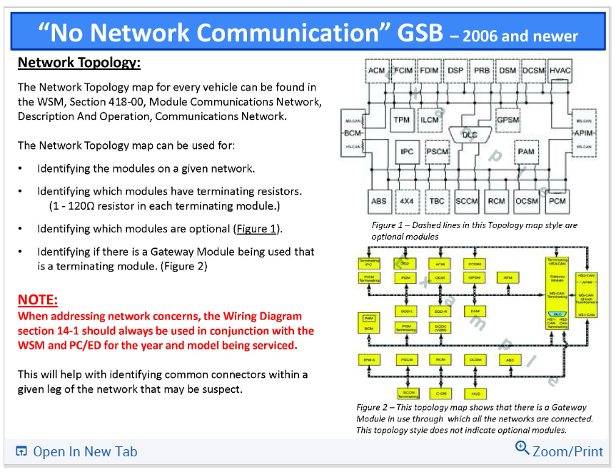

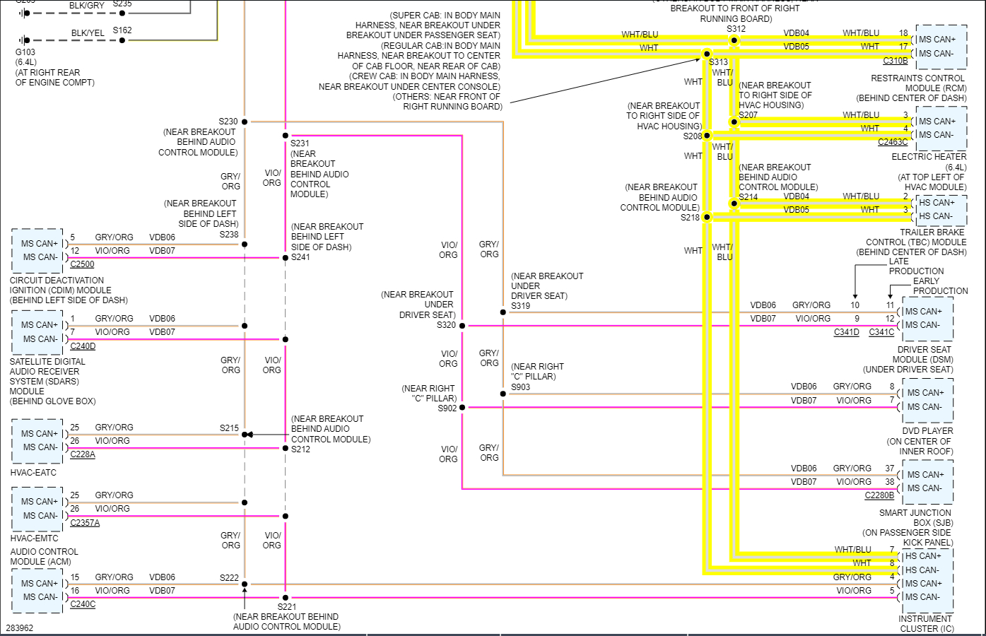

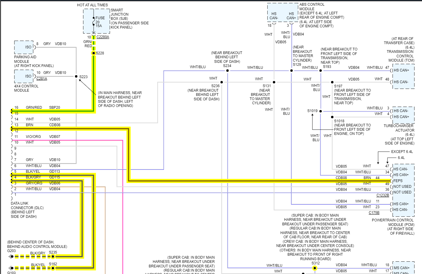

The last diagram is the entire network topology (or network layout), so you can see which modules have terminating resistors in them and what is on the high speed and medium speed sides. Since this is such a long test procedure, do a good visual check under the dash on the driver side for any wiring issues near the DLC. I'm also putting up the Security system diagram last.

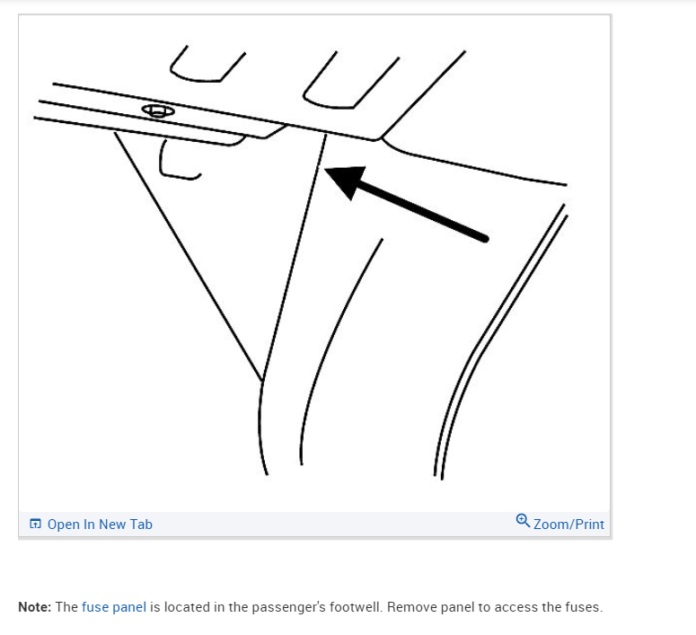

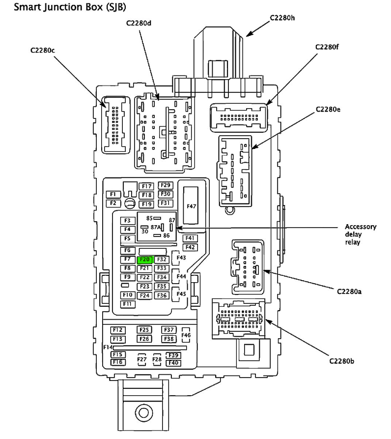

One last thing; have you gone through and checked all the fuses? I assumed you had done that first, but should have asked,

Honestly, I wish I could give you easier tests to do. I know the flow chart is a ton of steps and it can be easy to lose your place. But knowing that you are reading barely any voltage at all, I think maybe unhooking the battery negative, give it 10-15 minutes and then see what the resistance reading to ground is on pin 14 and 6. Using the battery negative cable for your ground instead of pin 4 or 5. And see what you get before you start on the flow chart. One other thing I was wondering, what were the readings on each pin 14 and then pin 6.
The reason I ask is if the Can High line is the one shorted to ground, pin 6 will read 0volts and pin 14 which is the Can Low line of this 2-wire network will read something a little bit higher, not much but it will be 0.3 to 0.5 volts because of the Terminating resistor in the circuit. If it's the opposite, pin 14 Can Low is shorted to ground, it will be reading 0volts and pin 6 Can High will read about 0.2volts. If we can determine which of the two wires is the actual shorted one, we can start following that wire. There are some splices and I'll post the diagrams showing you what I mean, and possibly find if this is a shorted wire, or if it's a module that has a short in it. Some modules we can get to easily enough such as the ABS module, the Turbocharger actuator, the PCM, we can unplug and see if the short disappears.
And if we can't get anywhere with that, then you can start going through the flow chart. The diagrams 2 and 3 below are the high speed can come from the DLC you can see on the left of diagram 2. Pins 11 and 2 are the Medium Speed can bus, so it appears that it's only the High speed that is down. You were not able to communicate with the ABS module either I assume. So, we can try that if you want, those two network wires are the same color throughout the entire truck.
When you check at the data link connector, back probe the connector if you can so the pins don't get spread, since you'll have to have a meter lead hooked up to it for a while, unless we back probe the PCM connector. But start with getting a voltage reading for each pin and then disconnect the negative battery cable off and do a resistance test on pins 14 and 6 to ground. Maybe we can make this a little easier on you.

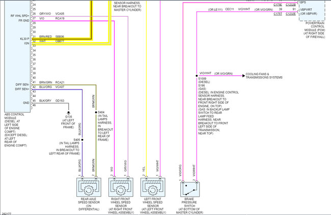

The ABS light started the whole shooting match, it was the first warning light. I replaced all the sensors, even the one in the rear end, so we might get lucky. I will keep you posted. And once again, thank you.
Oct 8, 2022 at 7:14 PM
AL514
  • 5,464 POSTS
Try unplugging the ABS module with the key off, then try your scan tool with the ABS module unplugged and see if you can communicate with the PCM.
Oct 8, 2022 at 9:13 PM
HILLY59
  • 23 POSTS
Will do.
Oct 8, 2022 at 9:22 PM
HILLY59
  • 23 POSTS

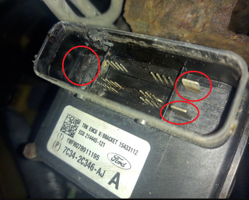

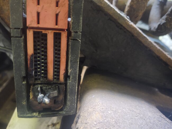

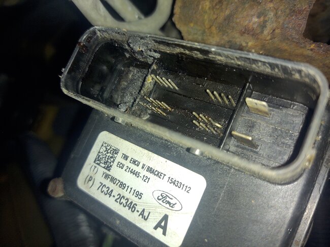

Thank you so much, the ABS module is fried, I unplugged it and was able to link to the computer, I will start by replacing that and go from there.
Oct 9, 2022 at 11:47 AM
AL514
  • 5,464 POSTS
Oh my gosh, that thing is literally fried. I don't know what is it with Fords ABS modules, they seem to be the first to go. But glad you found the issue. I don't see any programming information. Looks like you can just replace the module section apart from the hydraulic unit. that was probably where the two network wires were shorted to the ABS modules case. Plus, the thing looked like it was about to catch fire.

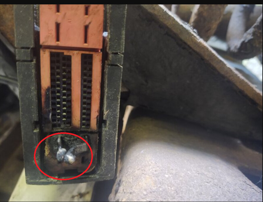

It was pretty close to it, when I pulled it apart, it was still smoking.
Oct 9, 2022 at 5:07 PM
AL514
  • 5,464 POSTS

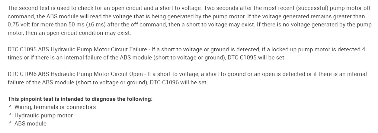

Wow, I've never seen an ABS module burn up like that. A first for me, but I've learned over 20 years that anything and everything can happen with vehicles. If it were that bad, I would really consider possibly changing the ABS module connector, The pins have been greatly overheated as well as the connector itself. I can see in the picture those larger pins are for higher current flow for the ABS solenoids in the hydraulic section of the module. Those pins are cooked, and that connector is no good either. I'm really surprised this didn't blow a fuse, it should have. I'll take another look at the ABS wiring diagrams and see why it didn't pop a fuse. It looks like there may have been a water intrusion issue there.

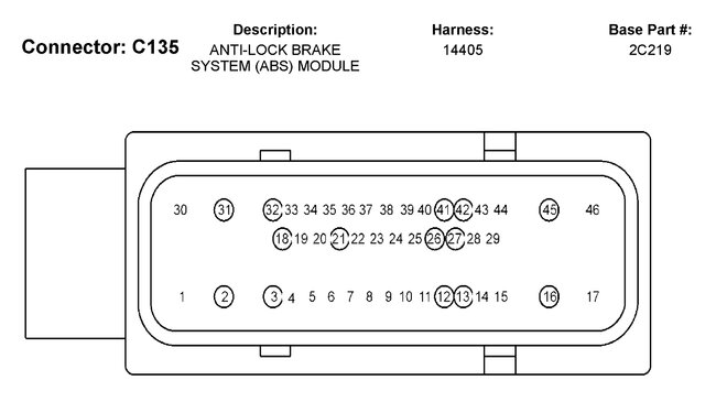

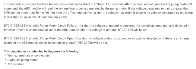

Okay, some service info is saying the hydraulic pump and the module are all one unit and some other info is saying the module (the electronic section) and the hydraulic unit can be replaced separately. So, obviously that information is useless. I just don't want to see you replace the computer just to have it turn out to be a shorted-out ABS pump. There are a couple of different codes it would have set for a shorted pump
You don't happen to remember the original codes you were getting before all this started do you? Were they just wheel speed sensor codes? Because the info here is saying the module runs self-tests on the pump to determine its condition and with this type of failure it should have disabled the ABS, the large pins also look like large ground pins that melted. The third diagram below are the codes for a failed pump. And of course, there is a flow chart for checking the pump which we can't do because of the connector and module failure right now.

I am replacing the connector along with the module, it's pretty fried also. I truly appreciate all the help.

Okay, hopefully your scan tool is able to bleed the ABS unit, I see it had the ABS option on there. Most ABS units need a scan tool these days to bleed the hydraulic control unit and pump. Here's the wiring diagrams for the unit, I would take a look at the fuses that feed the ABS module, just make sure the fuse legs are not brown from being over heated. A couple of them are 40-amp so it's a pretty high current circuit. Also included is the connector and the pinouts in case you need them, clear any codes that might be stored as well. Hopefully everything will be good from here on out.

I will definitely check the fuse legs, thanks for the additional info. I checked the wiring in the harness for being brittle from the overheating, and all the wires seemed very pliable, so I'm thinking that the harness is in good shape.
Oct 9, 2022 at 8:04 PM
AL514
  • 5,464 POSTS

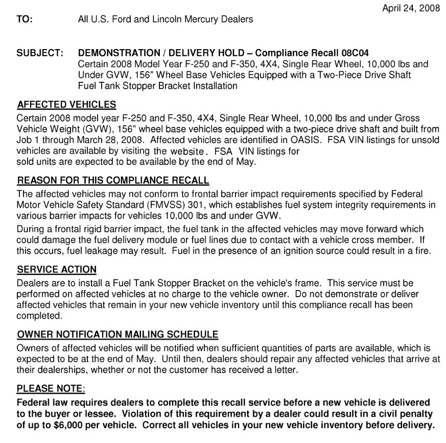

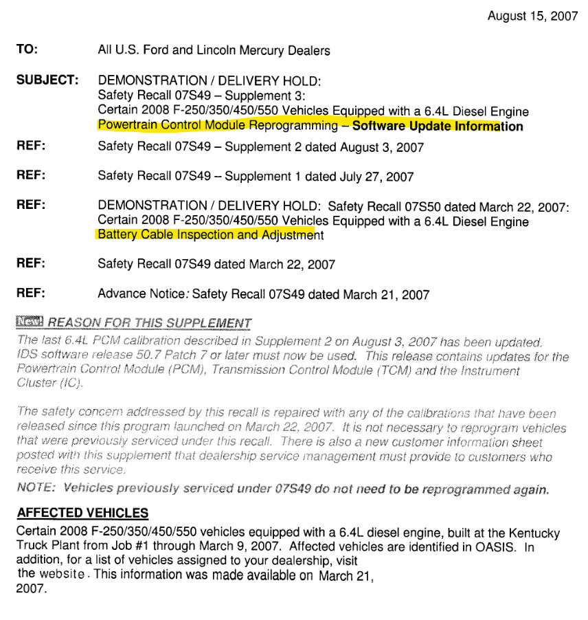

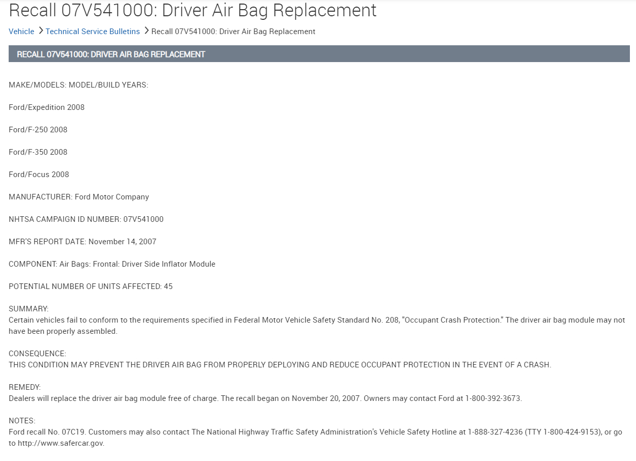

That's good, but definitely change out the main connector, those female pins in the connector will never make a good connection again. Those 40-amp fuses are the reason it didn't pop a fuse. I think whatever happened in that connector happened pretty fast.

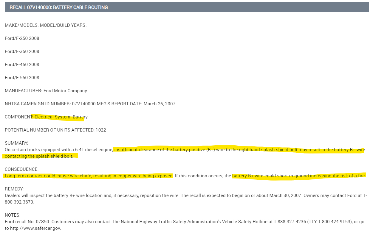

Here are some Recalls and important updates that may not have been done already. These are the ones that have to do with safety, which is why I'm posting them. There's always a list of TSBs a mile long, but you should at least know about these. Pages 1 and 2 go together and also 7 and 8. There are quite a few about that battery cable routing that there were actual repair notices about. Just things to keep in mind... Stay safe.

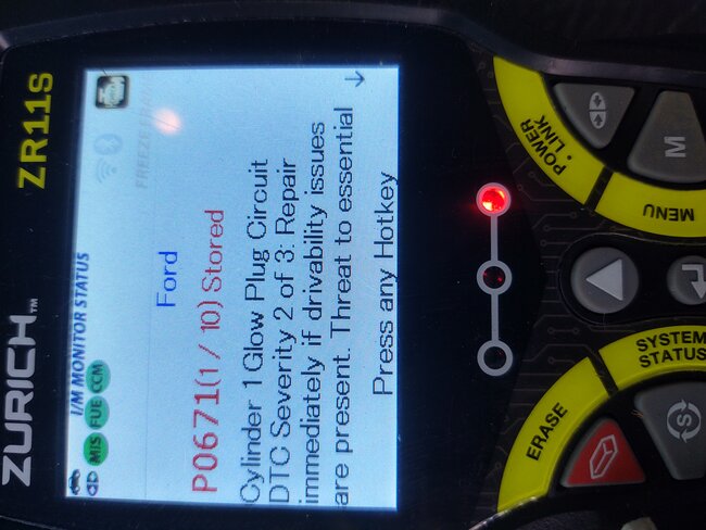

HILLY59
  • 23 POSTS

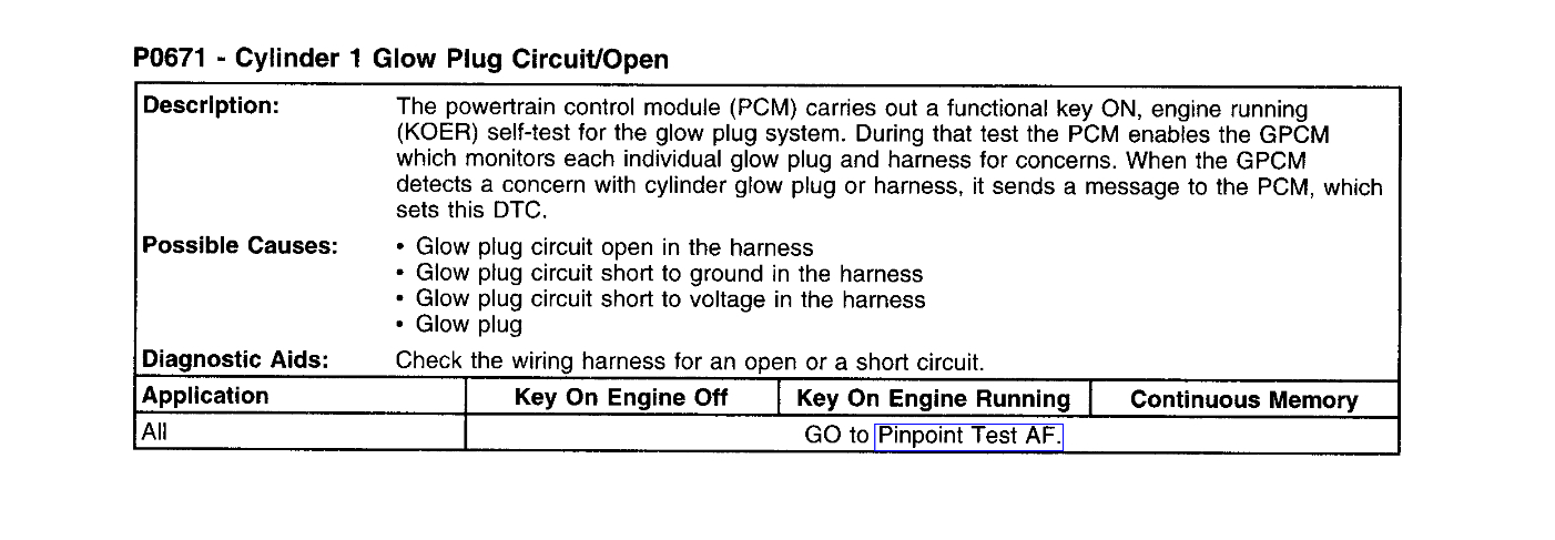

This is the only fault left, I took the fuse out because I desperately need to use my truck tomorrow, will I be okay?
Oct 13, 2022 at 2:55 PM
AL514
  • 5,464 POSTS
Which fuse did you remove? I'll look up this code, I'm not too familiar with the newer diesel setups, it's not often I see them, but the glow plug was usually used at cold start up, since a diesel doesn't have a spark plug and relies on very high compression pressures and heat to ignite the air fuel mixture, I would assume that once the engine is hot enough ignition will start in that cylinder. The reason it's a two out of three severity is because of the exhaust system, and the DPF, which is the diesel particulate filter and the oxidation catalytic converter. These can be damaged if raw fuel is entering the exhaust due to cylinder misfires. This is the same on a gasoline engine. A cylinder misfire causes the unburn oxygen and fuel to exit the cylinder and because of the temperatures of the converter this air fuel mixture will cause the converter substrate to melt down into one solid ball and block off the exhaust. Or the substrate breaks apart and ends up everywhere throughout the exhaust, either way it's a catastrophic failure. The only other thing you can do is to unplug the fuel injector to that cylinder, and you'll be running on seven cylinders instead of all eight.
I guess it depends on how long you'll be driving the truck tomorrow. My other concern would be damage to the glow plug driver module. A circuit pulling too much current can fry a driver for that circuit, same as a fuel injector. So those are the risks.
These are high voltage fuel injectors too and require a disconnect tool to unplug the electrical connector, so that does not look like an option.

Okay, I don't see any fuses labelled glow plug, I do see fuse 27 and 47 50amp going to the glow plug control module. I'd think that's probably for bank 1 and bank 2. Here are the fuses for the ABS module so you have them. You didn't find any of them blown?

I pulled 27, I'll pull 47 in the morning.
Oct 13, 2022 at 3:54 PM
AL514
  • 5,464 POSTS
You only have to keep 27 out, that's the bank 1 for the number 1-cylinder glow plug. That's cylinders 1, 3, 5, and 7. So, you're good.
