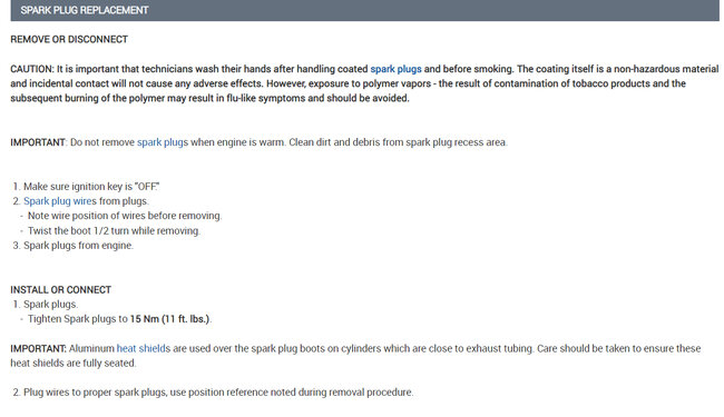

Error P0304-- misfire on cylinder 4. In checking this error with my local auto parts store, I was offered a single spark plug for a replacement, but since the old rule is to replace all plugs at the same time, do you recommend I replace all six plugs? (Of course, I can diagnose with only a single plug to determine whether it makes a difference.)

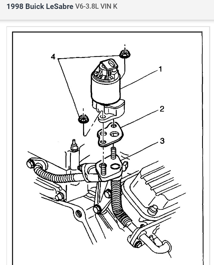

Error P0404-- EGR open position performance
Error P1404-- EGR closed position performance

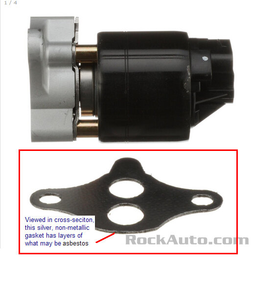

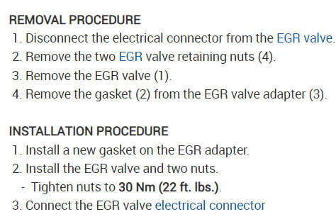

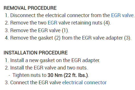

On these errors, I was puzzled, since the EGR valve is indicated both stuck open and stuck closed, Possibly, the valve is so dirty, it will wander slowly between open and closed. A new replacement valve is somewhat expensive, so I would prefer to take the valve assembly apart, and clean it like a dirty carburetor, with carb cleaner spray and small, stiff brush. Will that work? Do you recommend an overnight "soak" in cleaner, and if so, what cleaner?
