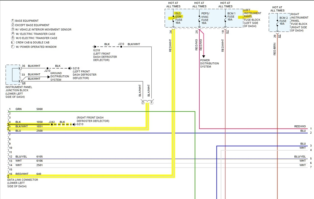

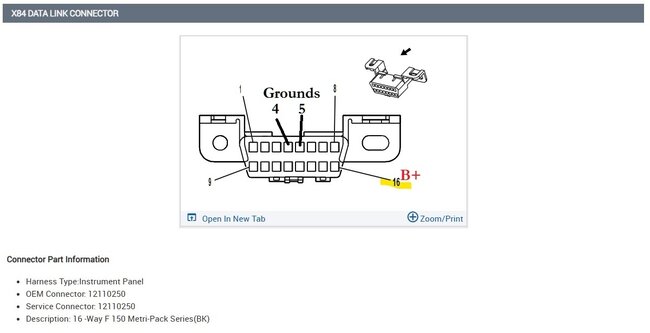

Failed inspection because there is no power to port so can't do MA emissions test. Contacts look good, auxiliary power ports have power (including cigarette lighters). Thinking it is a blown fuse, but I do not know which one.
