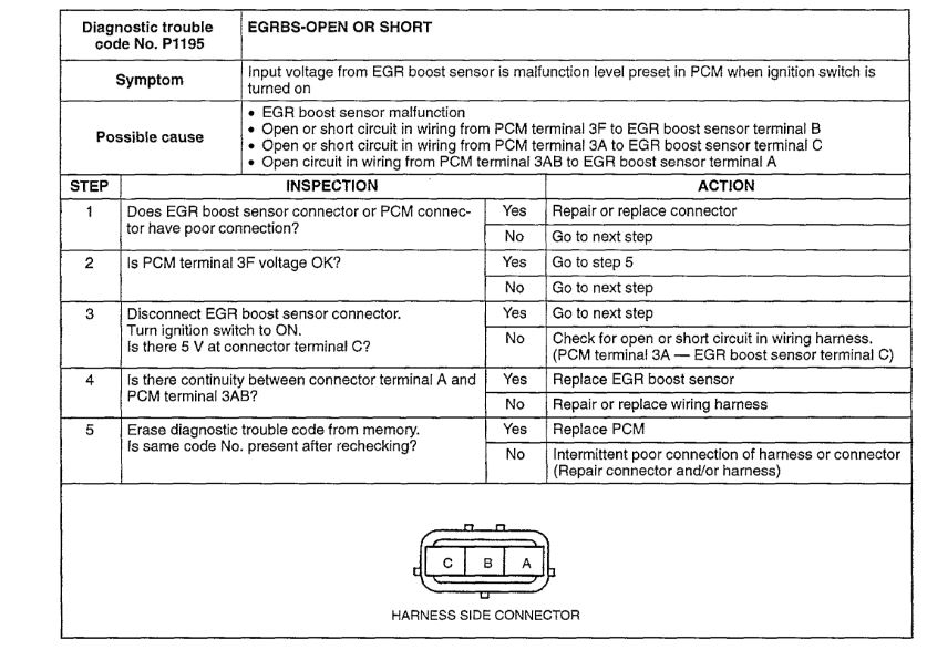

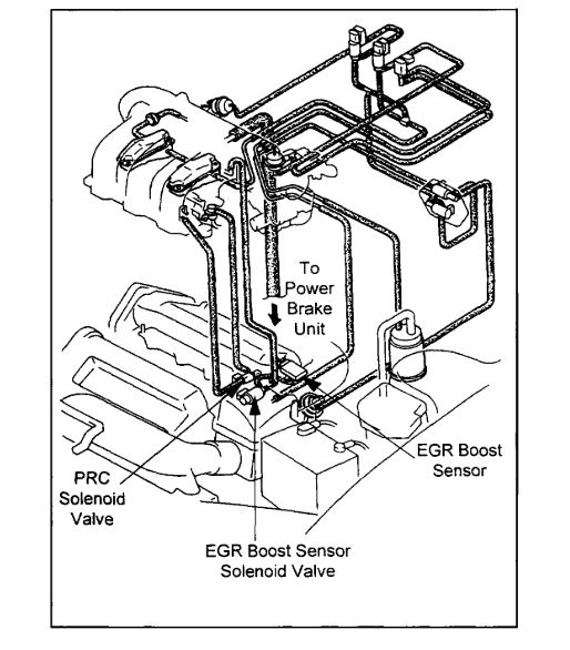

I attached a TSB on the 1195 code. Follow the TSB for the hose routings.

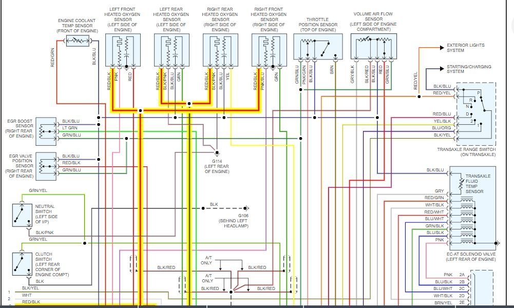

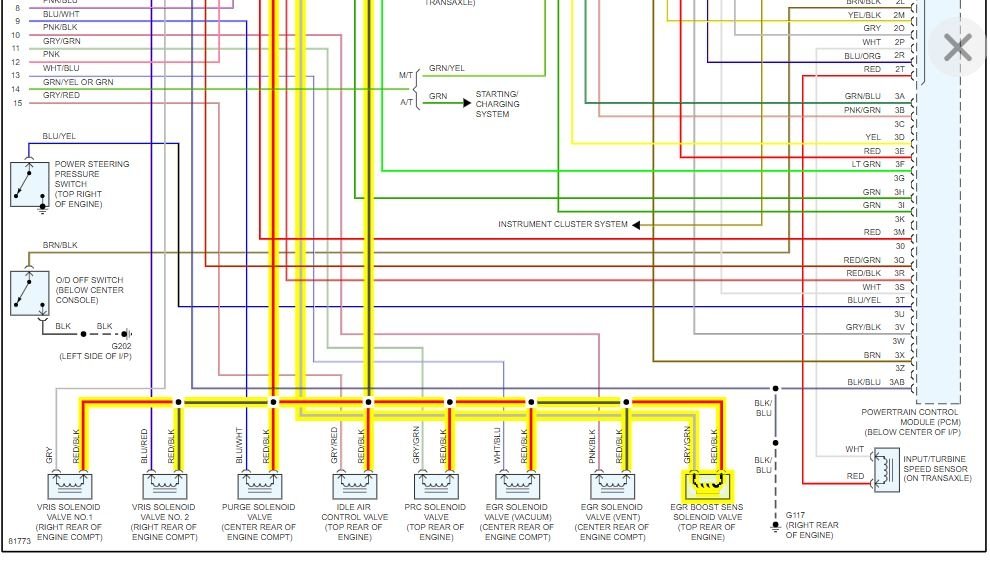

I also attached a wiring diagram of the boost solenoid as well. I would verify power to the solenoid with the key on.

1. Verify that all vacuum lines are properly routed, not kinked or twisted.
If properly routed, not kinked or twisted, proceed to step 2.
If not properly routed, repair and proceed to step 4.
2. Locate the PRC and EGR boost sensor solenoid valves on the right side of the air cleaner housing.
3. Verify correct connector placement at the PRC and EGR boost sensor solenoid.

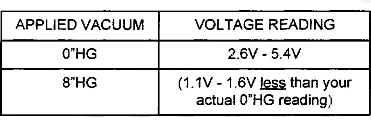

Use a vacuum pump and apply vacuum to the EGR boost sensor according to the table.
5. Record the voltage. Refer to the table shown.
If the voltage readings are not within the specified range replace boost sensor and proceed to step 6.
