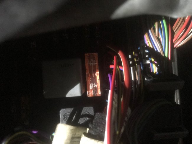

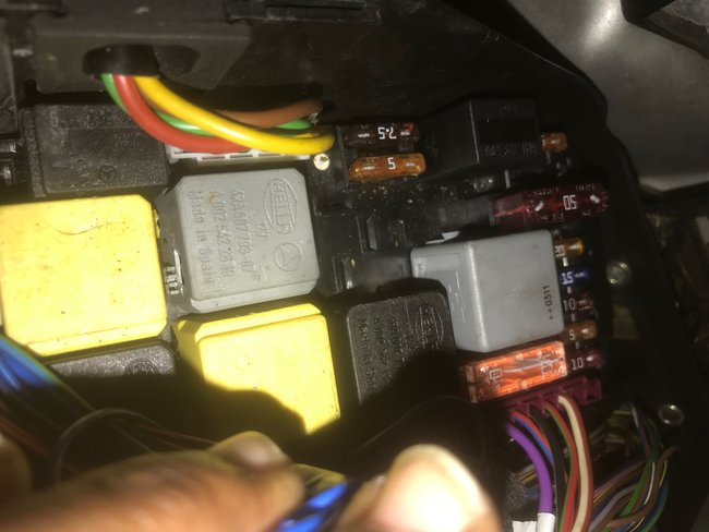

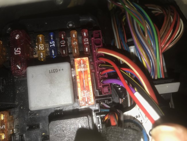

Having issues with the car listed above i bought.

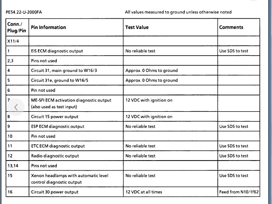

I took it to a shop to get it repaired and they couldn't check to see anything because the OBD2 sensor wouldn't power on. I was having this issue before so i previously checked all the spark plugs and all of them looked okay, no issues found. What should my next steps be?

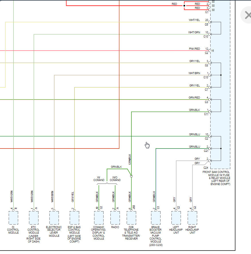

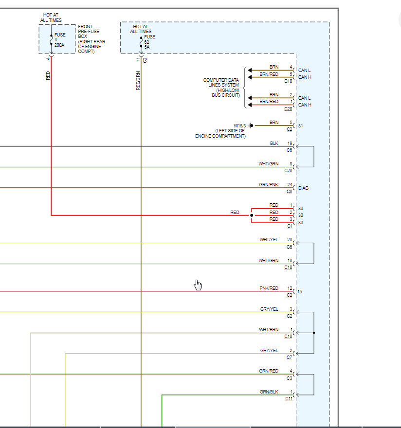

Also, does anyone have a copy of the wiring diagram for the car?
