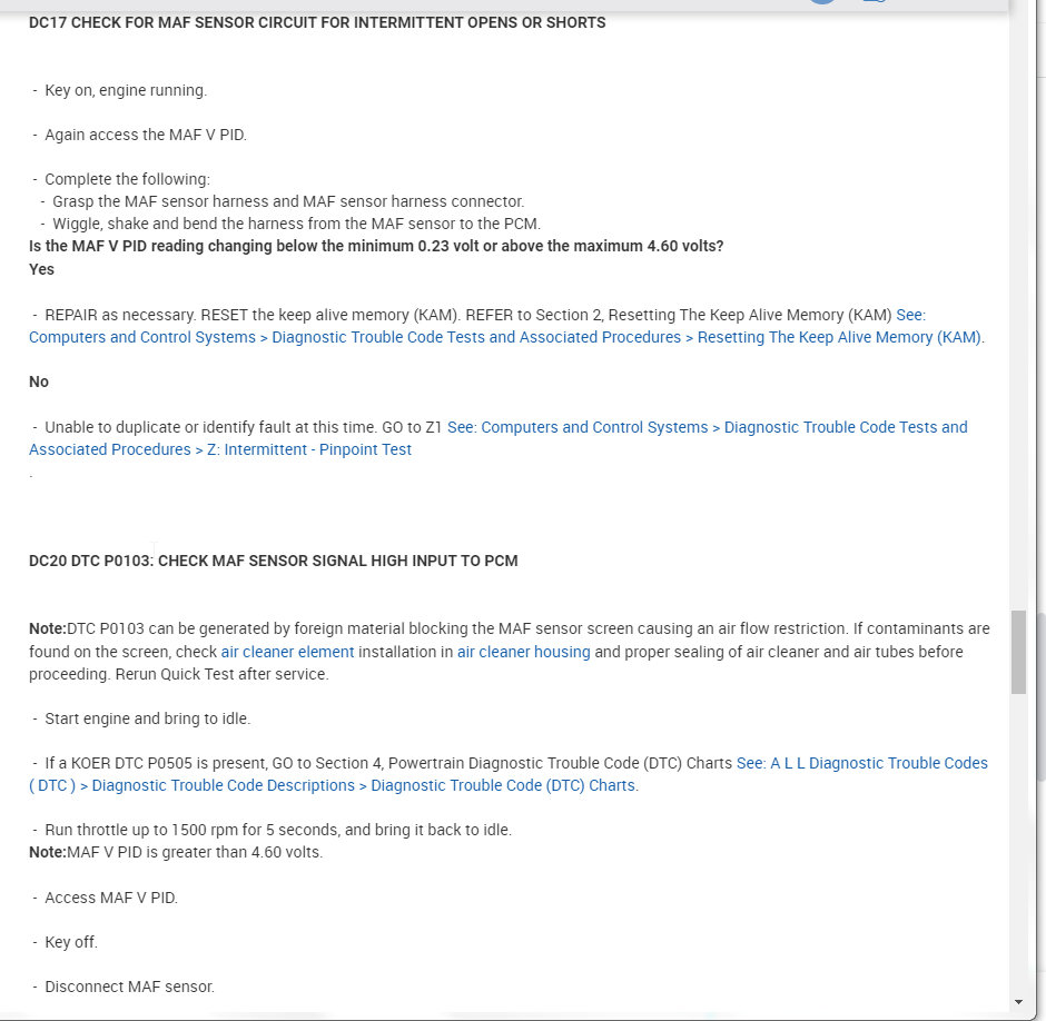

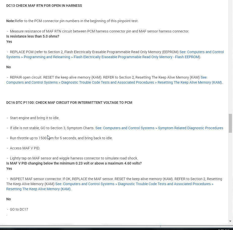

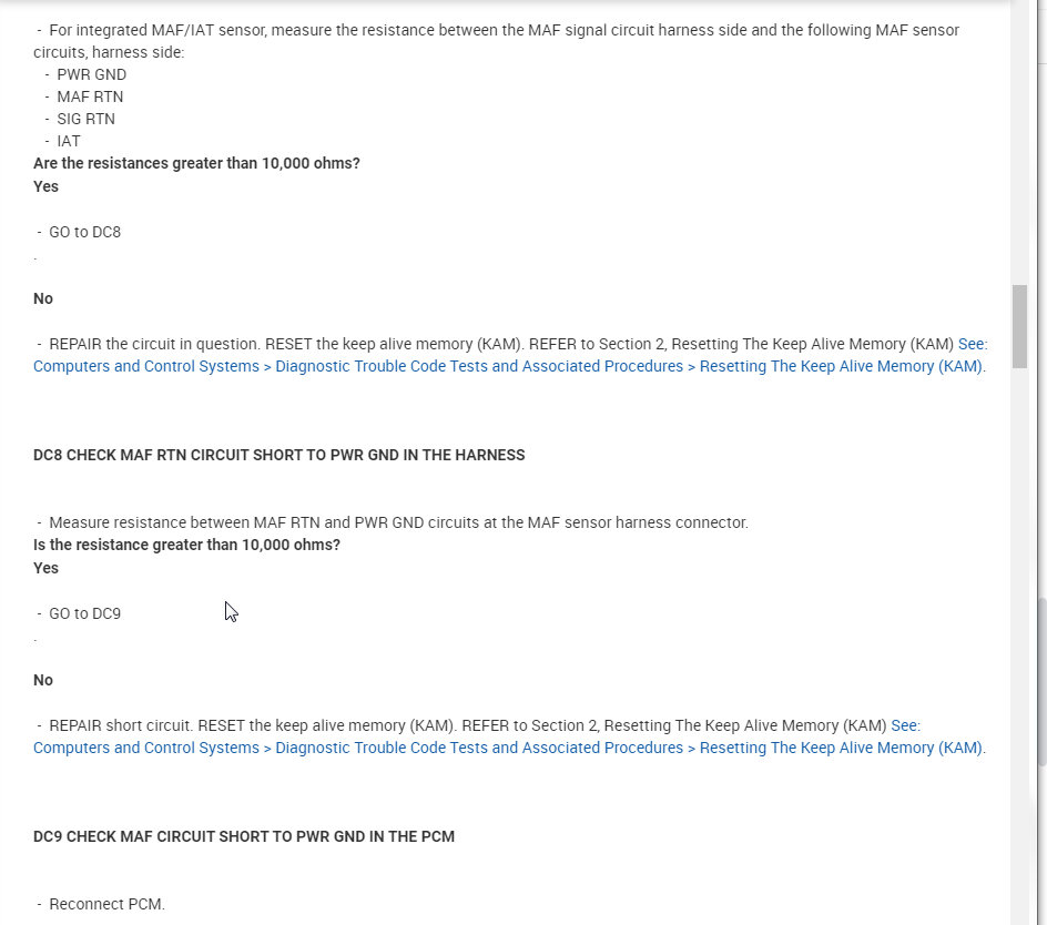

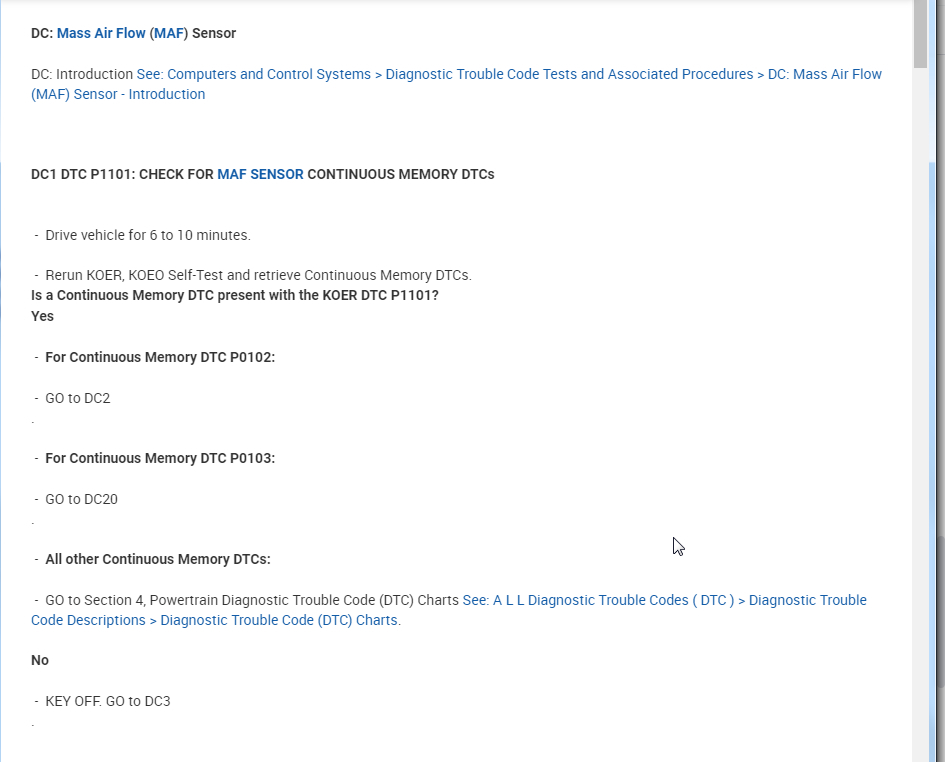

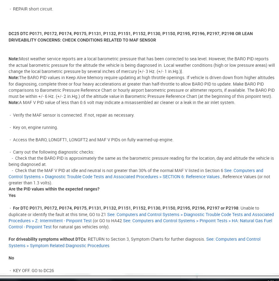

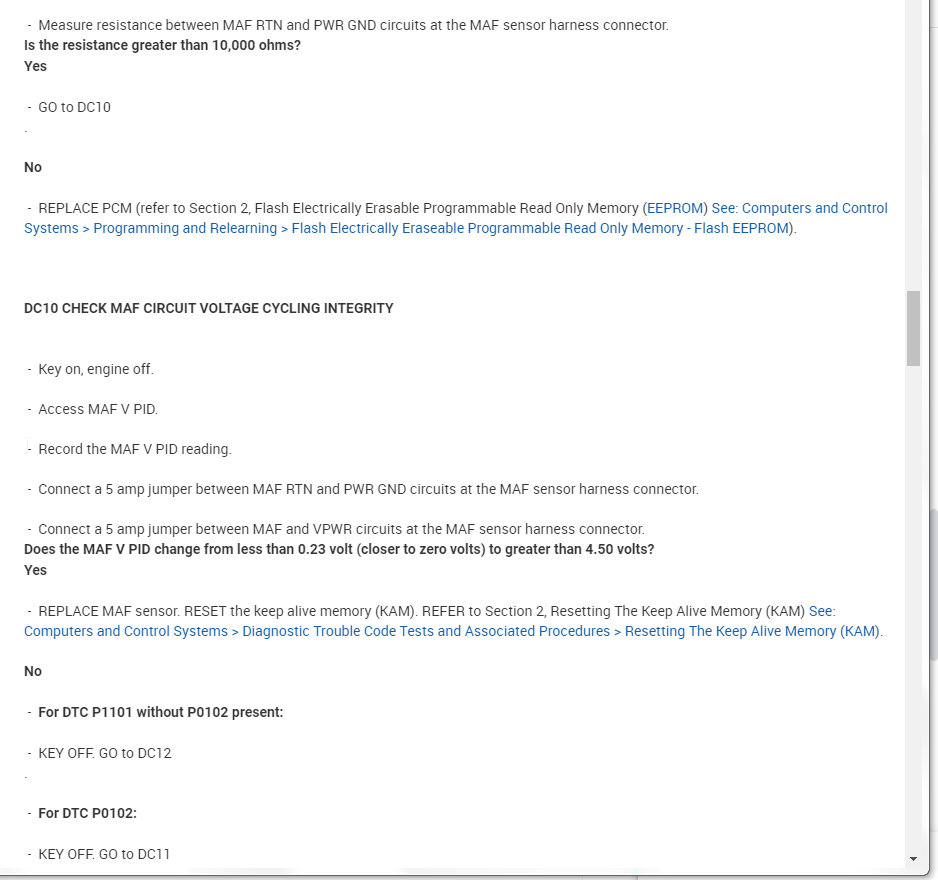

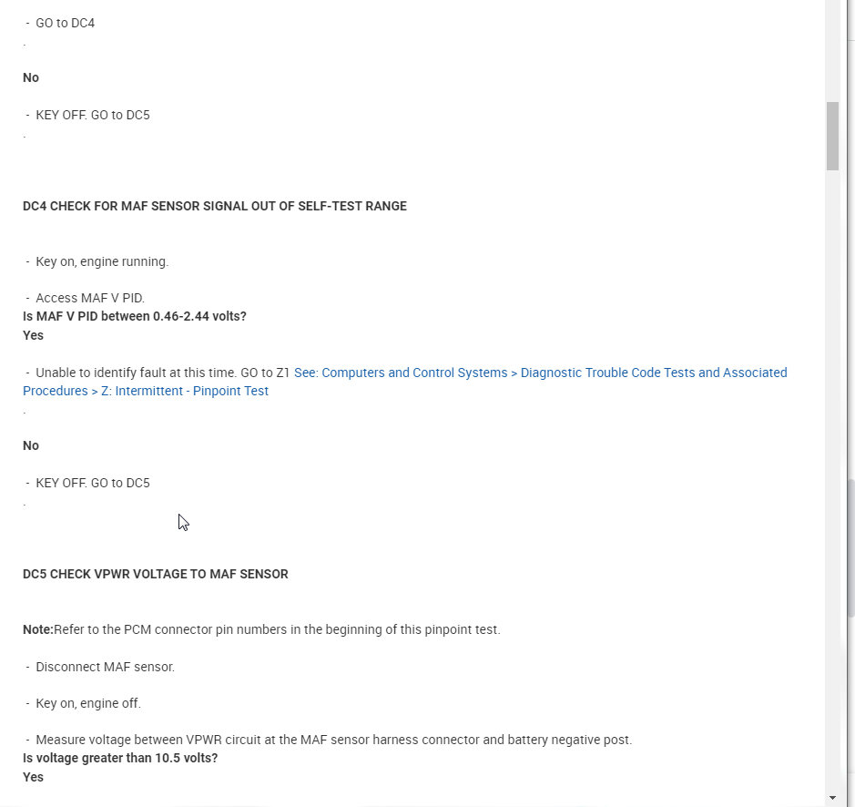

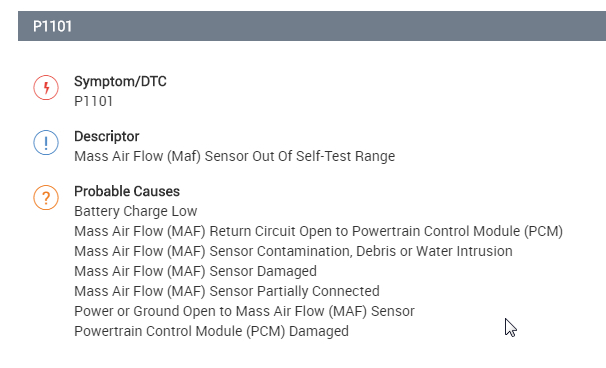

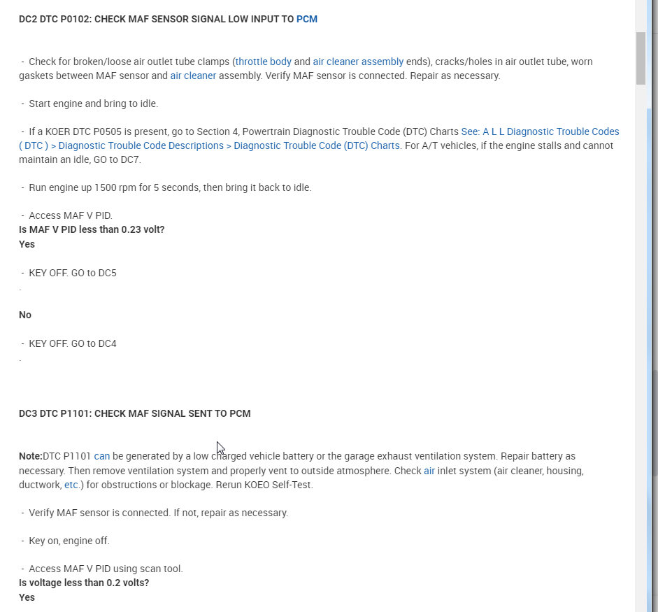

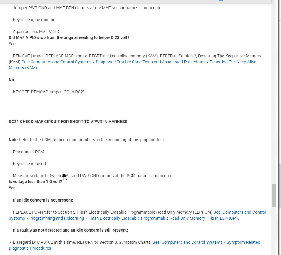

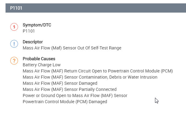

Is there a chance that code is P1101? Ford just doesn't use P0101 but that is a typical mass air flow code.
I just want to make sure we get the correct diagnostic info.

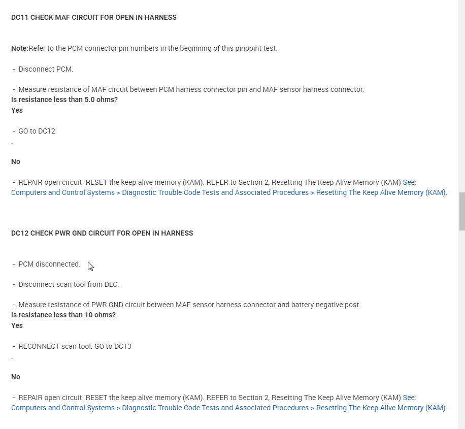

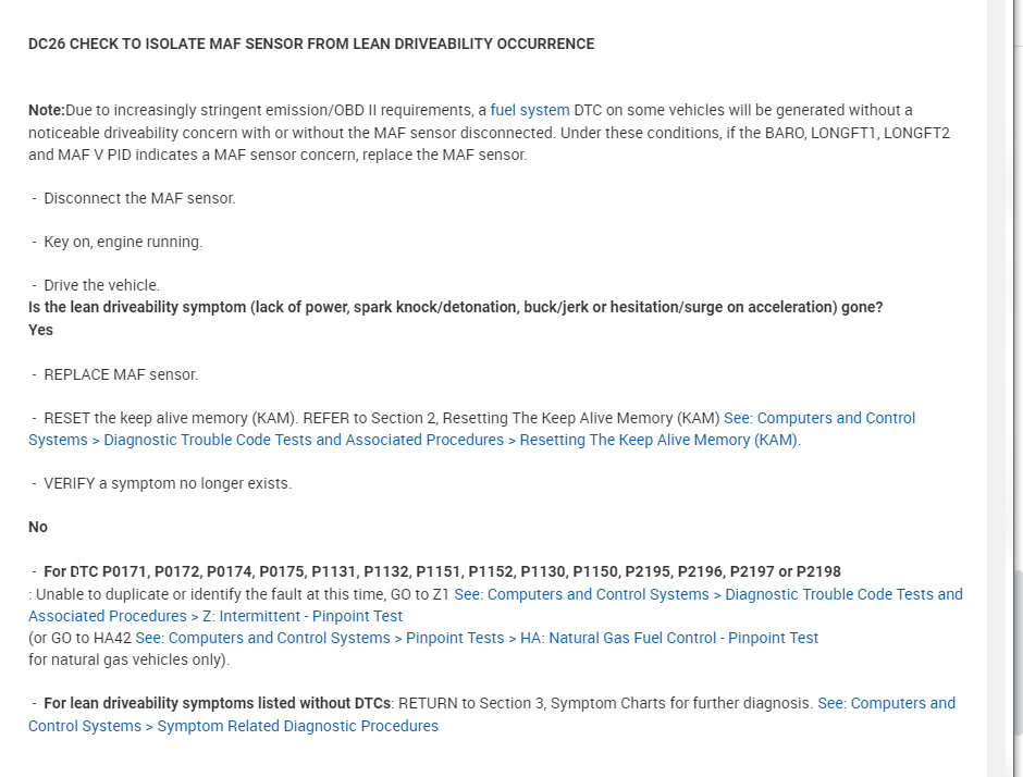

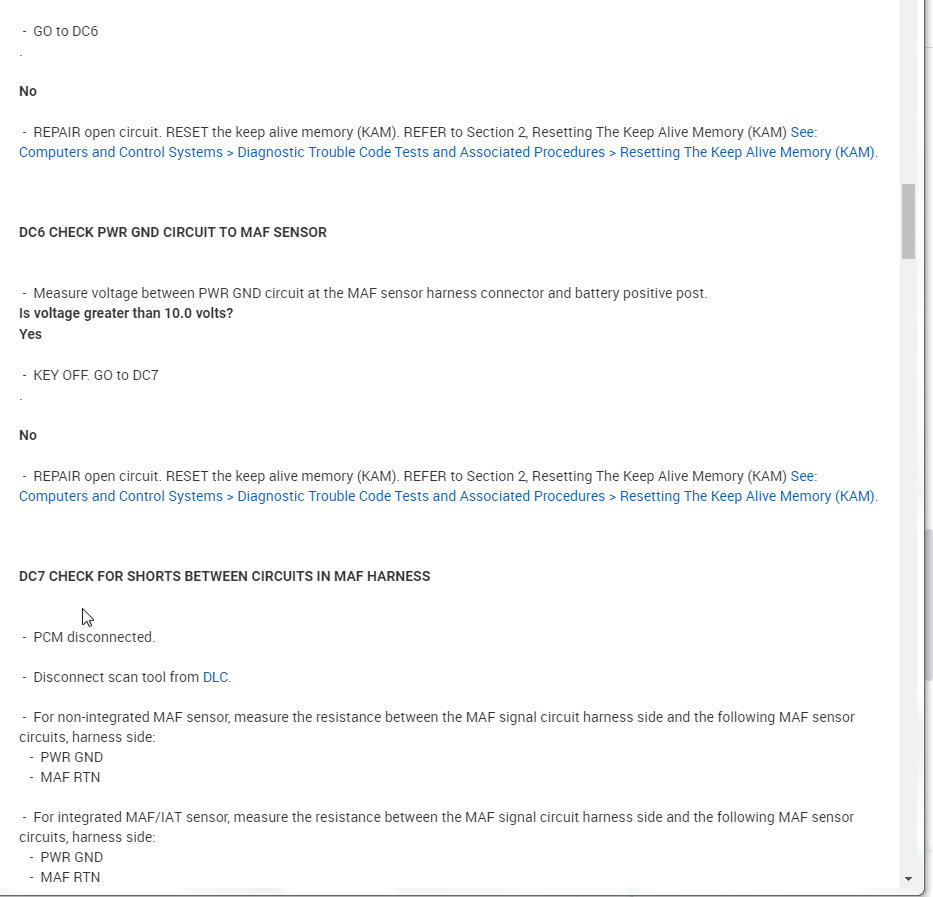

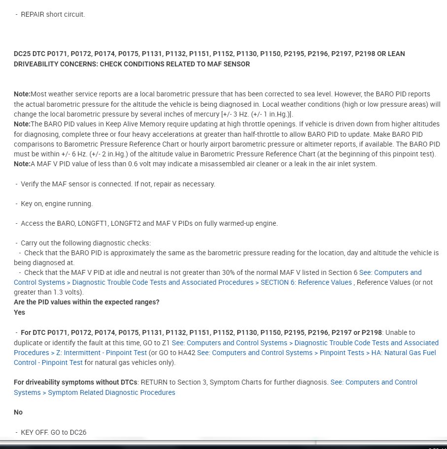

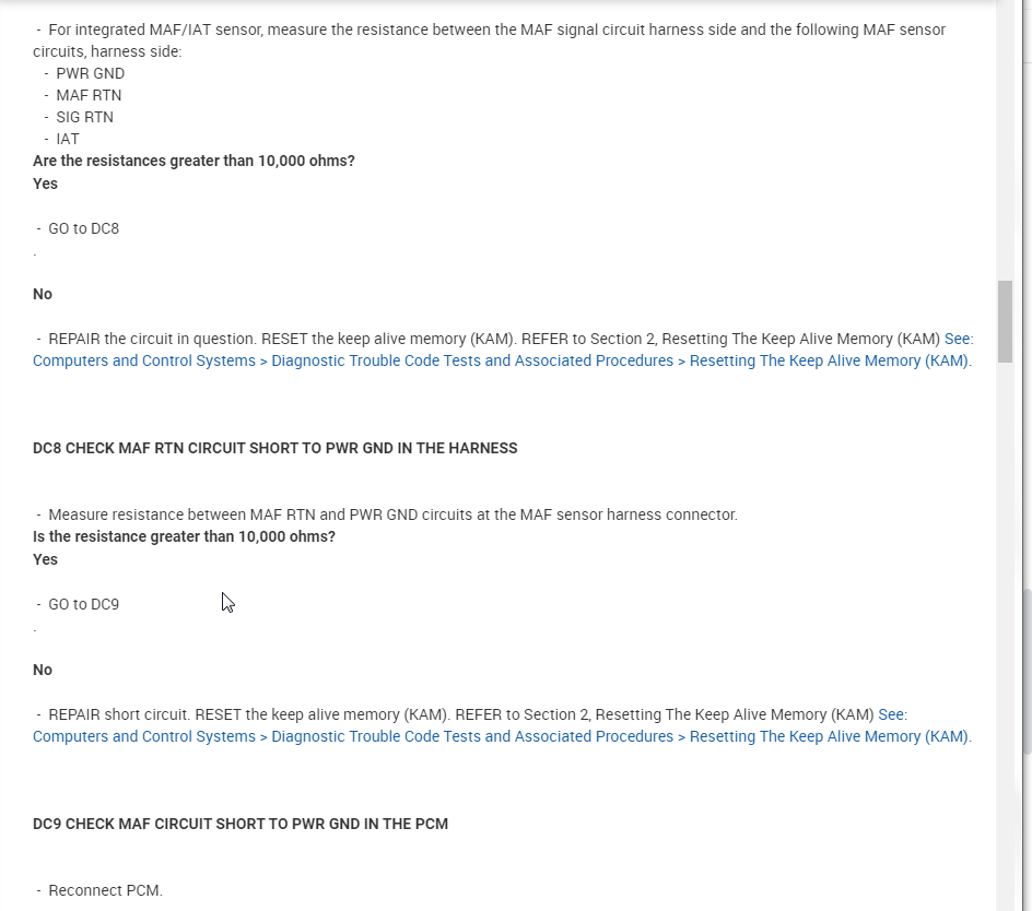

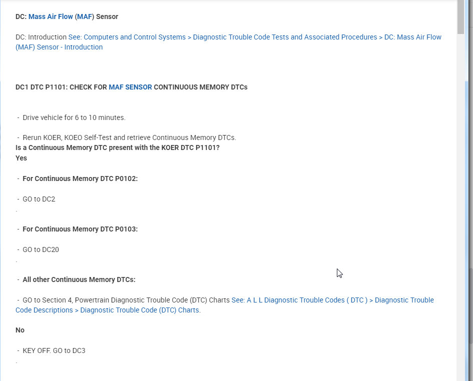

Here is the testing for the P1101. Just let me know what scan tool you were using as well. That may be the reason it is pulling the P0101. If that is the case, then let's just use this test. Thanks
