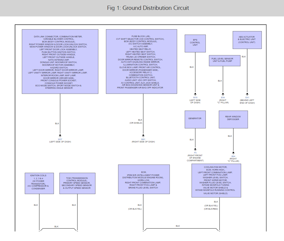

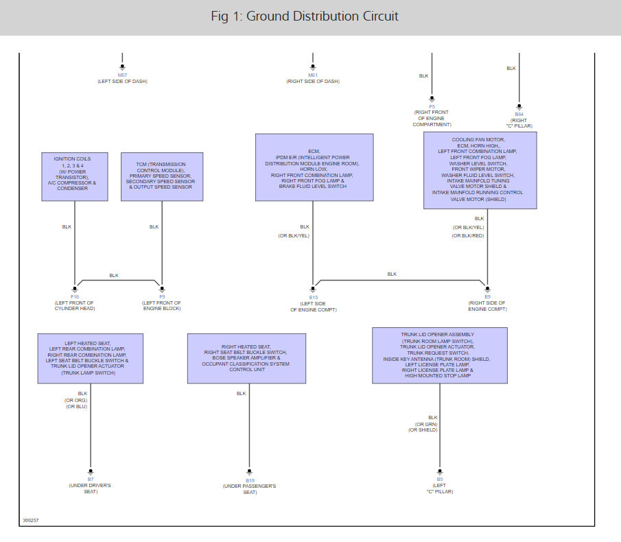

I would check all of the engine grounds to make sure they are connected, then I would clear all codes and then turn the key on without starting the engine to see what comes up. If any these will be the codes, we address first. Let me know. Here are the ground locations in the diagrams below.

I Will send video tomorrow I'm dumb as a box of rocks when it comes to this. Sorry. No grounds found loose and cleared codes. Getting four codes: intake Air 2 codes camshaft sensor and last code Manuf. Control. Just like my original question but three less codes. Could one sensor being bad be causing all of this?
Jul 14, 2022 at 5:44 PM

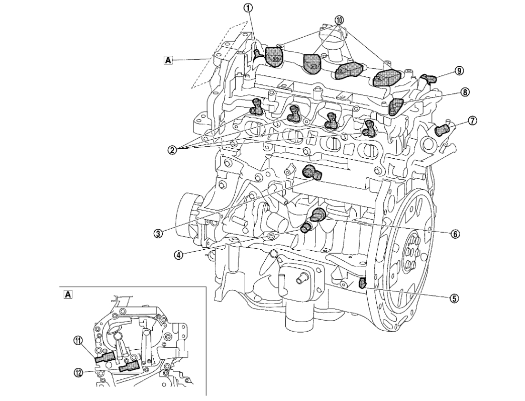

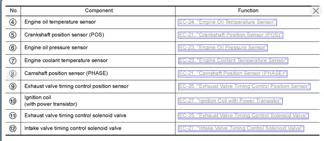

I wouldn't know on that, but I do know the motor came out of a wrecked Sentra from a repeatable salvage yard here. That's where I bought the engine. I bought a camshaft sensor sometime back, but I haven't put it on yet + I still got the old engine that has all the sensors on it. If my memory is correct the cam sensor is behind the starter. I may start there and start changing sensors until I find it.
Jul 15, 2022 at 11:09 AM
Yep, that is a good idea here is the location of the camshaft and crankshaft sensor in the diagrams below. Check out the diagrams (below). Please let us know what you find.
