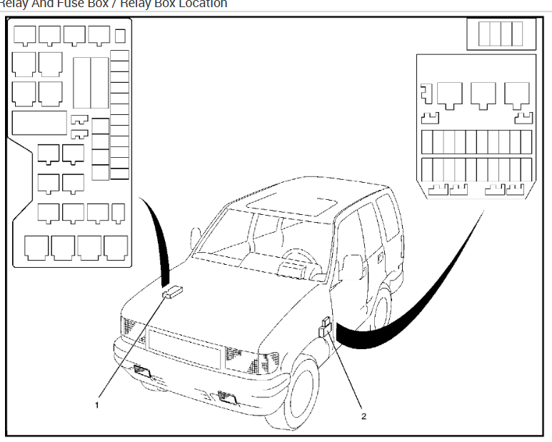

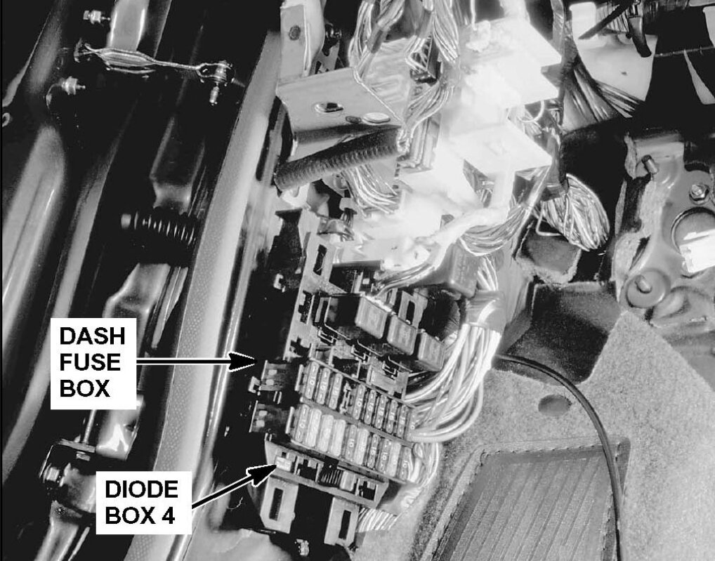

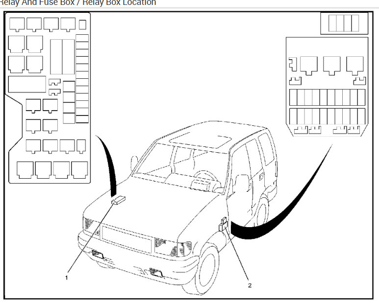

Flash code method - but only if it’s the early OBD-II hybrid setup. I would turn the car on, engine not running and check all of the other fuses especially to the PCM.
Aug 3, 2025 at 1:39 PM
JAI287
Would you know which fuses that would be that I'd have to check?
Aug 3, 2025 at 4:36 PM
Yes, the FL-3 ECM fuse under the hood, and the c-8 engine fuse c-9 IG coil fuse and the c-4 elec-ign fuse in the fuse panel under the dash. This guide can help.
Check out the images (below). Let us know how it goes
