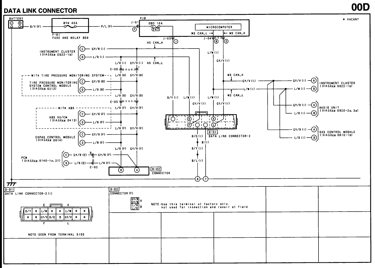

Checked all fuses an they are fine. Went to emissions had a no communication error. Car runs fine starts great an had no issues except low beam lights would not turn off. Have any ideas? Thanks

Diagram shows there is a 10 amp fuse. So check fuses in the engine and cabin area. A quick way to check there is power is by connecting a scan tool and do an OBD2 read out. If your scanner powers on then fuse is good. If your scanner communicates then the problem will be with the sh0ops machine.
