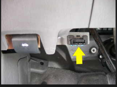

I cannot find where to connect my meter on the truck listed above.
Jul 26, 2020 at 10:38 AM
DANNY L
CERTIFIED EXPERT
5,648 POSTS
Hello, I'm Danny.
If you're looking for the OBD port to connect a scanner or code reader these are the 2 possible locations.If your truck has OBD1 it's located under the hood on left hand side on top of the fender well.If your truck has the newer style EECLL or otherwise known as OBD2 it is on the lower left of the dash about knee level.
Thank you very much, I found it. You are a very nice person.
Thank you, Mike Hammons

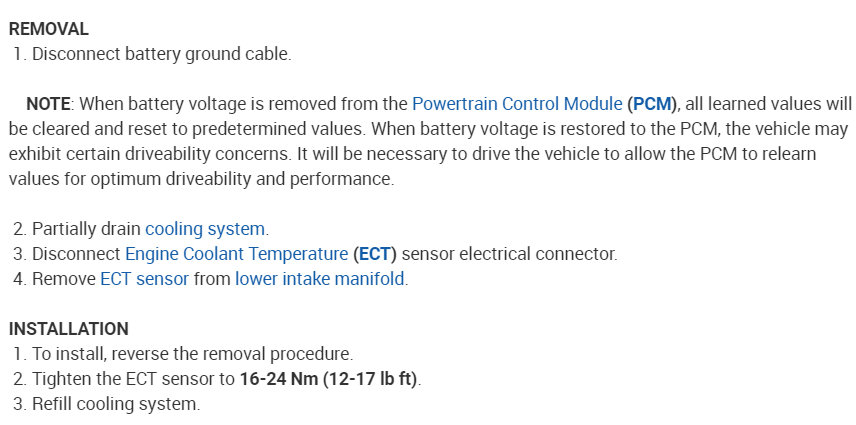

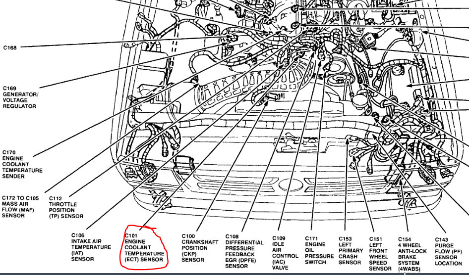

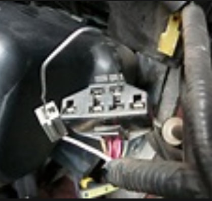

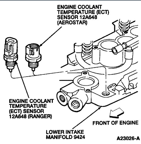

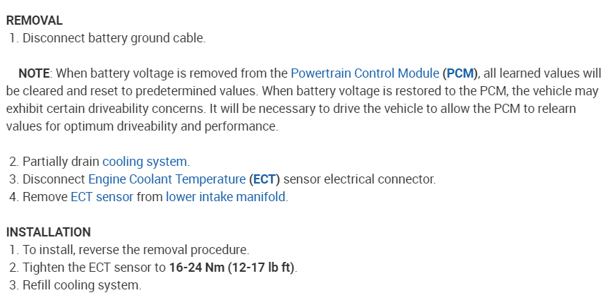

Since your truck you say is running at normal temperature but the gauge shows hot it's possible the ect- engine control temperature sensor is faulty,defective, or showing an incorrect reading.Here are a few tutorials to view for its description and replacement:
I've attached pictures below of its location and steps on how to replace.Hope this helps and keep us updated on this issue.Thanks again for using 2CarPros.
