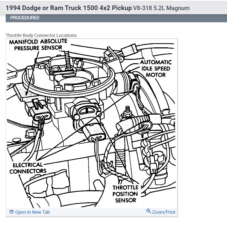

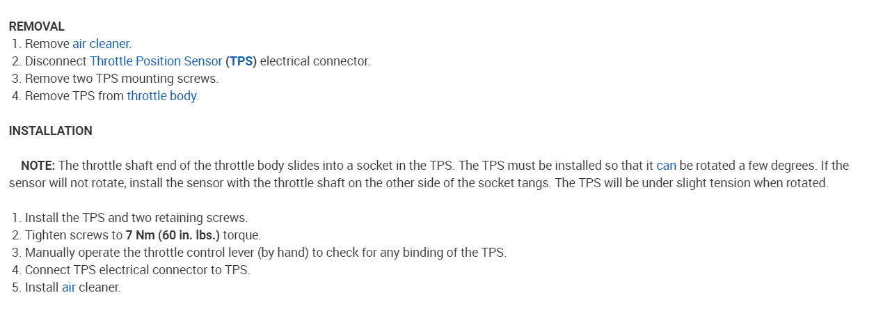

I would replace the TPS sensor and then disconnect the battery to clear the codes to see what happens.
Here are the instructions in the images below. Check out the images (below). Please let us know what happens.

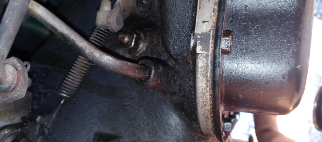

Could this be it behind the linkage spring, there's no connector on it possibly broke off?
Oct 9, 2022 at 5:13 PM
It is difficult to tell from this picture. I see a spring and the transmission linkage. Did anything change when you installed a new TPS, did you clear the codes and drive it?

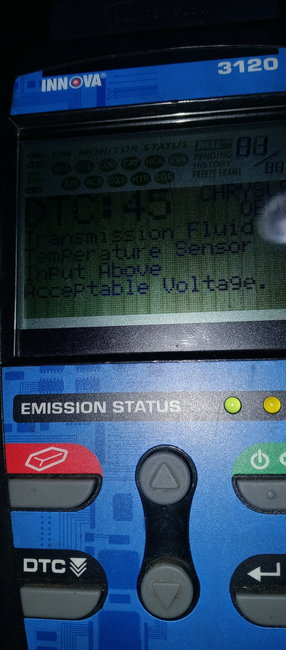

Yes, and it says transmission fluid temperature sensor above voltage, is it the brassy bolt plug behind the spring on the transmission above the pan?

Above the cooler line, may the connection end got broke off or wrong one installed?
Oct 10, 2022 at 2:37 PM

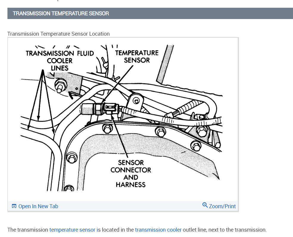

No that is not it, the part you are seeing is to adjust the bands inside the transmission. here is the location of the sensor you need to change out.
The transmission temperature sensor is located in the transmission cooler outlet line, next to the transmission.

Check out the images (below). Please let us know if you need anything else to get the problem fixed.

I'm stumped. It's not there and 46rh transmission has no electric governor pressure sensor.
Oct 13, 2022 at 8:21 PM
Yep, thats a good one, you have the code but no sensor that pertains to it. I think you are right the vehicle has a mismatched PCM or the wrong transmission is installed.
