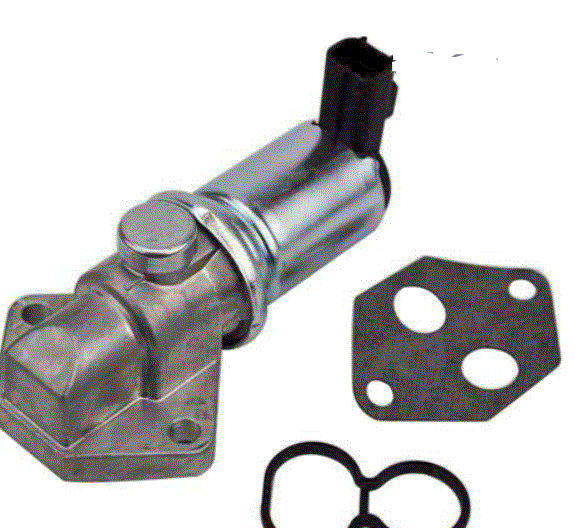

Based on these codes, I suspect you are having a higher than normal idle speed. Is that correct? Have you checked the idle air control valve, (IAC), on the throttle body? Here is a link that explains how it works:
https://www.2carpros.com/articles/how-a-idle-air-control-valve-works
If you look below, I attached a pic or an IAC. On the vehicle's throttle body will be one that looks similar. You may want to consider trying to service it. Here is a link that explains how it's done:
https://www.2carpros.com/articles/idle-air-control-valve-service
See pic below.

It is possible, but if it is allowing too much air to enter, I would think you would have a higher than specified idle speed.
Regardless, I would try to service it. When you remove it, make sure where it mounts is clear of carbon.

No problem whatsoever. Let me know how things turn out for you. Also, when you replace the IAC, make sure there isn't carbon or anything blocking the air passage where it goes on the throttle body.
Let me know if that takes care of the issue.
