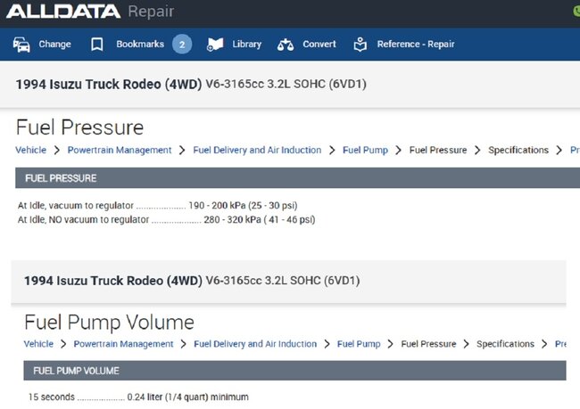

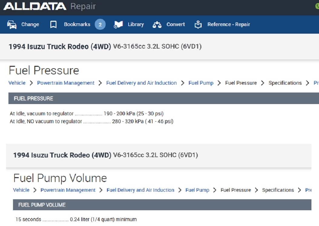

Okay, I'll just check Ignition timing first, Fuel Pressure 2nd. Do you have the specs? 94 Isuzu Rodeo 4x4 . Thanks

Remember, the spec for timing isn't the issue. You're looking to see if it's bouncing around or cutting out.

So, I check everything today. The fuel pressure was within spec. When I hooked up a timing light it only bounced around like 2 degrees. By the way this motor has no distributor, Just 3 coils. Anything else I should check? Thanks.

By the way, for fuel pressure, be sure to not just look at the pressure. Watch what it does as the engine is slowing down and when the rough running occurs. You may need to drive the vehicle with the fuel pressure gauge clipped under the right wiper arm so you can see what the normal range is at different engine loads. Some engines, GM truck engines in particular, are very intolerant of fuel pressure just a few pounds low. Others, like on my '88 Grand Caravan, can drop from 45 to 20 psi and still run fine with no symptoms. It finally started to sputter at 15 psi. The pressure dropped over about 20 seconds when pulling a huge trailer, and the pickup screen in the gas tank was plugged. I started to describe that in a previous reply. That engine was very forgiving of low fuel pressure. Those are two extremes, but all engines will start to misfire at some point as the pressure drops.
