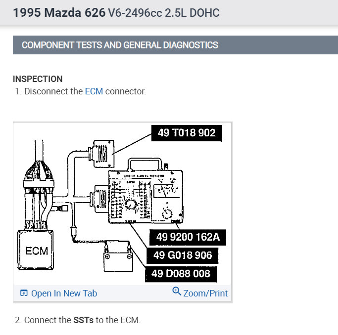

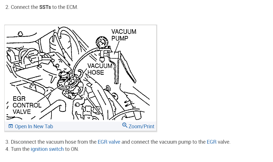

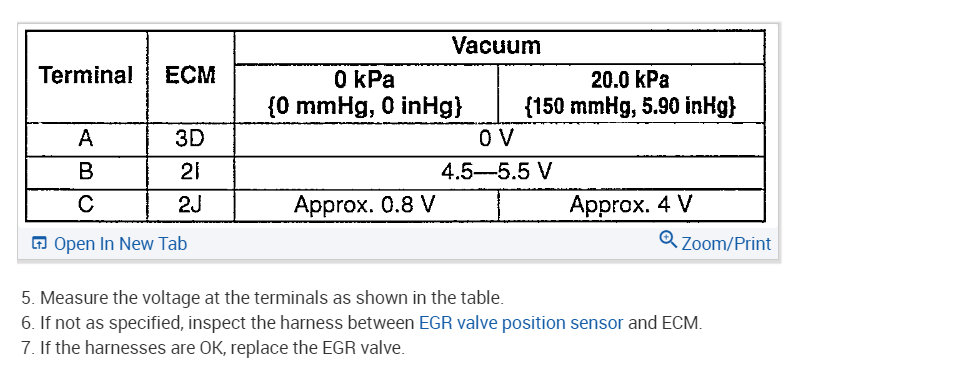

Yep, that could be, here is how you can test the sensor to confirm the failure.
Aug 15, 2022 at 11:31 AM
