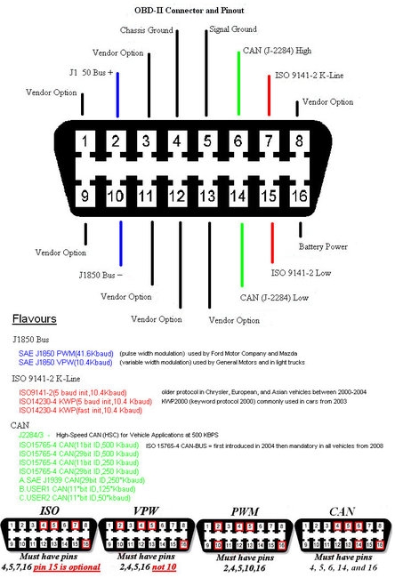

What is the scan tool you are using? Some have very limited or no coverage of European makes. Or it is possible the power fuse for the port has blown. Check pin 16 for battery voltage and pins 4 and 5 for ground.
