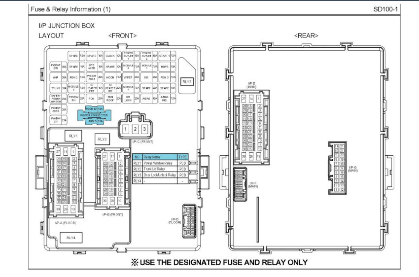

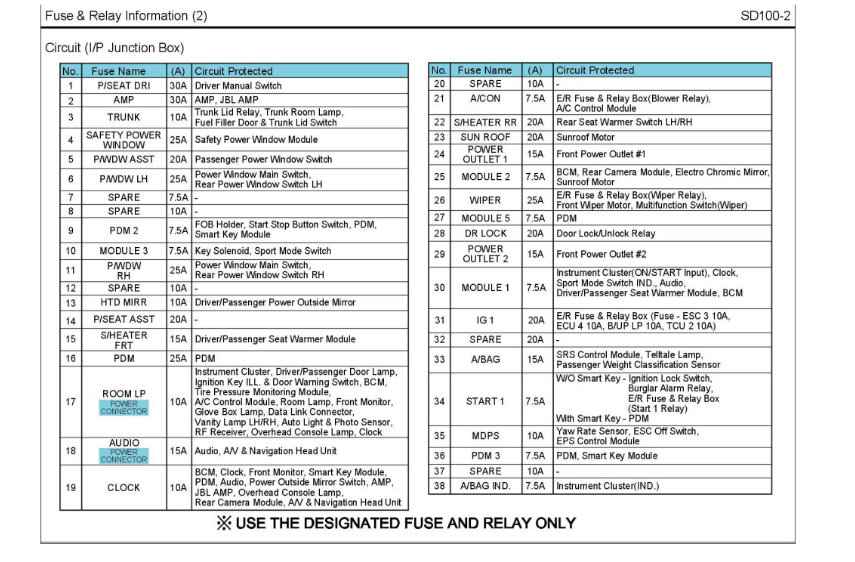

OBD port is not functioning, check engine light came on and went to go pull code and nothing is reading.
Overhead lights non functioning along with all locks will not work with key, the list seems endless.
