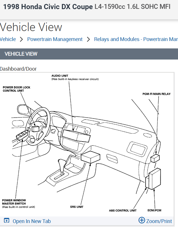

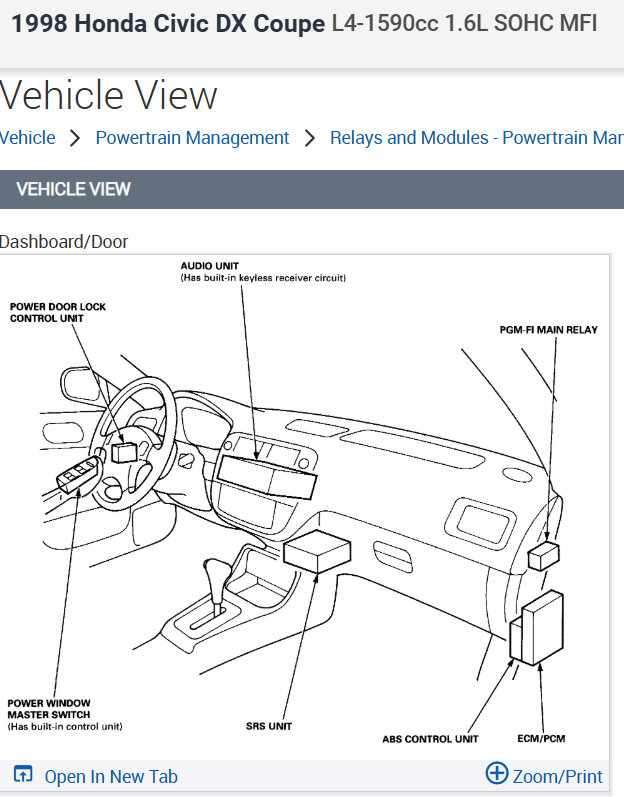

I can't find the location of the ECU/ECM and the scanner port of the car, where is it located and if it is equipped with such.
Jan 7, 2025 at 7:25 PM
CERTIFIED EXPERT
53,854 POSTS
This car is the same as a civic, the data connector is at the left side kick panel, and the ECM is on the right-side kick panel. Here is a diagram to help show you. Check out the images (below). Let us know if you need anything else.
