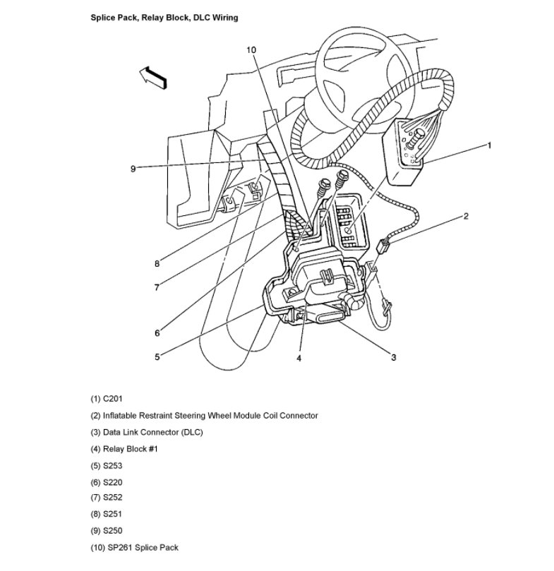

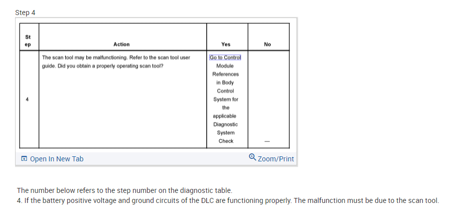

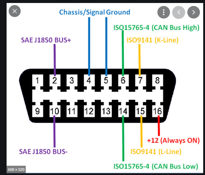

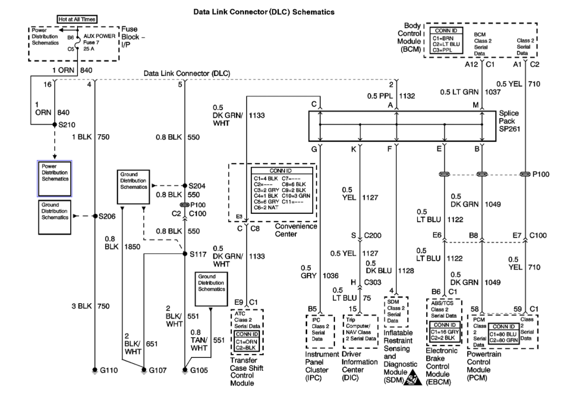

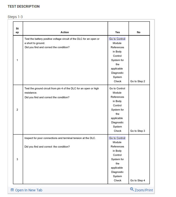

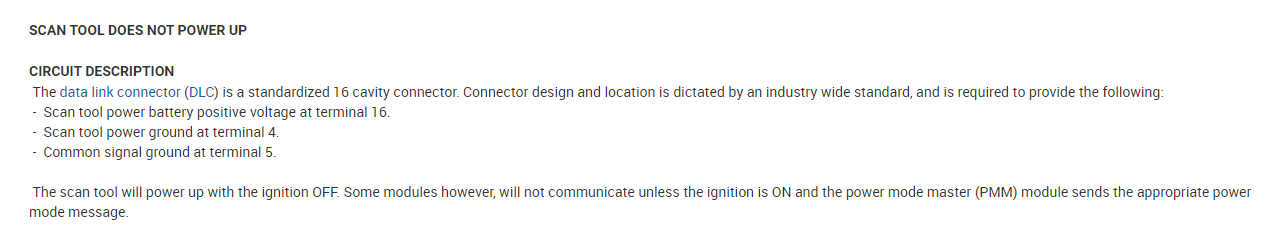

Engine light on, scanner check no power. I check the terminal got ground through system got voltage through system. Used my ohm meter. Battery post 2 port got reading ground 3 ports got reading?
