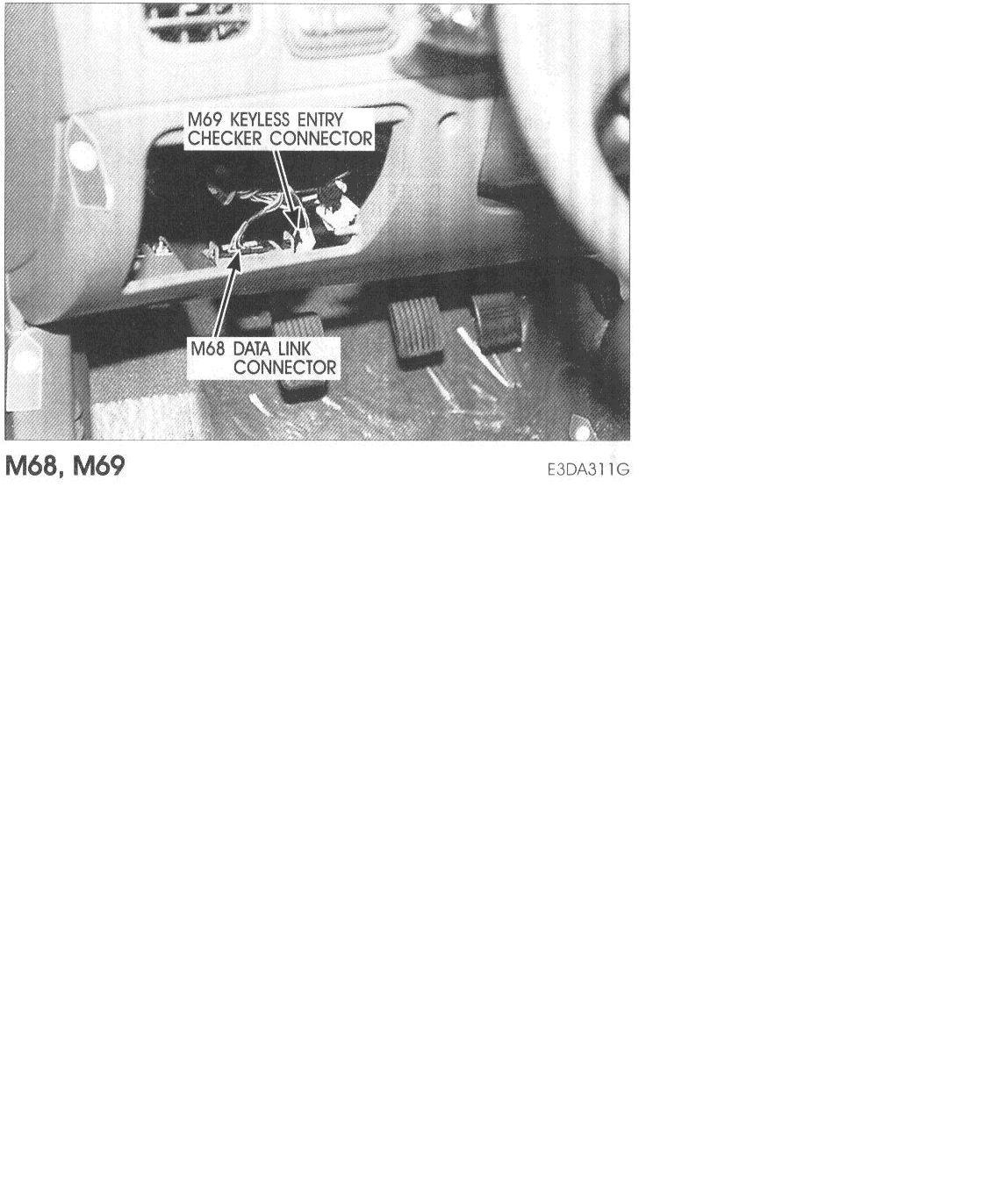

Where is the OBD port located? I looked everywhere and cannot find it!
May 18, 2018 at 7:16 PM
  • 34,306 POSTS
For all 1996 and newer U.S. models, it is standardized and it is supposed to be near or right under the steering column. Looks like they tried to hide it from you, but we are smarter than the engineers! Here is the picture showing its location.

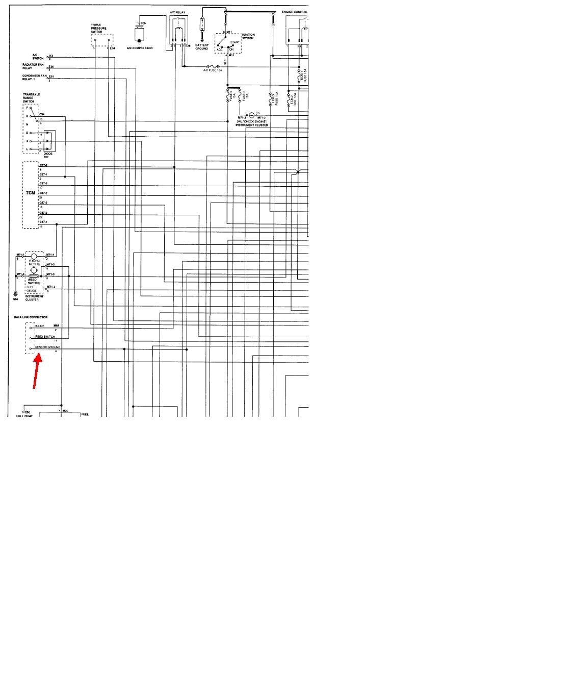

Mine looks nothing like the picture. I have searched the whole area and cannot find it. Does it even have a OBD port?

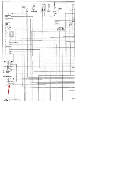

So, you are going to make this difficult! :-) Here is part of a circuit drawing I stumbled upon that shows the Data Link Connector, but there are things shown here that are under the hood, inside the car, and at the rear. There is no connectors shown so there is no way to know where things are unless you just know.
What I can add is I have read on occasion of people finding these connectors near the center console, and even under the hood yet on some early 1996 models. Be aware these are supposed to be easily available in case they are used for emissions testing in some areas of the country. Test operators will not put up with having to disassemble a customer's car to perform the required tests.
A visit to the dealership might be in order, but first I would peek under the driver's seat, and I would look if the glove box can be unsnapped to let it hang down, then look behind and above the opening. Also, look for a plastic panel that can be snapped off the front of the center console, on either side, right about beside your foot. That is a common place to find other diagnostic connectors for the Airbag Computer and Anti-Lock Brake Computer.

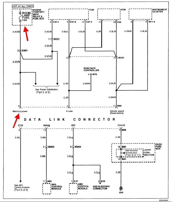

Okay, I finally found the OBD port. Plugged it in turned the key and nothing. It did not come on. Any ideas what is going on? Is there a fuse or something I should check? Thank you!

Boy, that last diagram was pretty much useless. Sorry about that.
Where did you find the plug?

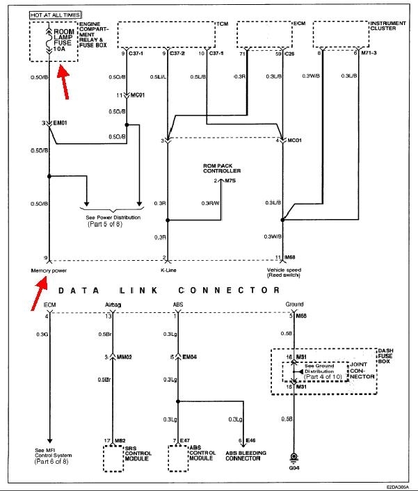

I found this diagram of the Data Link wiring. It shows power to the plug comes from the interior lights fuse, a 10-amp, in the under-hood fuse box. That feeds the transmission computer too, so if it is blown, you should be having shifting problems.

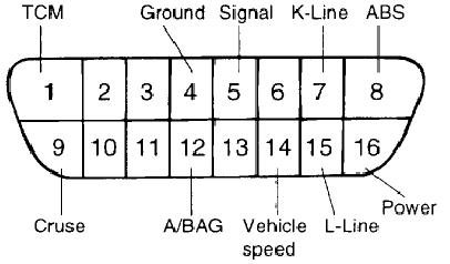

There are two other things to consider. The first is the ground circuit, terminal #5. Check that one for continuity to ground. The second is while these terminals were supposed to be standardized among all car brands and models, there were some terminals left open for use as seen fit by the manufacturers, and there have been some cases where they did not follow the standard. To add to the confusion, I found the diagram showing the connector terminals, and this one lists the ground as terminal #4, not #5. In the first diagram, terminal #9 is shown as the power terminal, and in the second drawing, terminal 16 is the power terminal. Check both of them for twelve volts.
