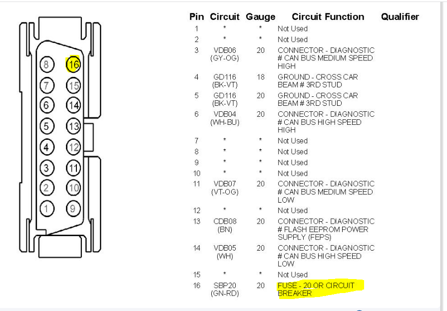

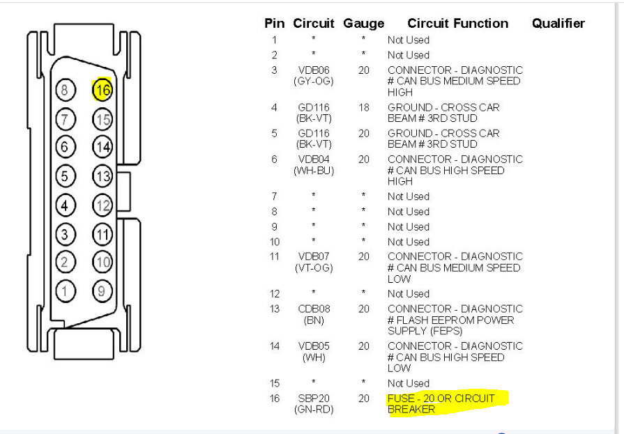

Check pin 16 in the data link connector for power. It should have 12v at all times. See pic 1 below.

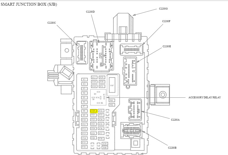

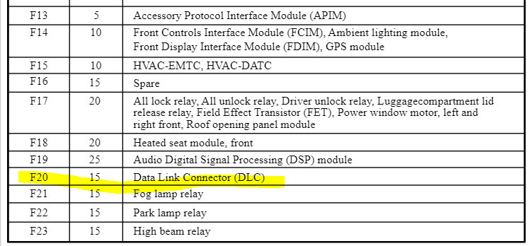

If there is no power, locate fuse 20 in the smart junction box inside the vehicle. Check that fuse. Also, confirm there is power to and from it.
I attached pics below to help locate the items I mentioned.
