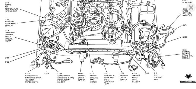

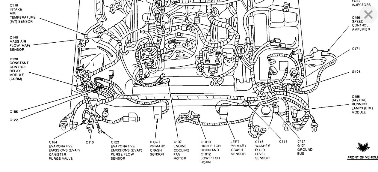

The code is for the EVAP system purge flow.
The most common issue is the purge valve. I attached a description and a flow chart for the code.
The Evaporative Emission Purge Flow Sensor is located at the lower RF of vehicle, behind headlamps.
HW: Evaporative Emission (EVAP) - Purge Flow System
