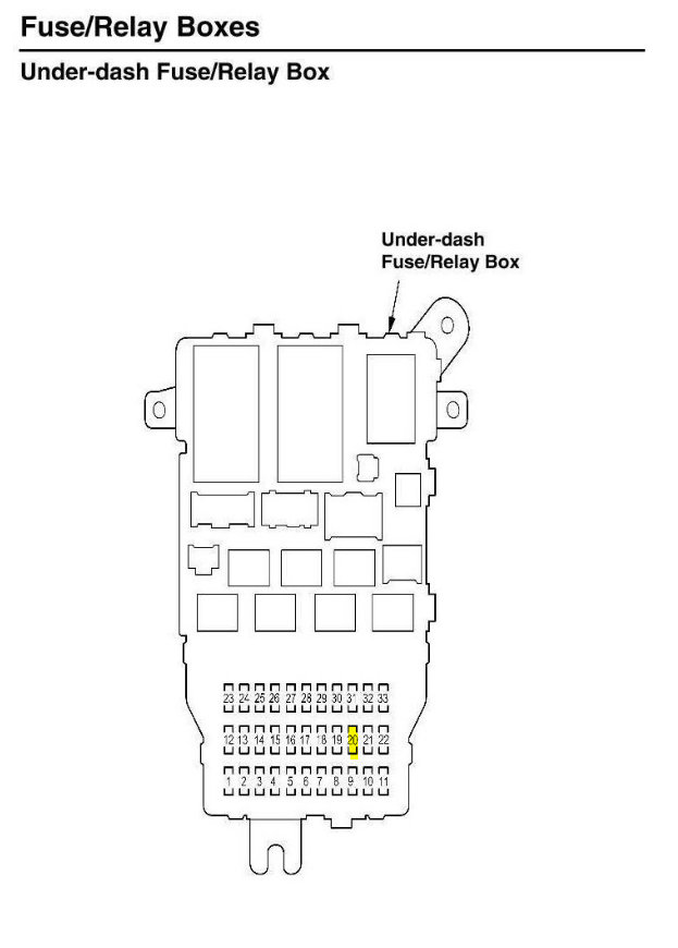

My OBD-11 PORT is out and I was wondering which fuse to check.
Similarly, your YouTube video on the Honda mine not only has an issue with the OBD-II, but with power locks, radio and power tailgate as well.
I believe I likely blew the fuse incorrectly using a memory saver when changing my battery.
Thanks so much for your help!
May 12, 2022 at 10:58 AM
SQM
  • 6,383 POSTS

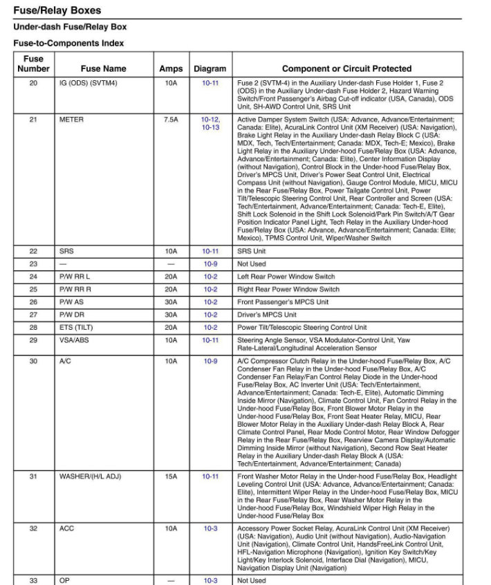

Check the number 20 fuse located in the fuse box under the dash. That should be for the OBD port power. It is a 10A fuse.
See diagram below for reference.
Let me know of any questions.
Thank you.
May 12, 2022 at 12:10 PM
AARON KESSLER
Thank you! Everything is back in working order. It wasn't fuse 20, but another 10-amp fuse close by.
