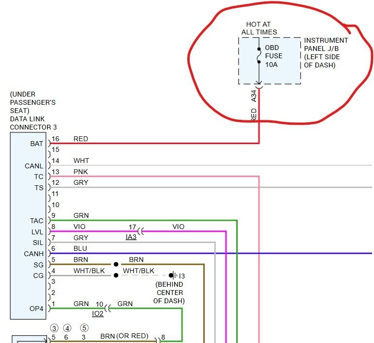

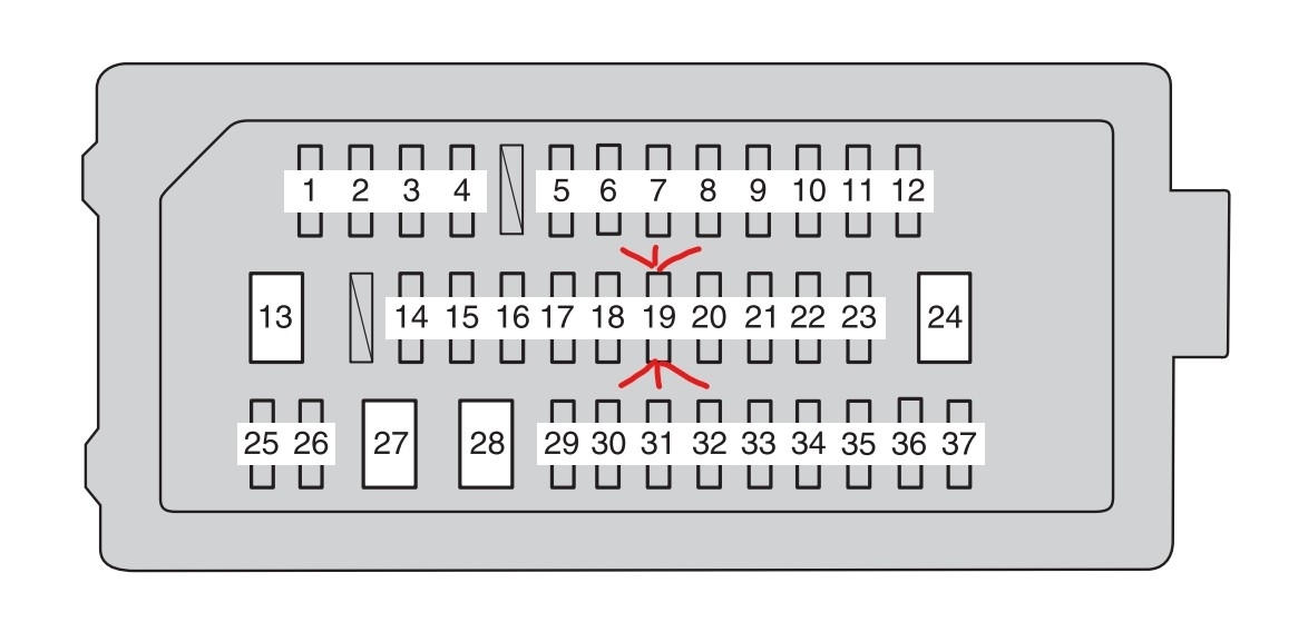

You don't need a break out box, just check that pin 16 actually has a pin in it and that it's a red wire. If it's there the wire runs from the fuse box to the port, nothing else on it. Use a test light to verify that the fuse is actually getting power. The fuse could be perfect but with no power in the fuse box to it. If a test light lights up on it then it's just the red wire that is bad, you could simply run a fuse tap with a new wire to the port and be in business.
