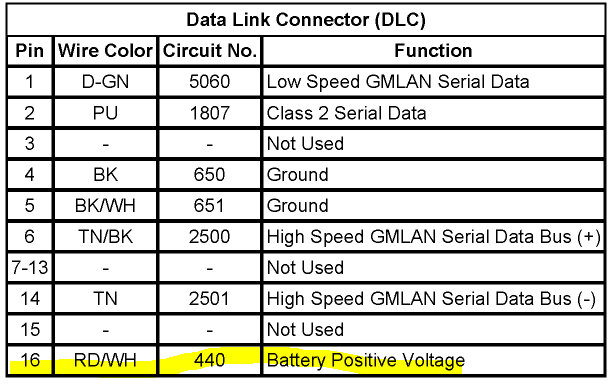

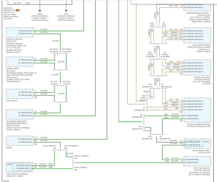

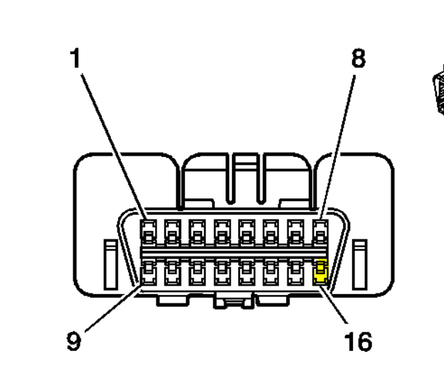

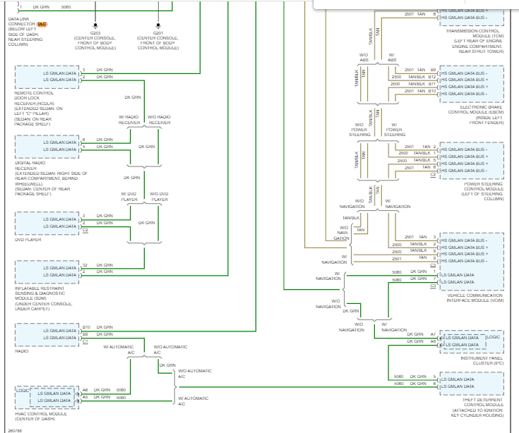

Pin 16 in the data link connector should have battery voltage at all times. See pics 1 and 2 below. I also attached the computer data lines schematics. (pics 3 and 4) I had to cut the pic in half to make it readable.

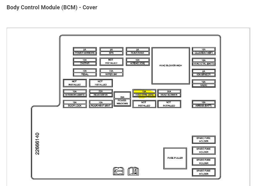

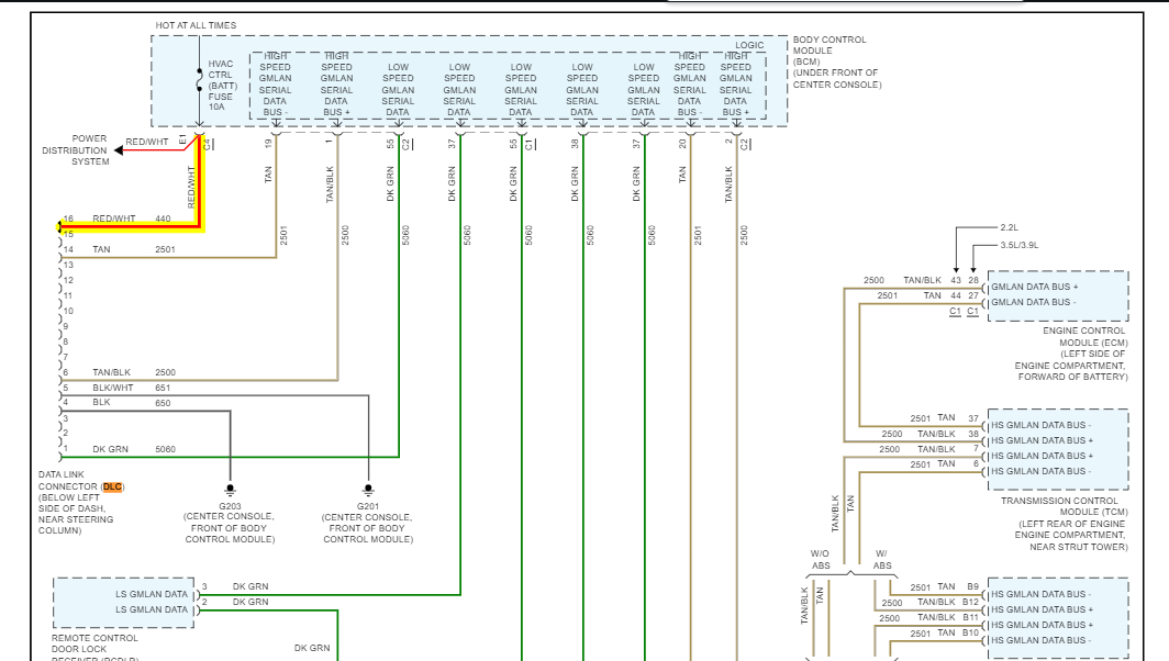

As far as the power supply is concerned, it comes from a fuse under the dash/body control module. See pic 5 for the fuse location. When you check the fuse, confirm there is power to and from it.

See pics below.
