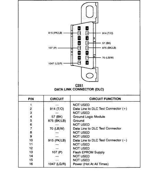

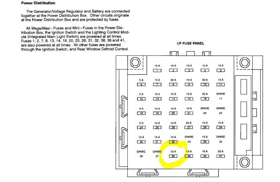

Smog check failed due to no communization between OBD and their computer. They said could be fuse, but owners manual fuse diagram does not show which fuse to check.

The fuse numbered 38 in your car is for the data link connector. Check the fuse for power on both sides.
Check port 16 in the diagram for power with the key on.
