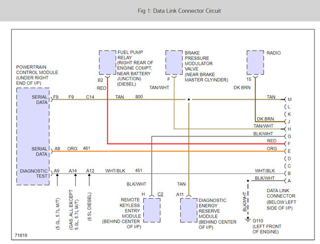

How can you flash the OBD without a reader? I understand that a jumper from A to H should generate a flash sequence to ID the code related to the ABS. I get nothing: key on, off, jumper in before tuning key to on, jumper install after key is on, all the above with the engine running or all the above with a start of the engine. Do you need to jump A to B to enter diagnostic mode and if so does that jumper need to remain in place while conecting to the H pin to read the ABS codes?

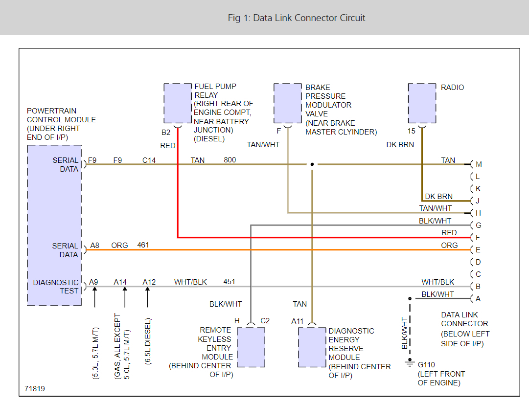

Here is the ALDL connector wiring diagrams so you can see how the connector works.

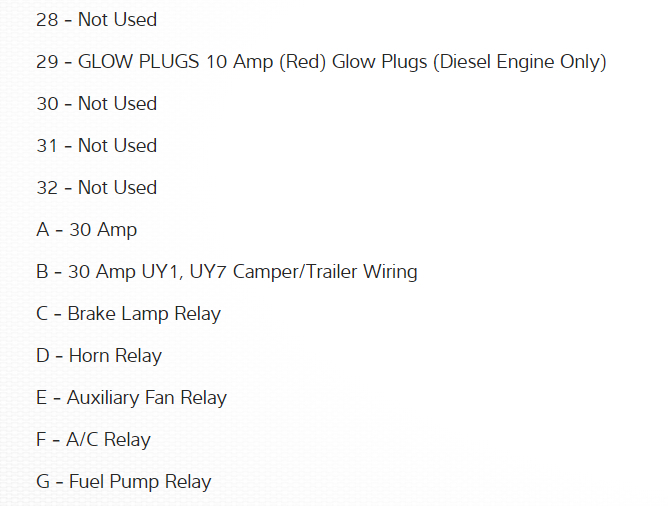

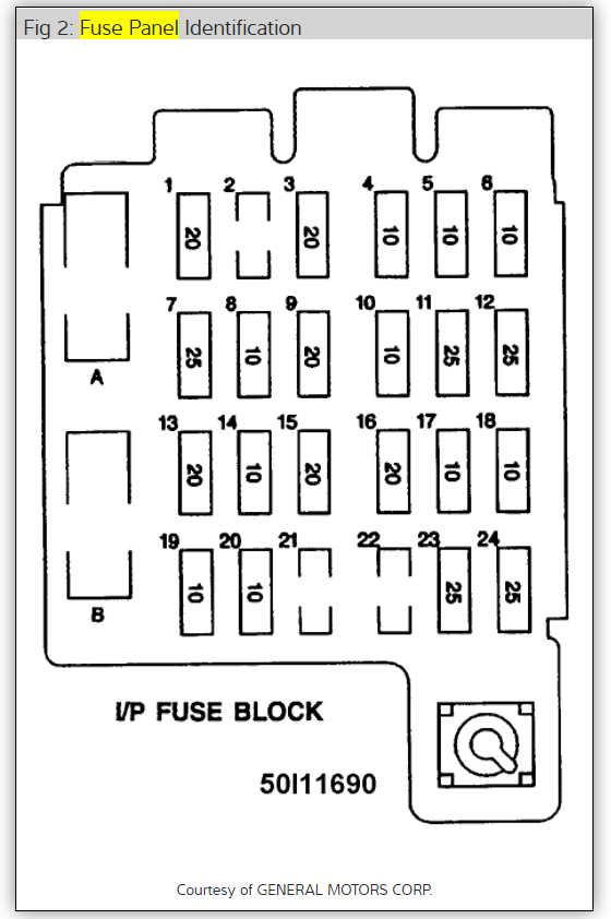

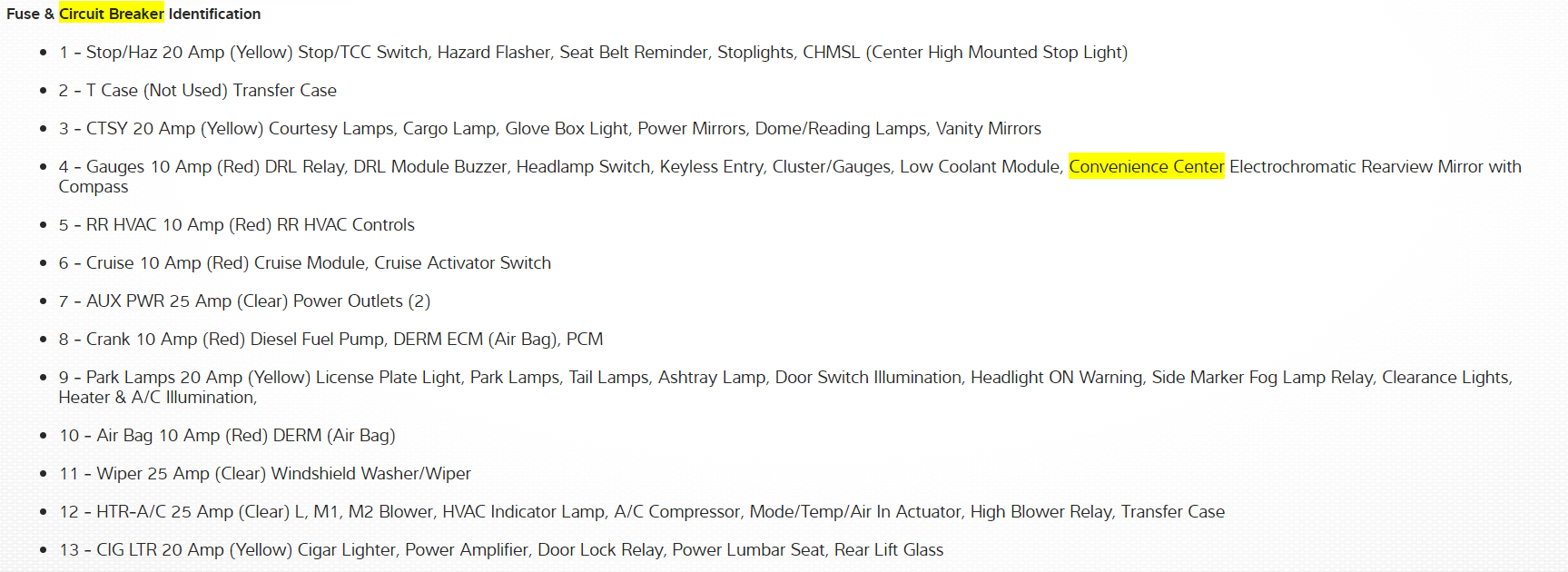

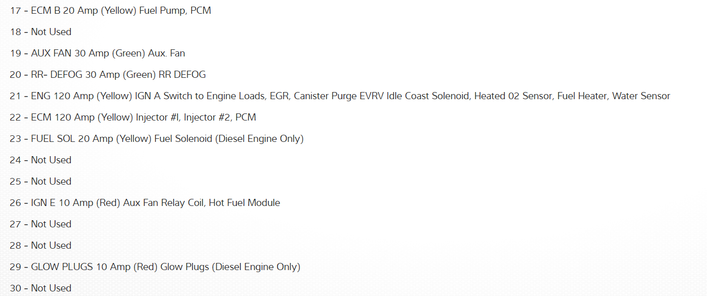

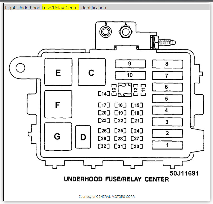

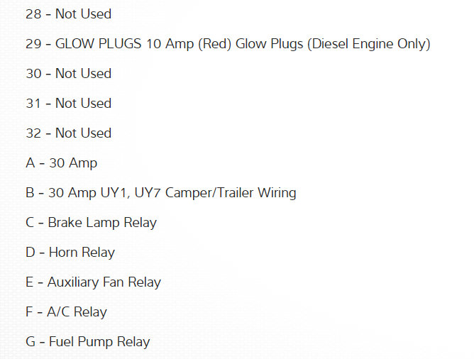

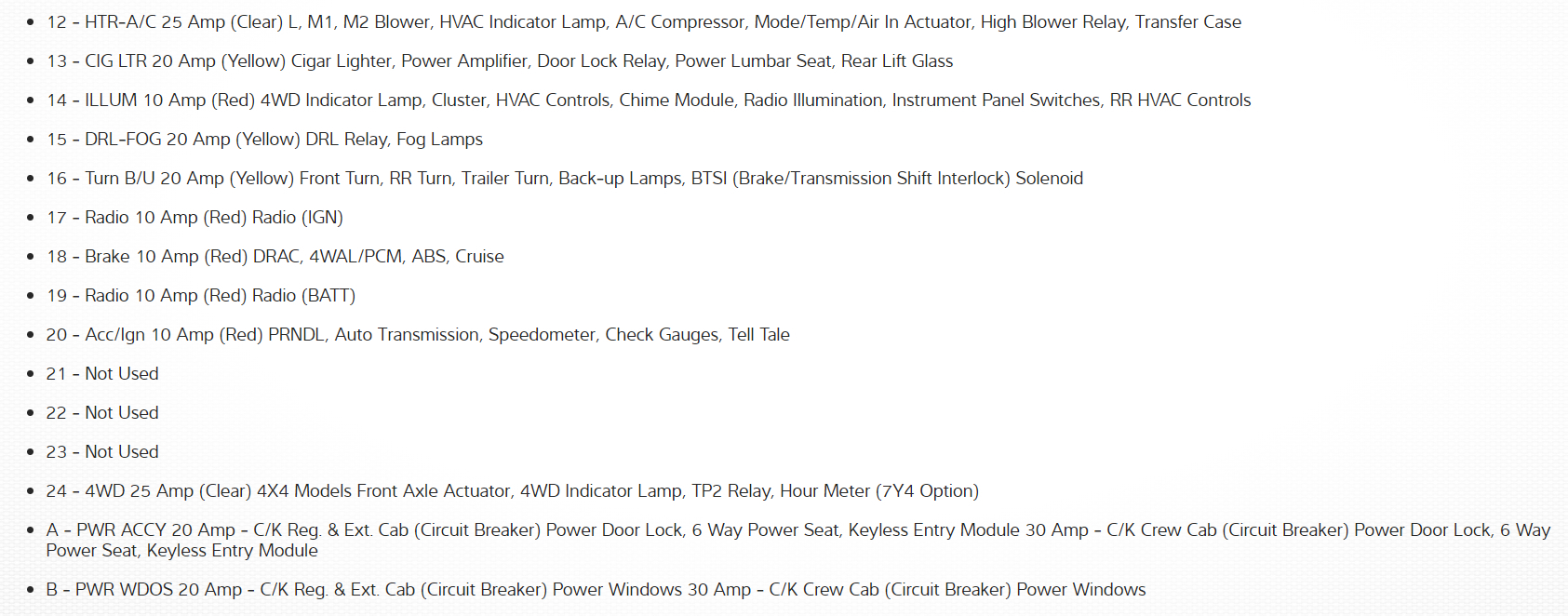

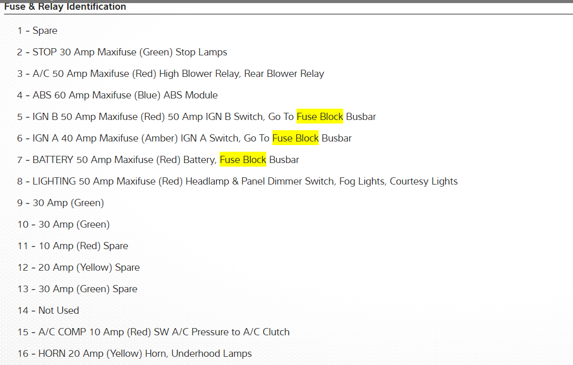

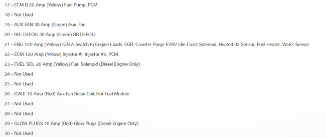

Also, check all fuses.
Check out the diagrams (below).
Please run this test and get back to us.
