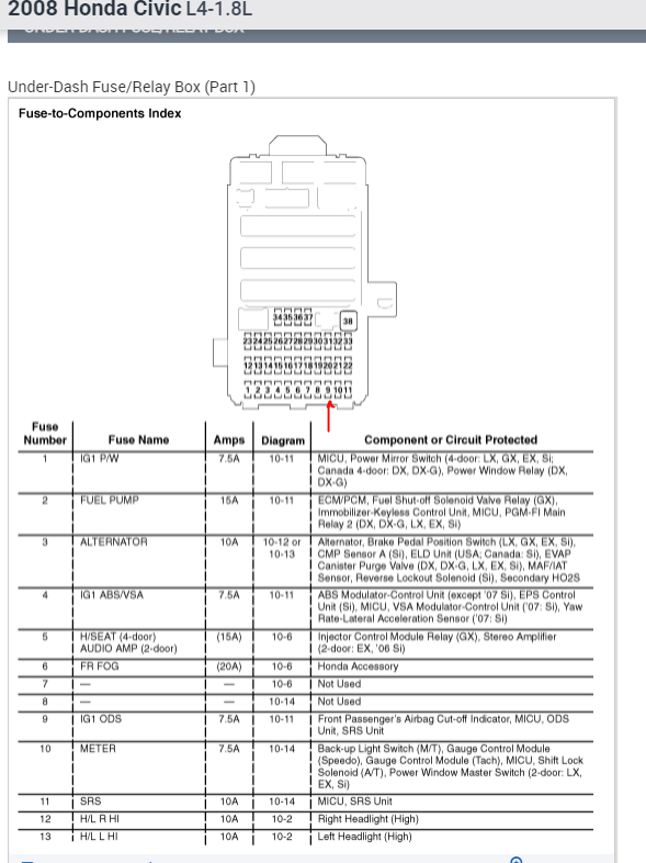

Checked the fuse. It’s not blown but I tried replacing it anyway and it’s still doing the same thing.
