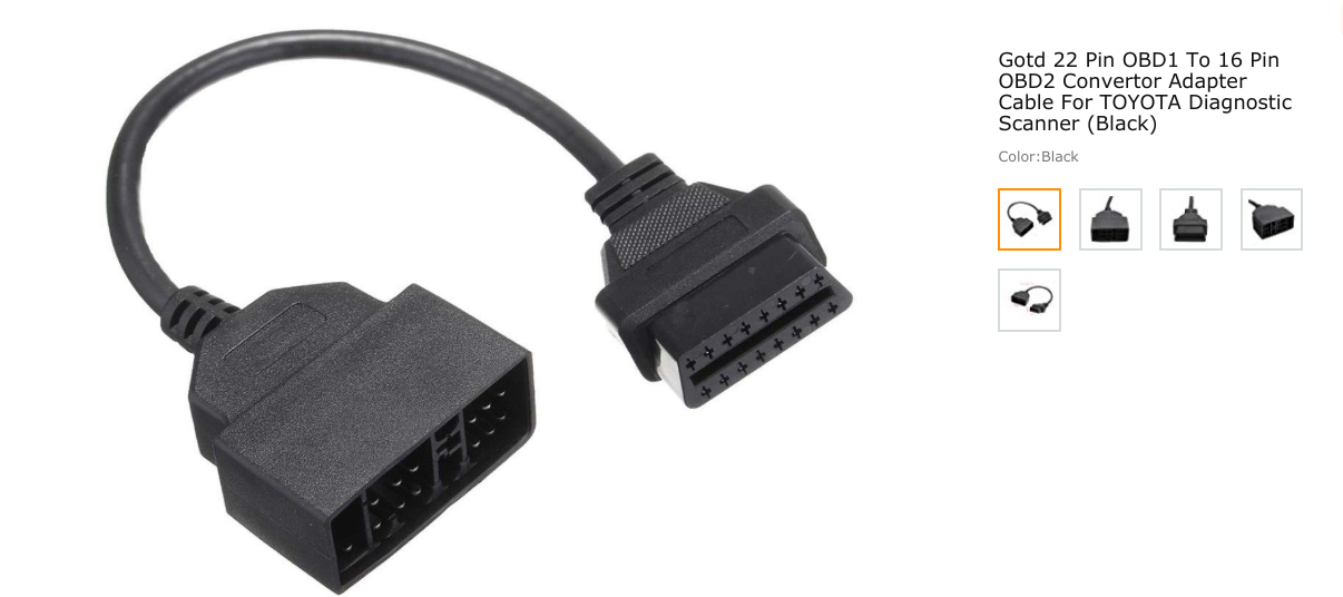

Can I purchase a 22 pin to 16 pin connector for my Foxwell nt 530 scanner for the same function detection as you have highlight in observing the no.of light flashing to get this code? Please kindly advise.thank you

There is adapter you can buy for your scan tool. I'm attaching information below from ebay. It is for your Foxwell NT350.
Let us know if this is helpful and if you need any more info.
Gotd 22 Pin OBD1 To 16 Pin OBD2 Convertor Adapter Cable For TOYOTA Diagnostic Scanner (Black)
by Goodtrade8
4.4 out of 5 stars 5 ratings
Price: $8.70 + $0.99 shipping
Color: Black
The cable has two connectors: one For Toyota 22 Pin connector, another is 16 Pin OBD OBDII connector.
The cable can be used for converting connection from Toyota 22 Pin to OBD OBDII 16 Pin interface
allows you use OBD OBDII diagnostic tools working with your Toyota vehicles with 22 Pin interface.
Package Including: 1x OBD2 Connect Cable
