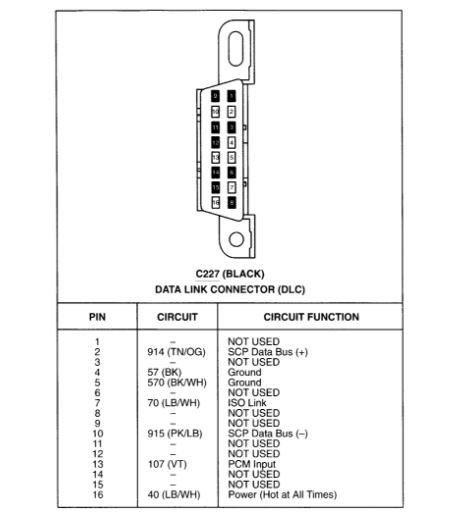

I attached the diagram of the data link connector.
Pin 16 needs power and 4 needs to be grounded.
Pin 2 and 10 are the serial data lines that communicate with the modules. Use an ohmmeter across 2 and 10 and you should have 60 ohms.
https://www.2carpros.com/articles/can-scan-controller-area-network-easy
