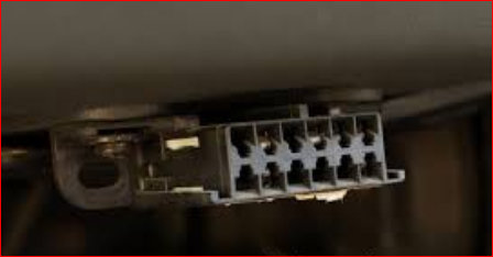

I have attached a picture of what the OBD1 connector looks like. Hope this helps in your search.

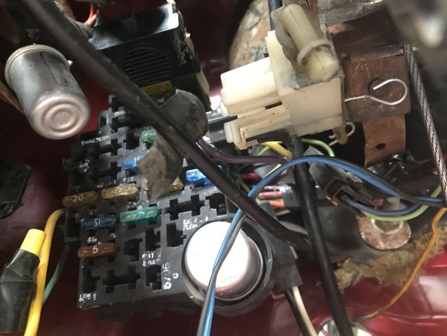

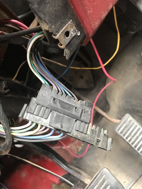

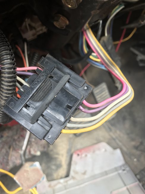

I still cannot find it. Here are some photos of what is there:

You might want to see if they stuck it up somewhere in the middle of the dash?

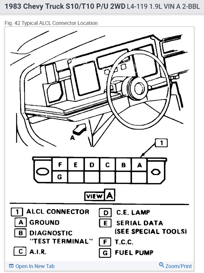

I have found this image for you. Check out the diagrams (below). Please let us know if you need anything else to get the problem fixed.
