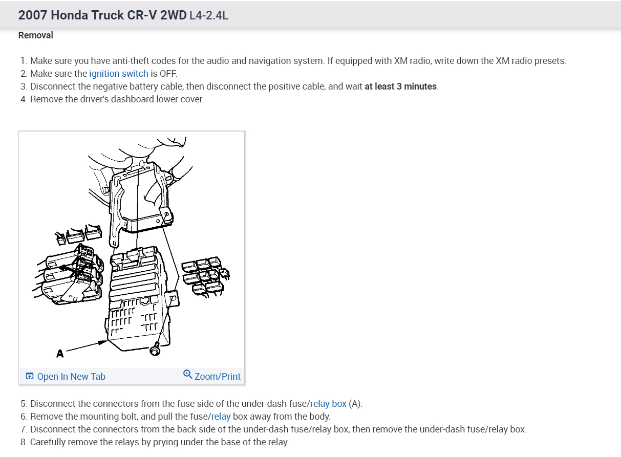

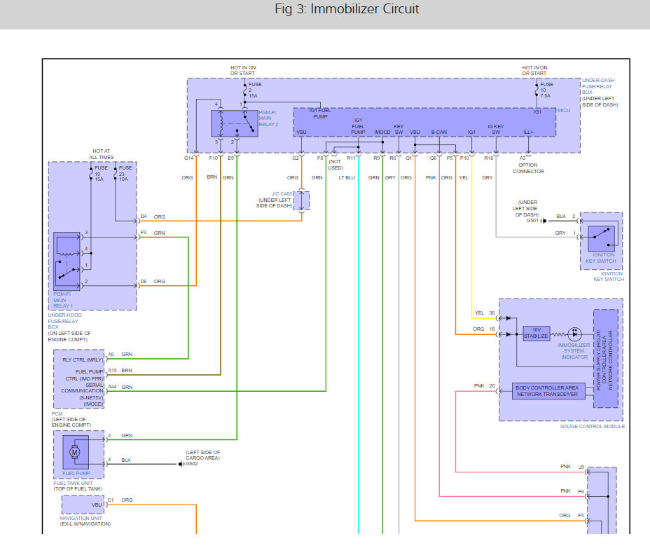

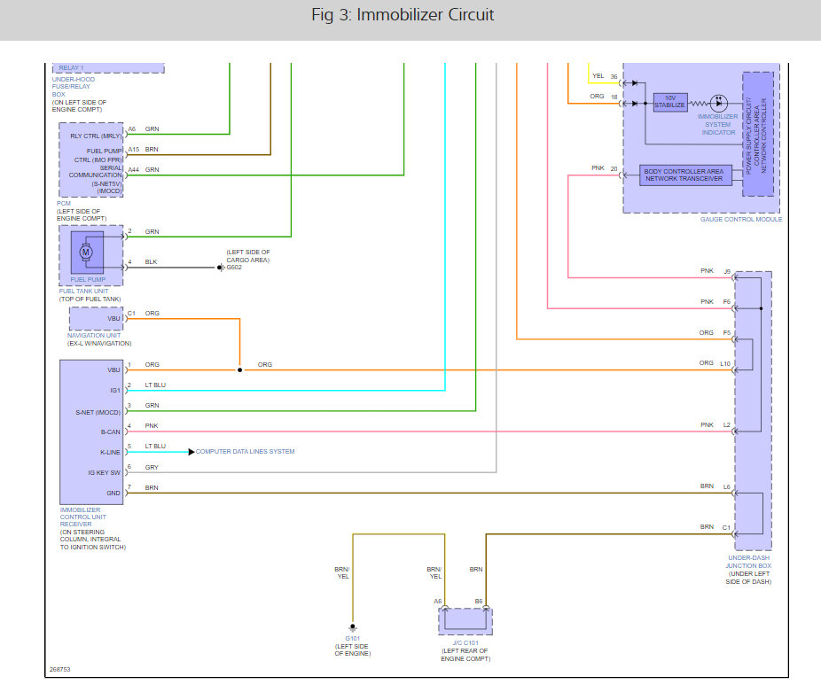

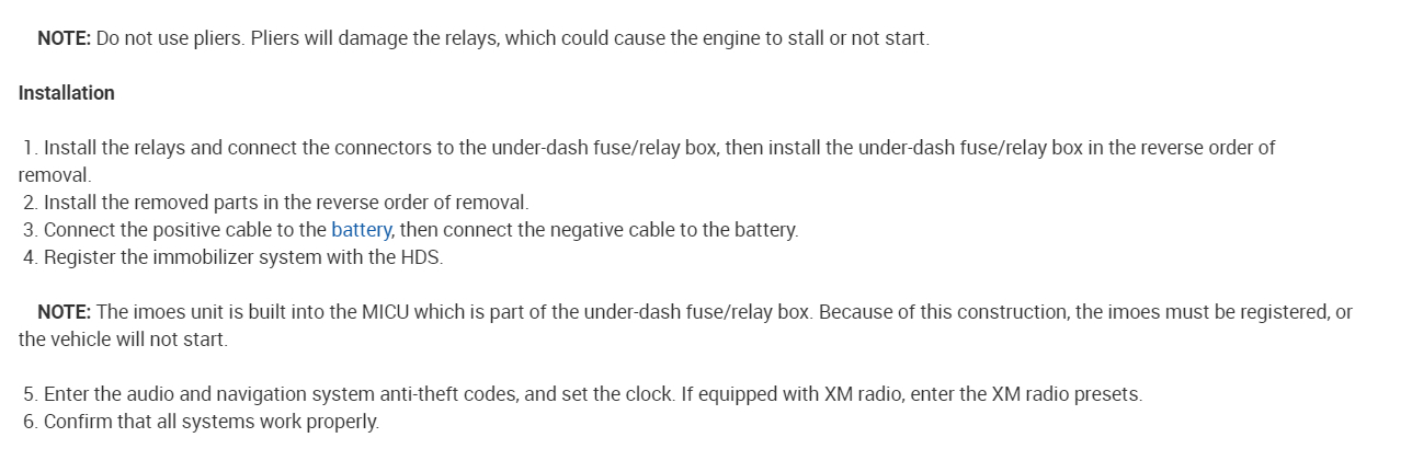

Yep, the cold can cause the electronics to go out. I have seen the MICU go out which is a part of the fuse panel. Here are the wiring diagrams for the immobilizer system so you can see how the system works. There is an outside chance the dash cluster is bad as well, but I am leaning toward the MICU. Here is how to replace the unit so you can see what needs to be done. Check out the images (below). Please let us know what happens.

Good info. I am sourcing Micu How much Shop time will it take to swap and reprogram Key fob.
Feb 1, 2023 at 6:22 AM
Sorry it really does not give specific times for this particular repair, but I can guess about 2 hours @ the shop rates would be a good estimate.
Feb 2, 2023 at 1:44 PM
