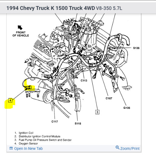

I started this as an O2 sensor question that was answered by Joe. I thought I'd put this out there again to see if anyone has any suggestions.
