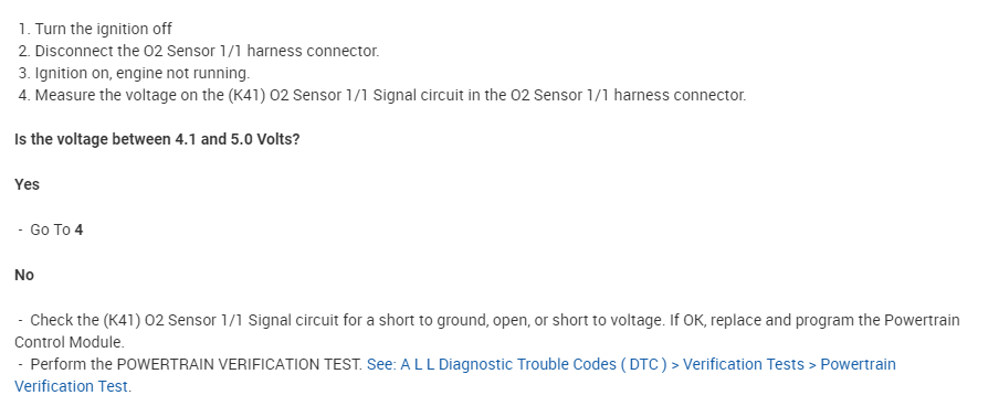

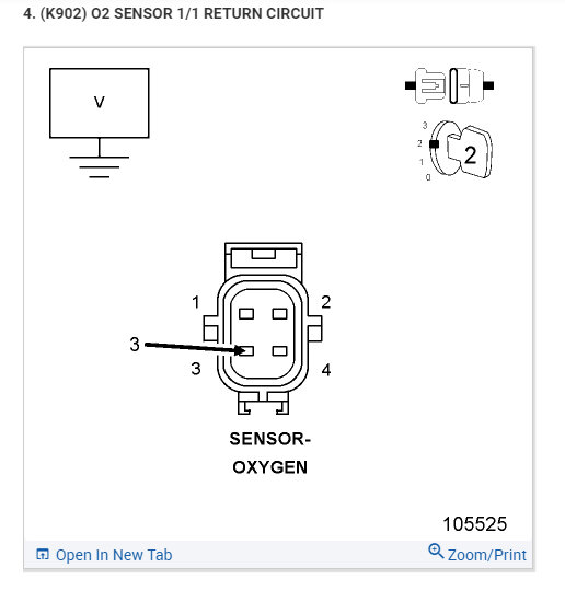

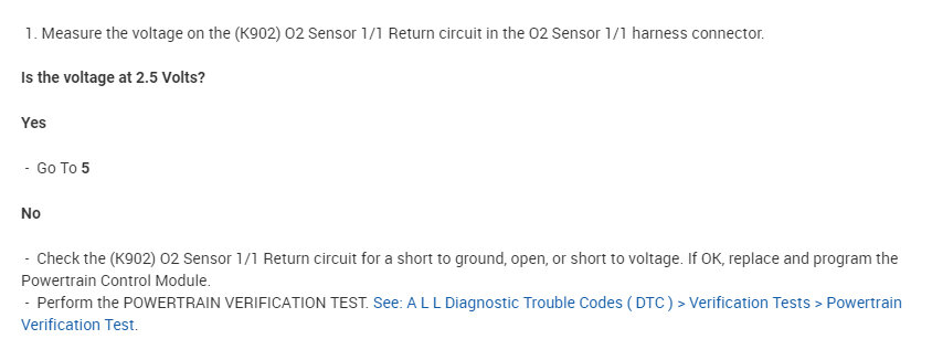

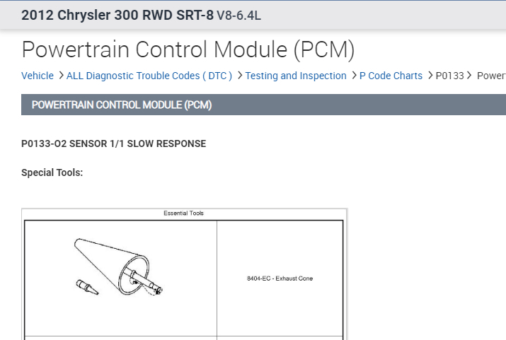

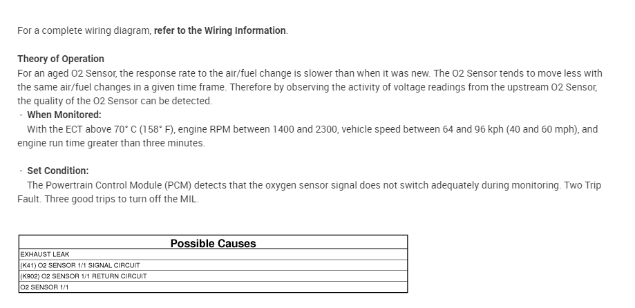

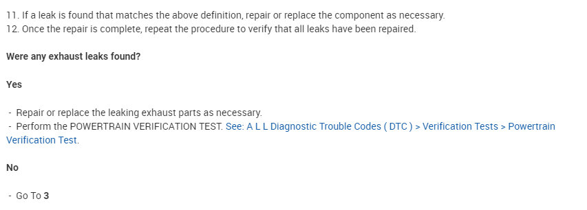

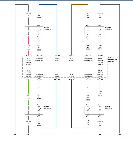

Customer replaced O2 sensors and cat on Bank One.
Still has a p0133 and a p0420 coming up.
At idle STFT's look good.
At 2500RPM , both numbers jump up into the mid 20's.
LTFT both Banks around 11.
Bank 2 O2 sensors numbers look good.
B1S1 O2 very slow to respond.
B1S2 starts at a steady .8 , but then drops to .0135.
I'm stumped at what would cause a good reading 1 minute and not the next.
The dealer said he should replace the bank 2 cat, because it cannot match the flow of the newly installed cat on Bank 1 ... I can't see how replacing the cat on Bank 2 would have anything to do with codes and issues with bank 1.
As much input as I can get would be greatly appreciated.
Thanks in advance.
