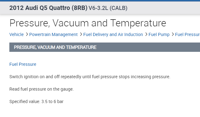

By chance, do you have a live data scan tool? If you do, connect it and allow the engine to reach operating temperature. Check the short-term fuel trims and record them. Next, check the oxygen sensors to see if there are changing back and forth in voltage. The voltage should be between 0 and 1.0v. Let me know how they respond when you press the throttle.
Last, the idea that you have a rich fuel mixture on both banks could simply be the result of a faulty fuel pressure regulator. Has that been checked? If not, here is a link that explains how to check fuel pressure. You will need a gauge, but most parts stores will lend one to you.
I attached the manufacturer's fuel pressure specifications below for you.
Let me know what you find.
joe
See pic below.
