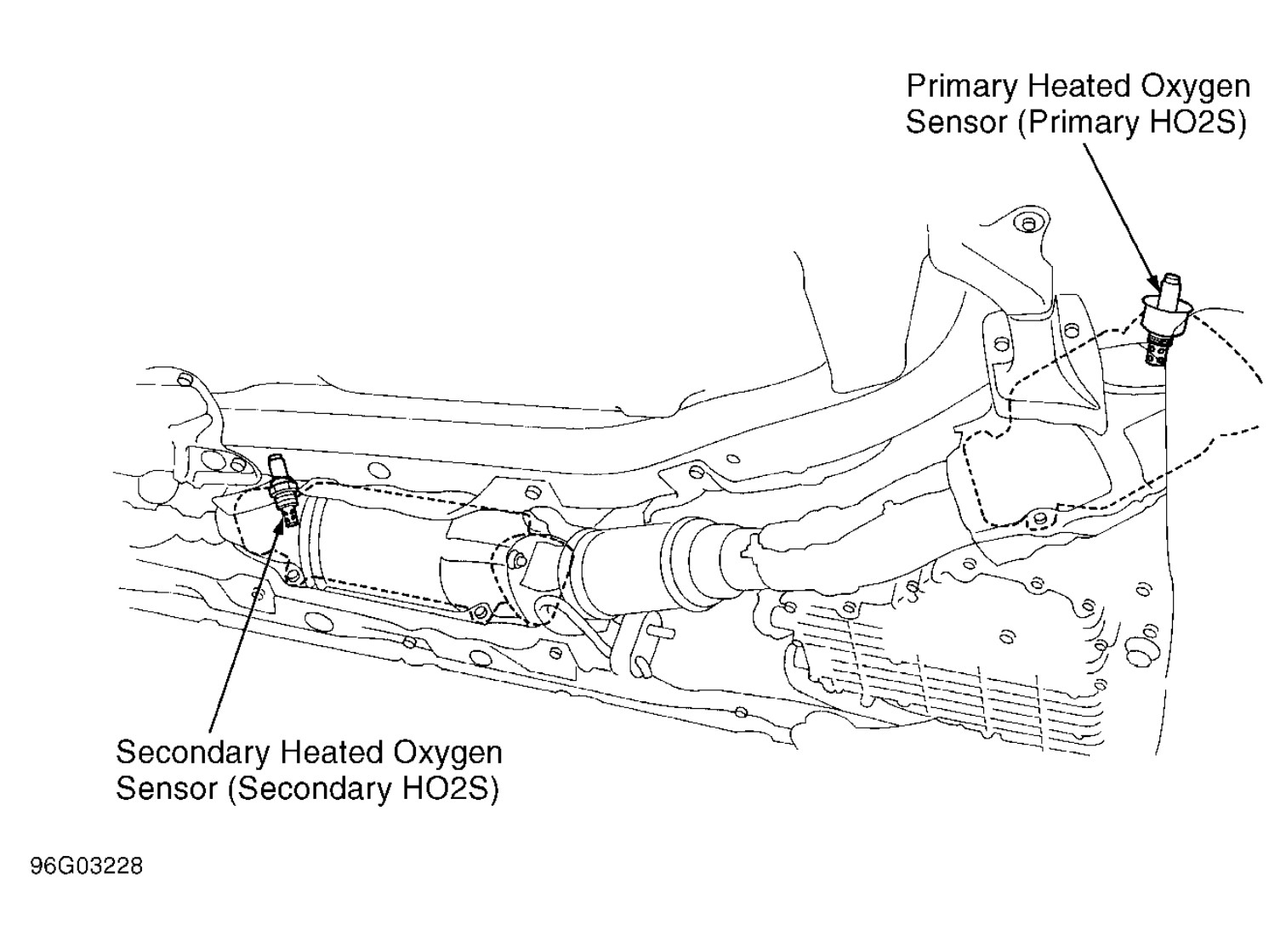

Where are the O2 sensors located?
1996 ACURA TL
150,000 MILES
EVAPIERCE
  • 4 POSTS
Need to know their location s it's a 2.5.
I would love a diagram, please.
Feb 26, 2023 at 4:02 AM
BRENDON S
  • 653 POSTS

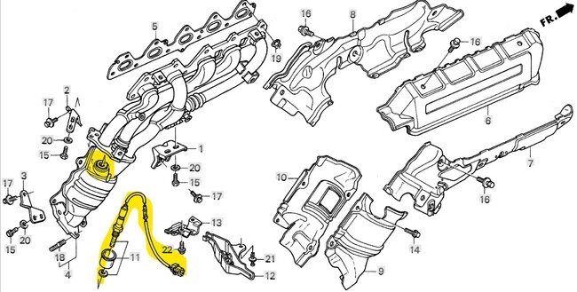

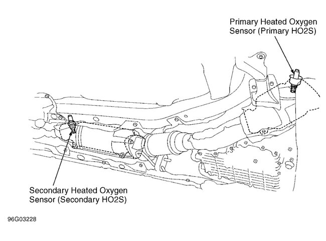

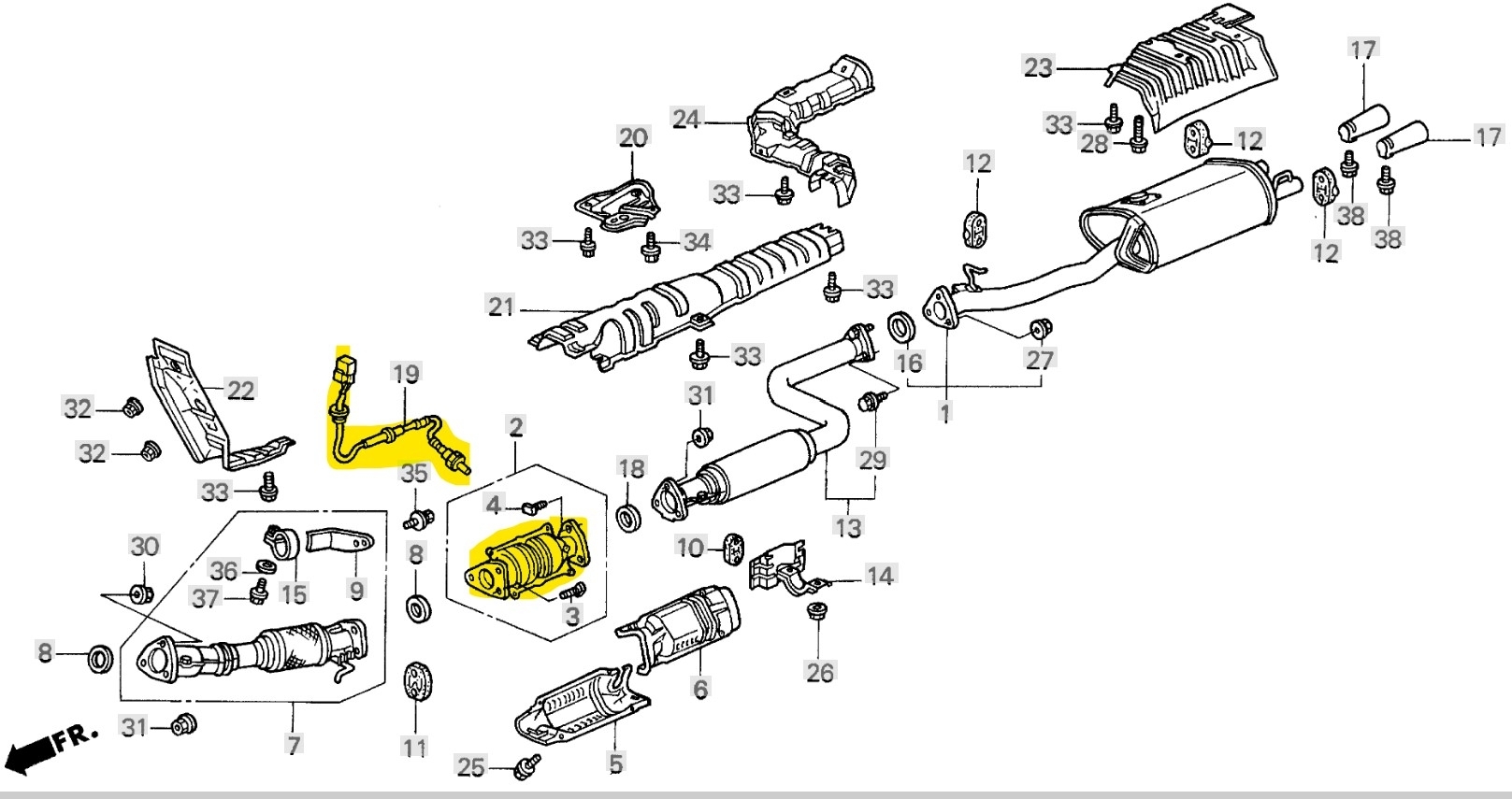

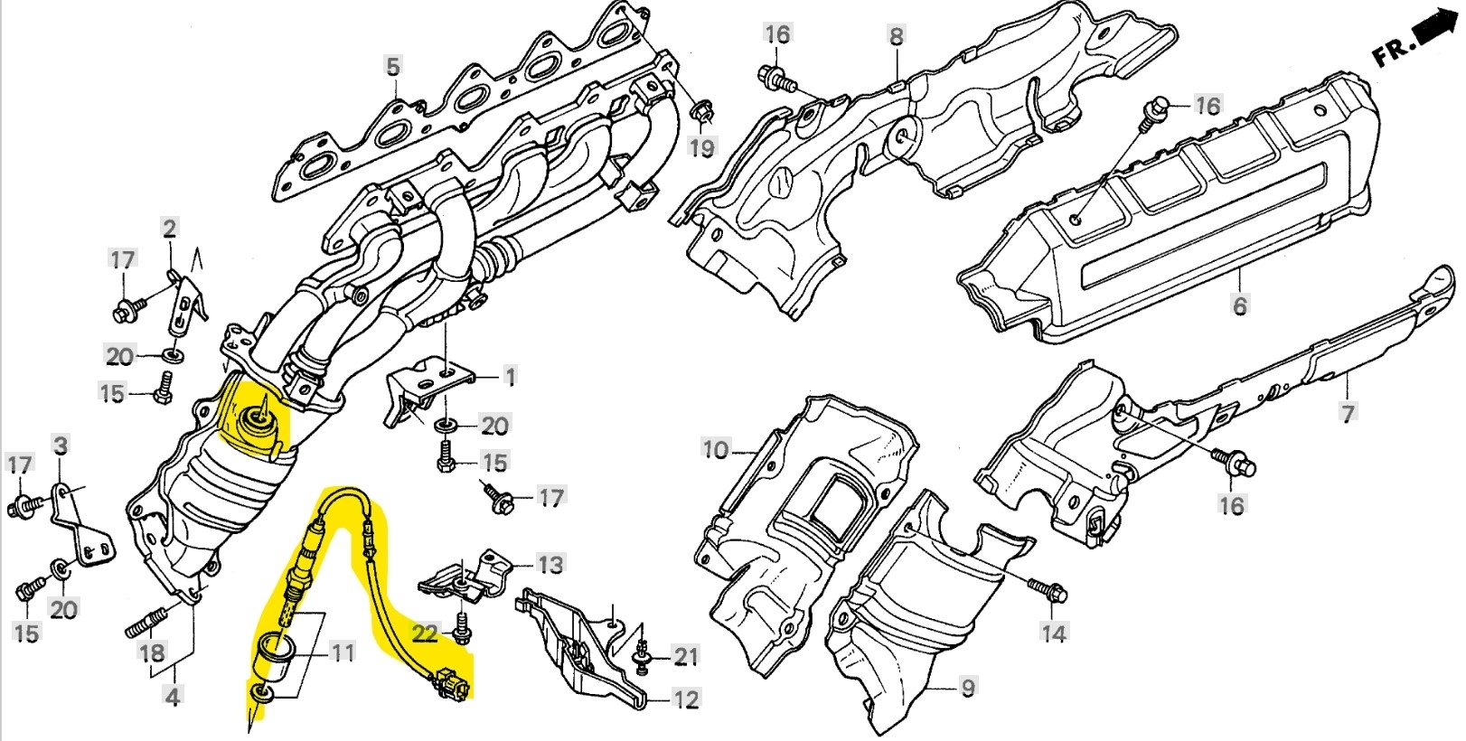

Good morning, EVAPIERCE,
I have added a few diagrams for the primary and secondary O2.
Just reply back if you have any more questions.

Which one is the downstream?
Feb 26, 2023 at 6:50 AM
EVAPIERCE
  • 4 POSTS
On the O2 sensors is the upper sensor the downstream???
Feb 26, 2023 at 6:52 AM
BRENDON S
  • 653 POSTS
Downstream would be the one furthest down the pipe. After the catalytic converter. It is only there to measure whether or not the catalytic converter is performing the way it should be.
The upper is the upstream. So should be one on the manifold this is your upstream. Downstream is after the catalytic converter.
