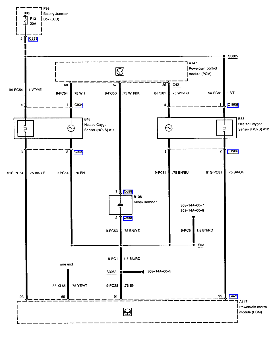

P0135 - O2 Heater control circuit malfunction B1S1
99% of the time this is not the sensor but the wiring going to it, either corrosion or broken wires. It is the twelve volt side of the system that runs the heaters in the sensors.
First check that you have battery voltage at both sides of fuse 13 in the under hood fuse/relay box. That voltage should also be found on the B1S1 O2 sensor connector on the violet wire with a yellow stripe. It also should be on the B1S2 O2 sensor on the violet wire as they are connected. A simple test light would show that.
Next the black wire with yellow stripe is the switched ground for that sensor. It switches "on" when you make a cold start or if you toggle it on with a scan tool.
I suggest looking the wiring over from the sensor to the PCM. look for breaks or bare areas. Tug on the wires in the connectors.
